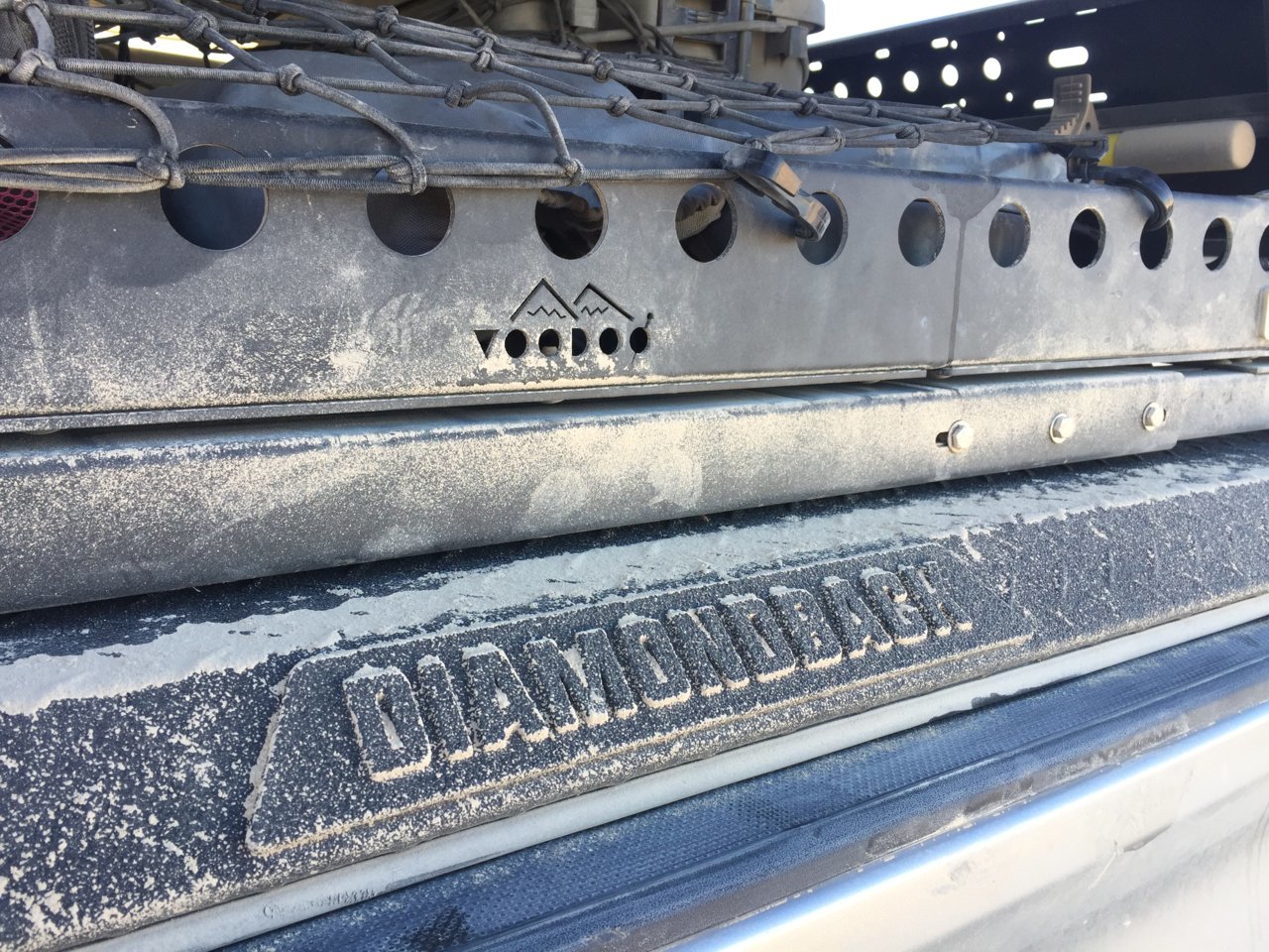

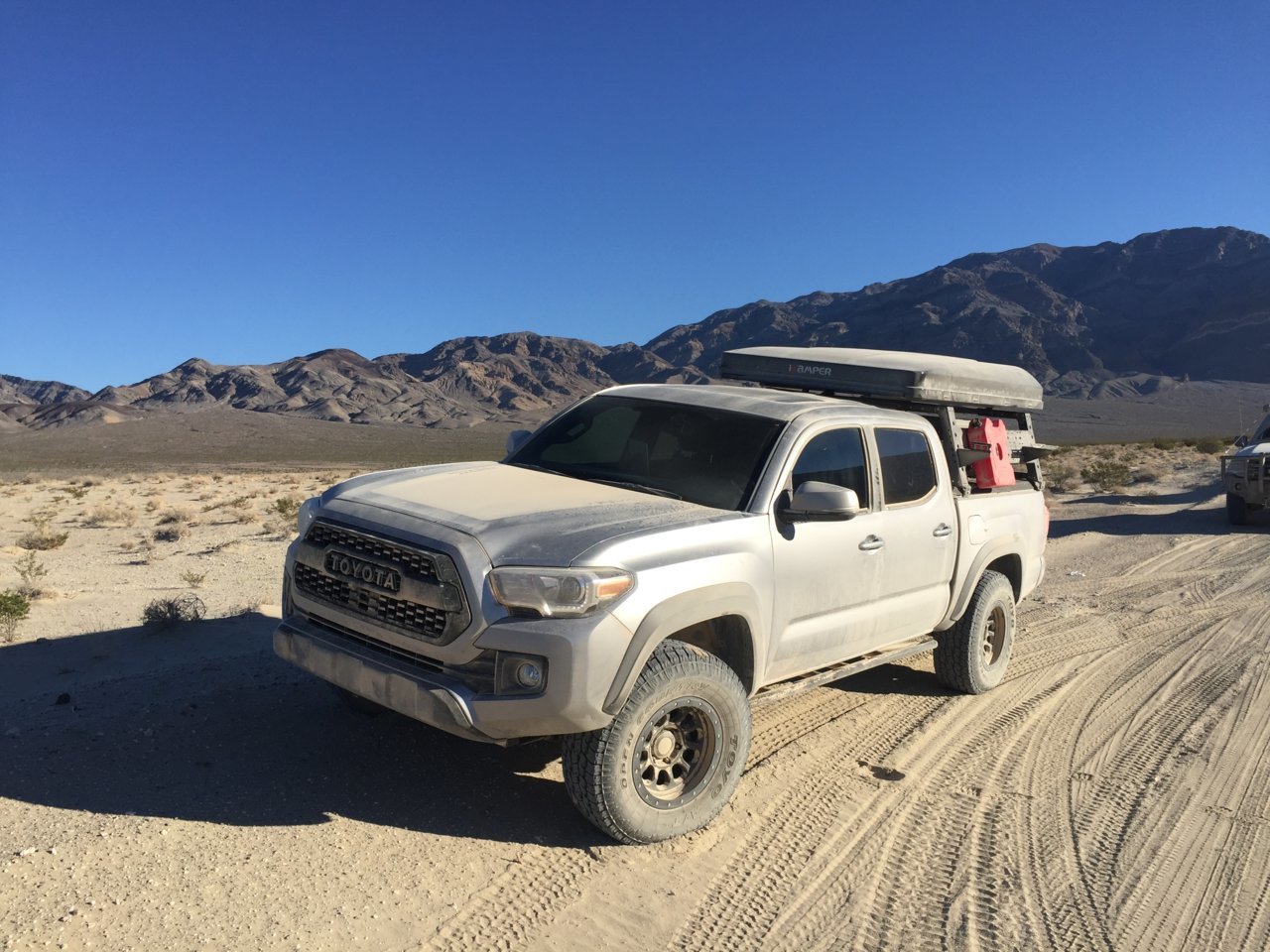

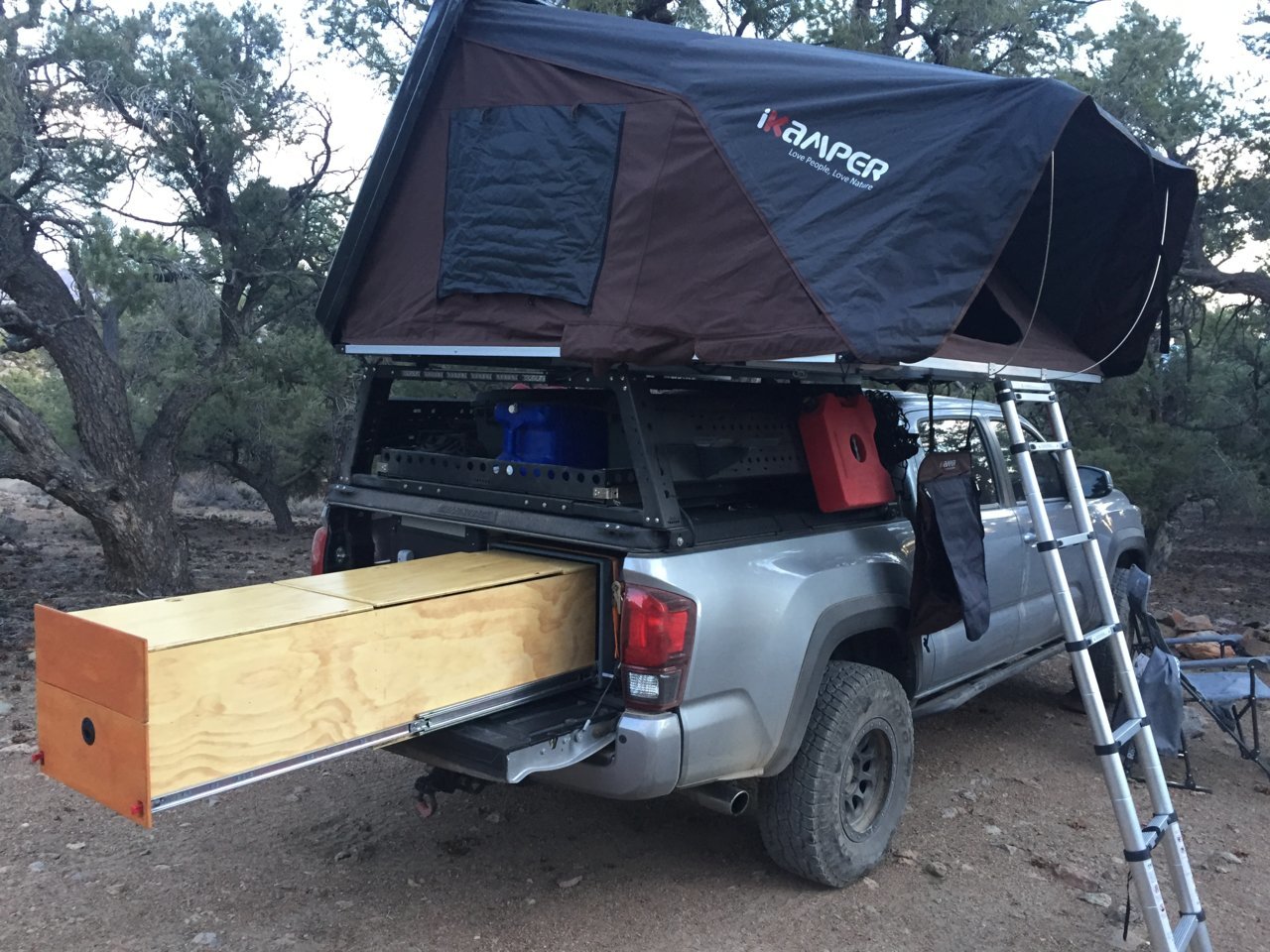

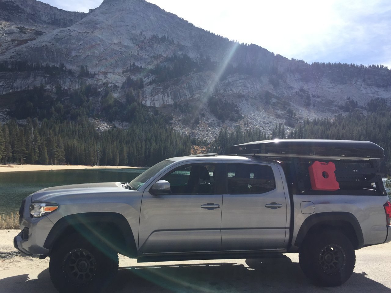

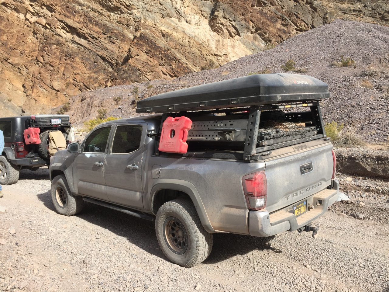

    My rack did really well during my 6 day trip through a Death Valley. I hit washboard and dirt roads up to 50mph. I did go around halfway through and tighten bolts as everything was shaking a ton. Because the Diamondback cover is taller I added tough rubber pads under the legs so they wouldn’t rub too much on the top, and it worked well as they were worn by the end. The chase light bar worked really well and the amber lights cut through the dust. I need to lift up the tent another 1/2” as it did hit the shark fin a little on steep maneuvers, no damage just annoying while hauling down the trail. The cargo tray worked great and gave me plenty of storage space and access. All in all, great trip, great rack.
    9CC133B7-8EB9-401A-8948-E5F2770057EA.jpg 4D2B358A-36C3-46CF-8E61-B0EE5F7C2C75.jpg 68DA7A9A-F740-4BC9-89FC-18938FBE4936.jpg BD4F07BB-102B-4DC3-BCA4-96593115CB3E.jpg 5CD3FB46-C71B-48A1-A1A9-22599AD0F92B.jpg 6DFEE1C0-2D55-441F-8DB3-DBAD095F82F8.jpg 6EF6F3B9-D4DB-4775-85B5-0EF053B3A113.jpg DA0CC39D-9DD6-47EA-9293-8C0726133290.jpg B5E96749-07F5-48C5-8032-AD3B47A1AC45.jpg

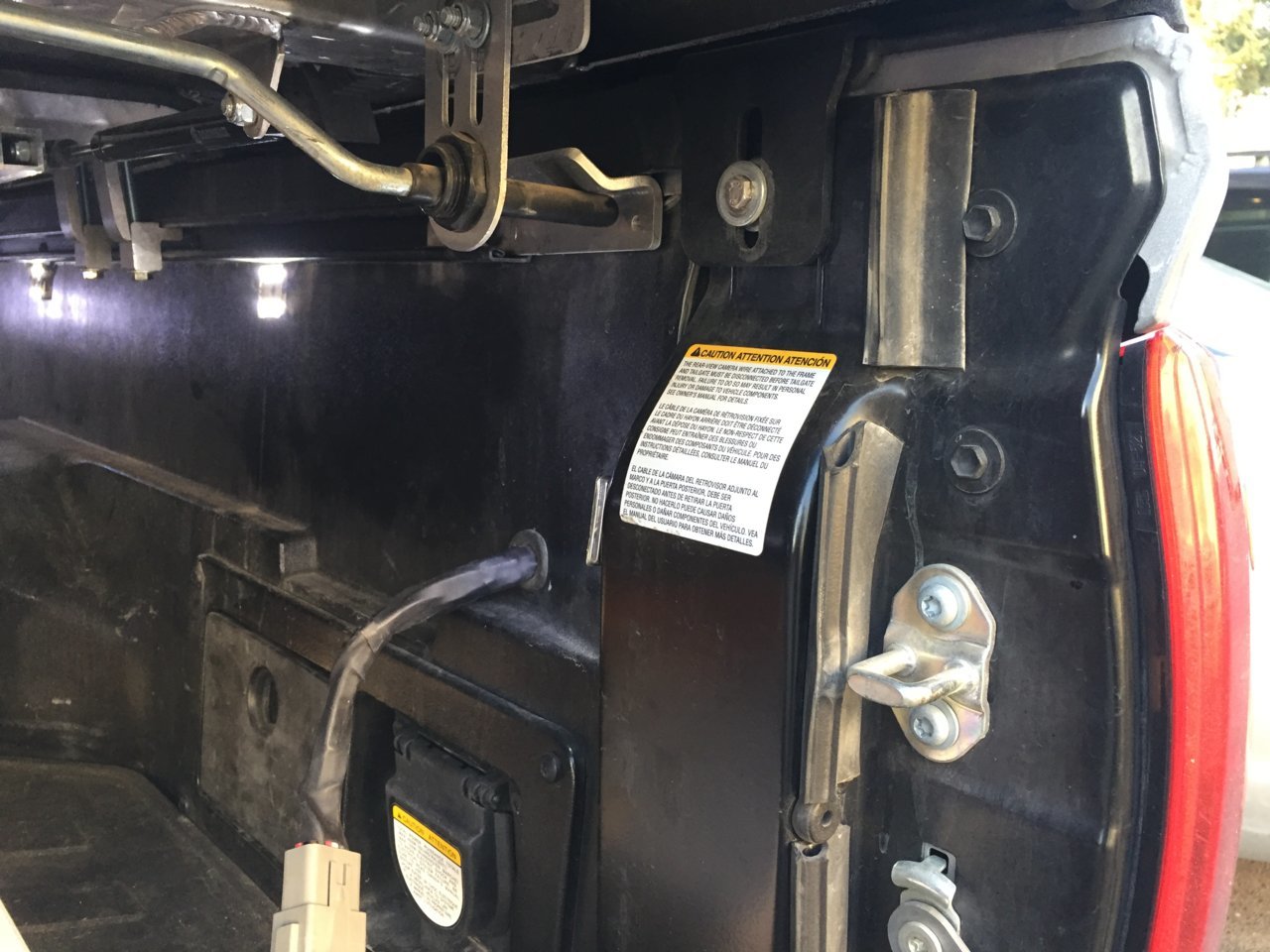

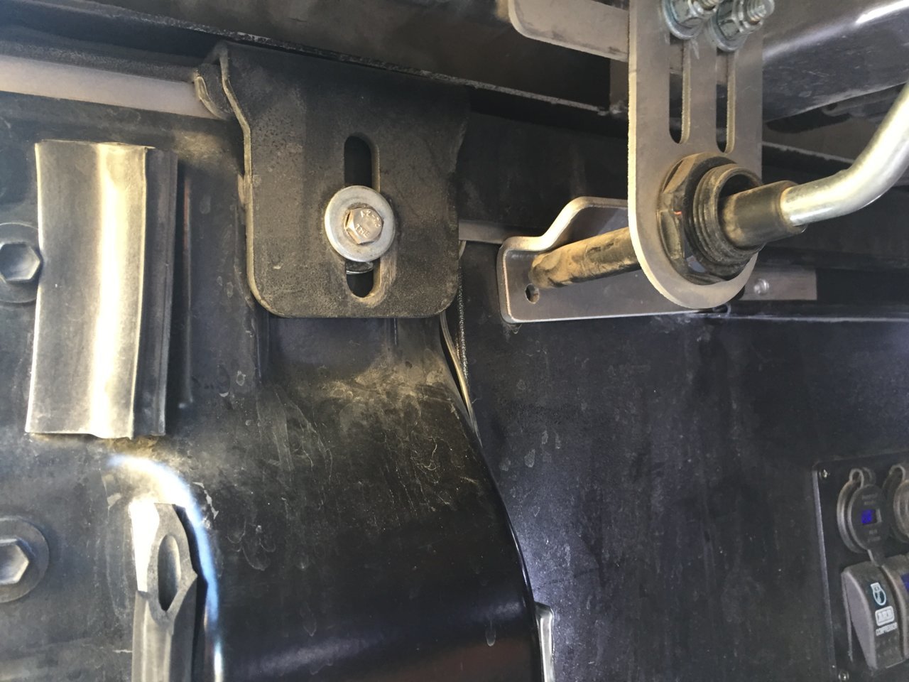

    Too bad the cargo tray has been out of stock. Got my diamond back, and Voodoo rack in though! Can you post a shot of the rear voodoo bracket as you mounted it to that OEM bolt. The OEM bolts back there are much smaller diameter than the bolts for the T Track along the bed. Worried about how strong that will be. Thanks Papadave418

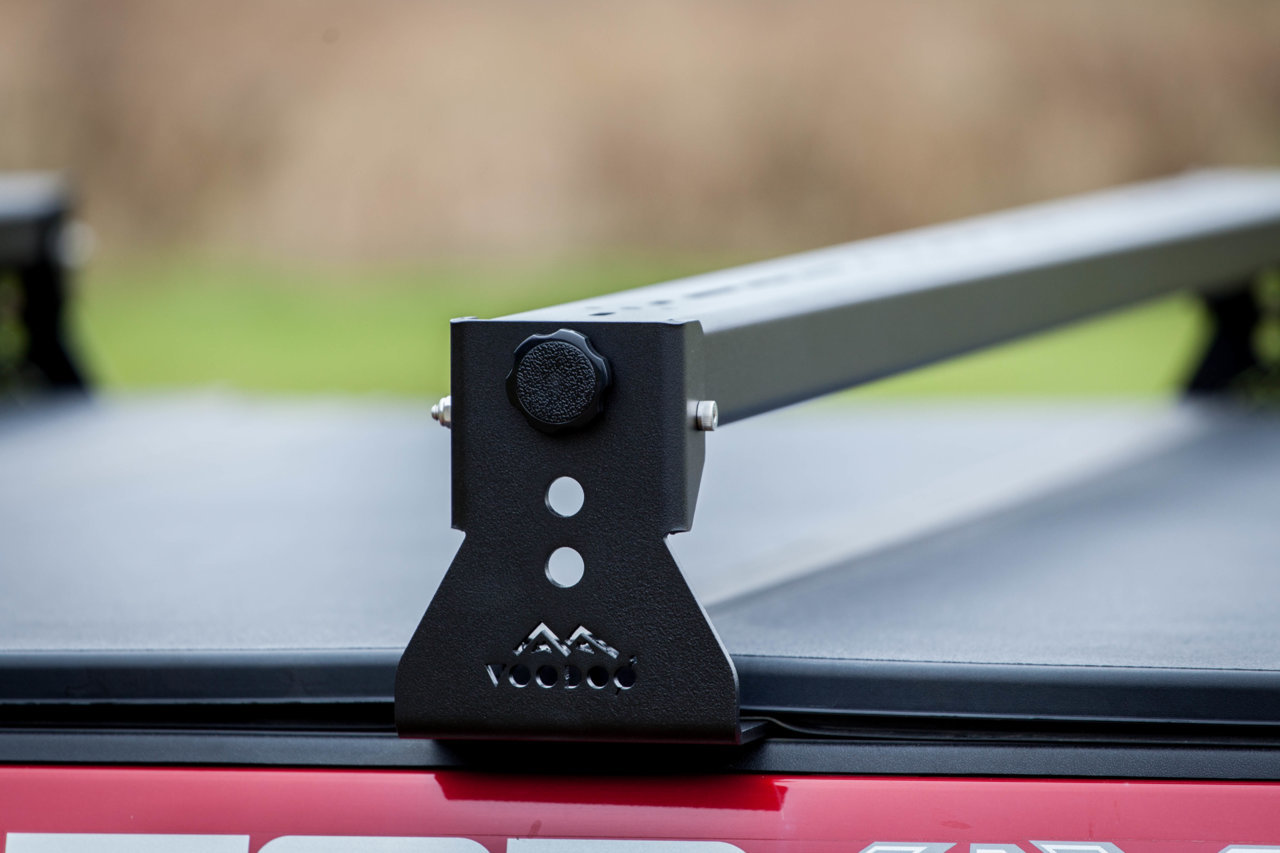

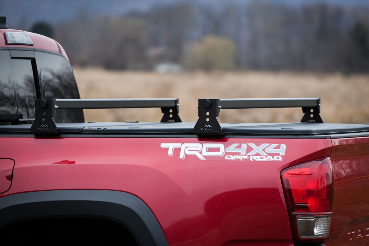

    We're going to be getting more of those in soon.
    We've been working on some new aluminum products, so I'll have them made all at once.
    Teaser aluminum Hi Rise Crossbar pics:

    Well I can say the cargo tray is worth the wait.
    So I went out and replaced the OEM bolts with stainless steel as I snapped my OEM bolt. It was a pain to get out. Oh I also went a 1/2” longer than OEM as well.
    Here you go
    ABB85AFE-C0DF-4AF1-9153-051F65811B31.jpg 7E7A15E3-E33A-4052-88C4-D13C03D8EEE7.jpg

    Thank you so much! I will definitely be doing the same with this bolt, and yes I am willing to wait! Can't wait but can hahaha!

    Did u use same diameter bolt or enlarge hole
    and rethread it for a larger bolt? Because it's tiny
