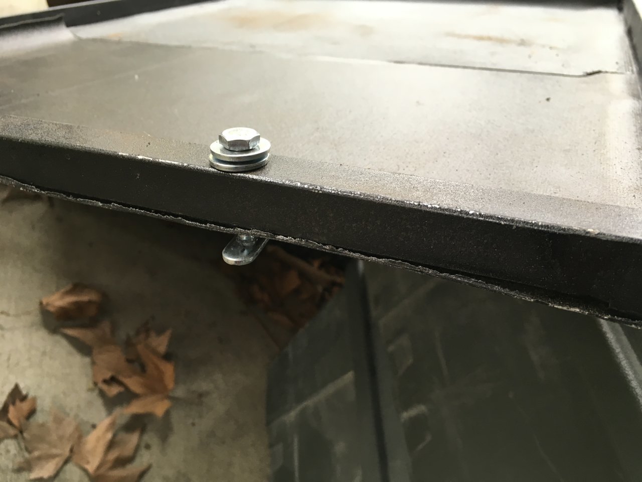

    Get a stainless flat washer under that bolt!!

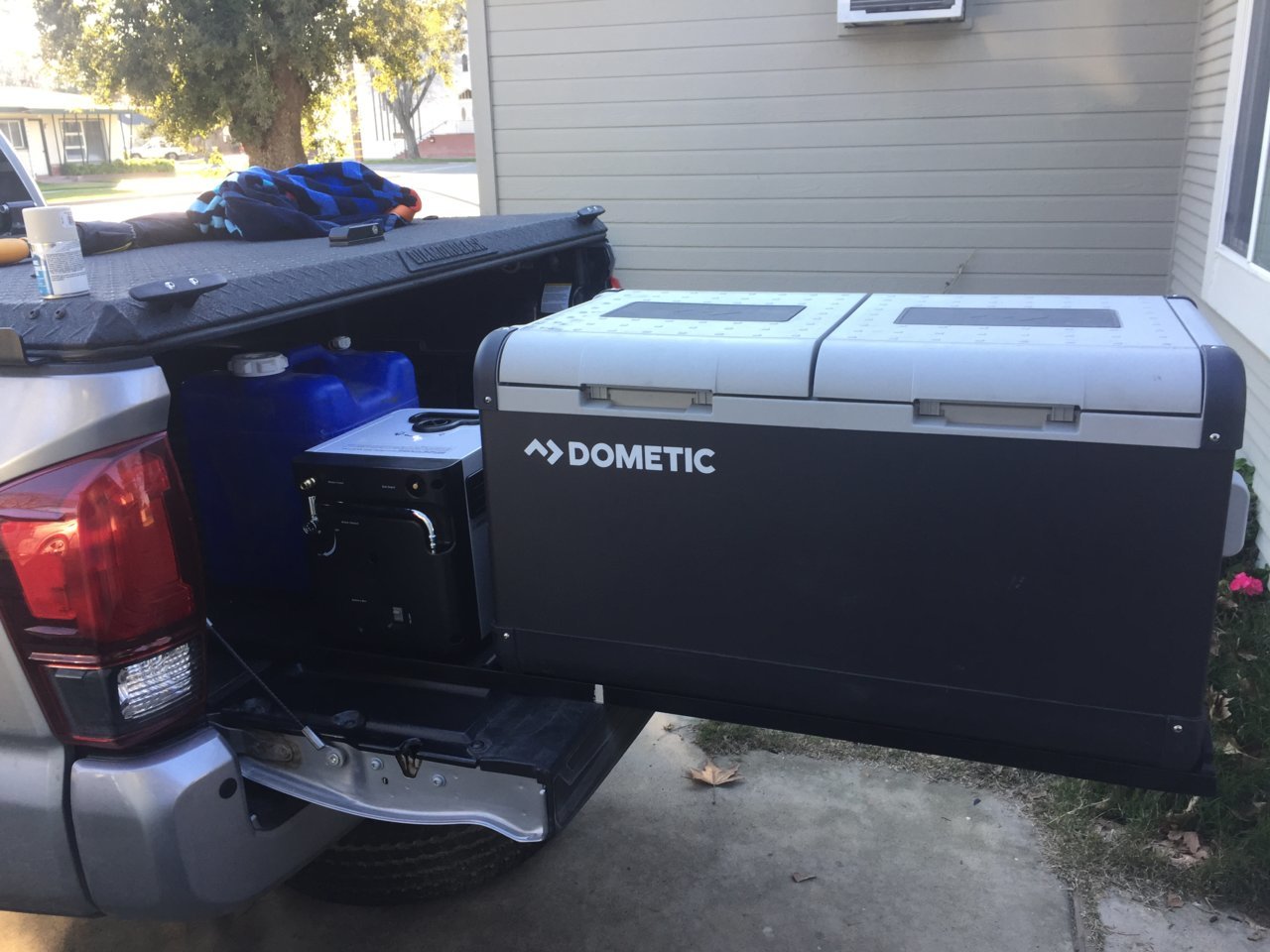

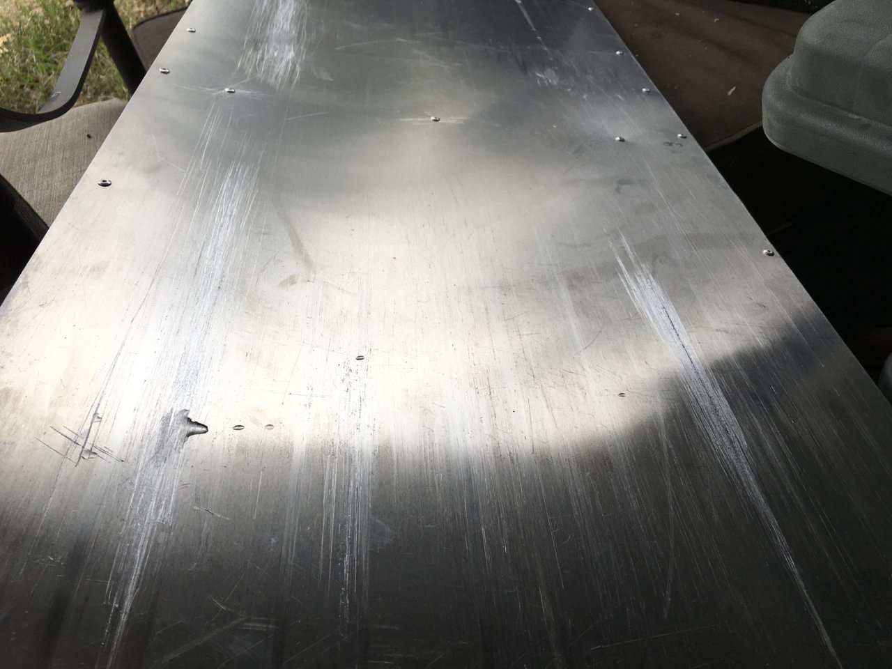

    Just saw this, so I actually made a slide to access the other half of my bed when off roading. Again this design comes out when I’m not camping. I had angle iron and 3/4” square tube welded together to make a flat tray skeleton that I riveted 3/16” thick aluminum to. It allows my Dometic 75DZ to just barely fit underneath and I can still access water cubes or whatever I place there. I used two C channels as guides with T nuts attached to the end of the slide so at full extension it doesn’t flip out. Works well enough

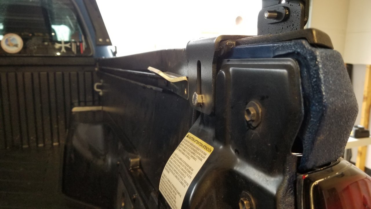

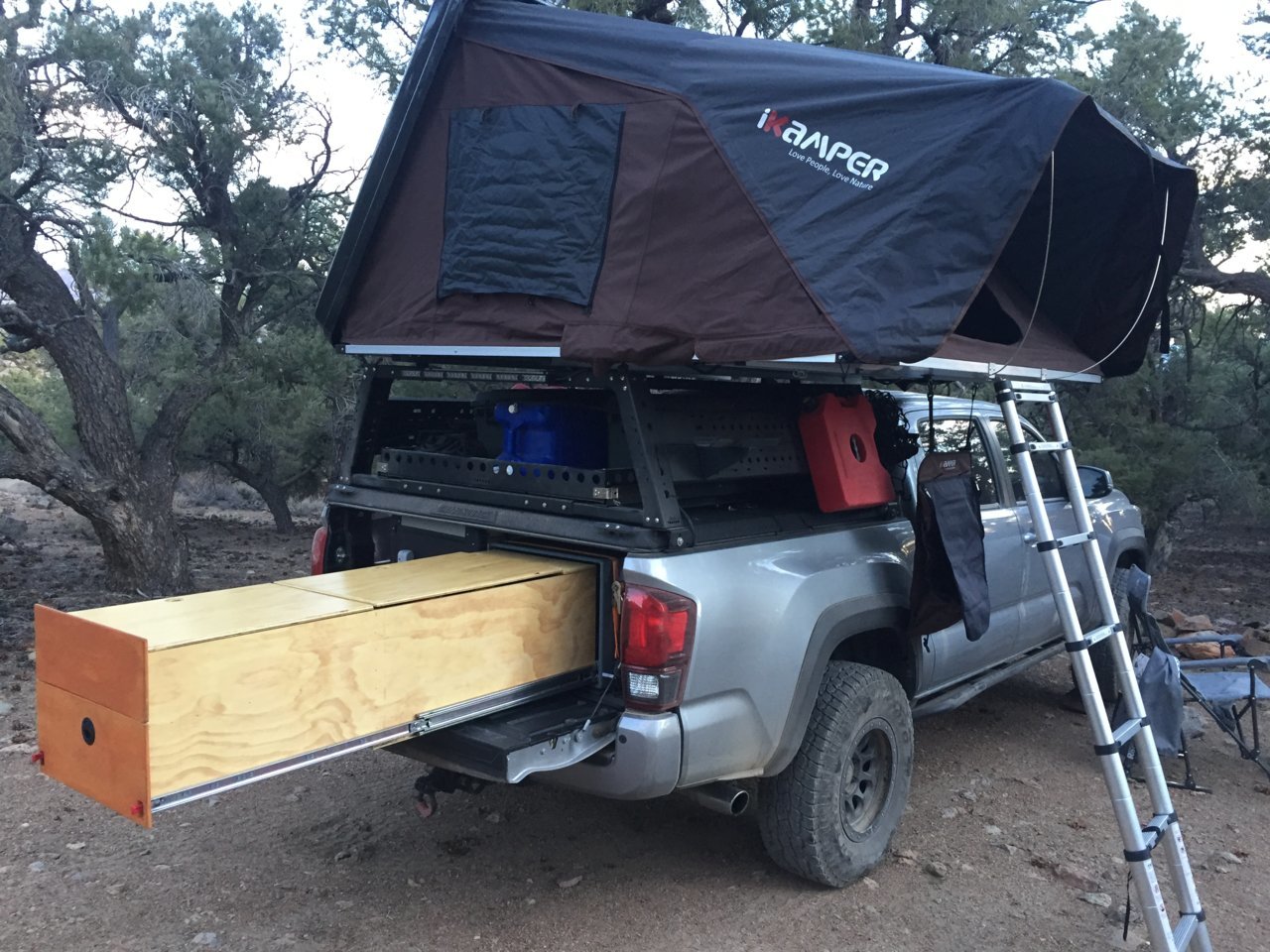

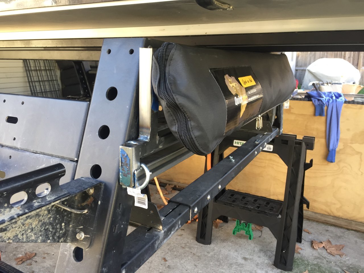

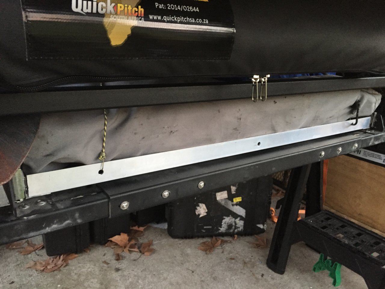

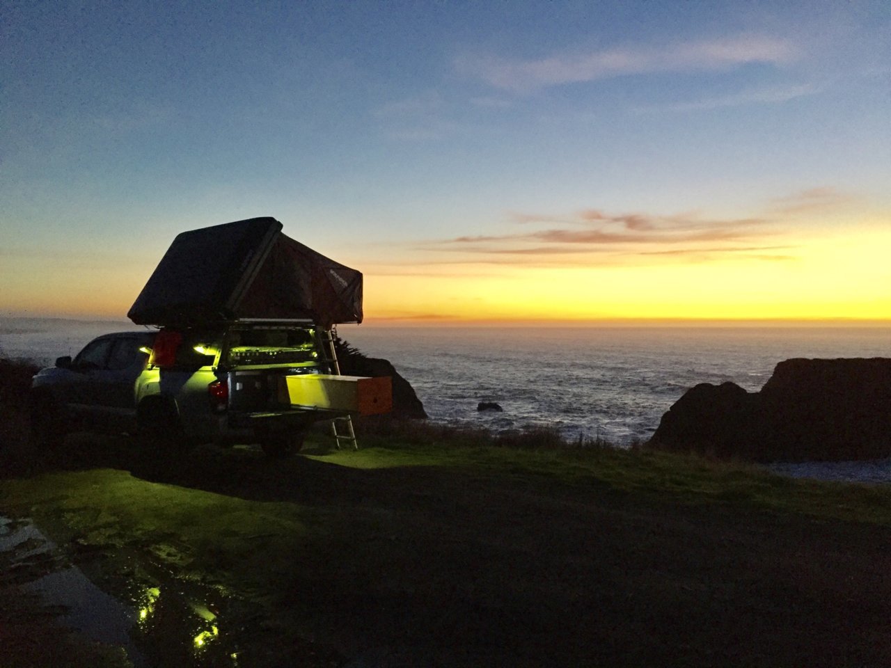

    I got the SE as I don’t have ATV’s to load on top, and figured I wouldn’t carry more than 500lbs up there. I added two six foot 1” square tubes that I hit with truck bed liner to go unto the tent. For my iKamper I did not use the standard brackets, but drilled a hole through the square tube, through the extruded aluminum cross beam, to a lock nut. So I have four 3 1/2” carriage bolts going through the rack to screw the tent directly to the rack. This gives me just enough clearance so when the bed flexes it does not hit the shark fin. Originally I tried a 1/2” of height using washers and it would tap the fin a little at full flex.
    As far as wear, the tonneau brackets have made indentation marks on the plastic side caps of the bed walls, but not the cover. At each corner, on the bottom of the crossbeam that joins at the tonneau cover bracket, I glued rubber pads so it wouldn’t scratch the DB cover. The cover is so thick the rack almost sits on top of it.
    You can kind of see the black square tube under the tent support beam in this shot
    In this shot you can make out how awesome of a night it was :)

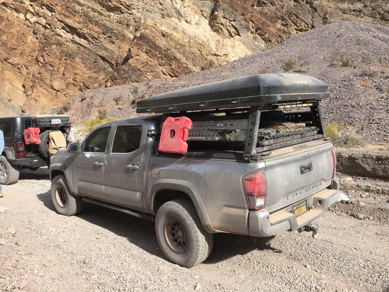

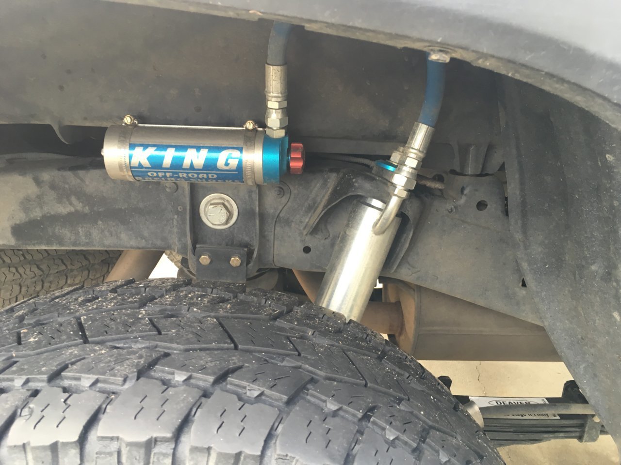

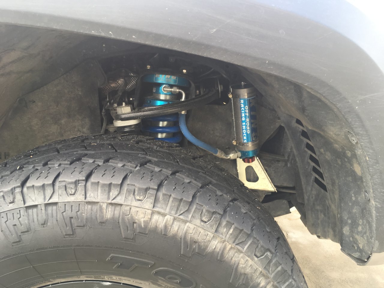

    Side note I finally lifted my truck and got my Kings on.
    8C2830E0-222E-4644-904F-E5F6C8361D42.jpg 734827D1-1C84-4604-9C1C-DDDE101E3D29.jpg B0449ADD-5594-4B55-B111-2E8CB0F524B2.jpg
    This is the profile now loaded, at Usal Beach in Northern CA

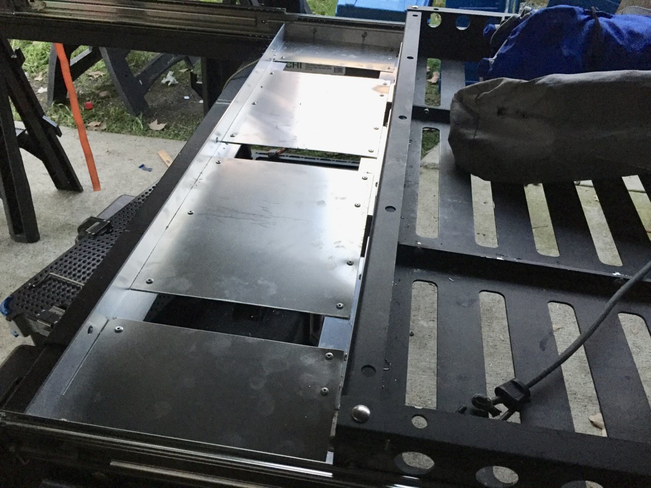

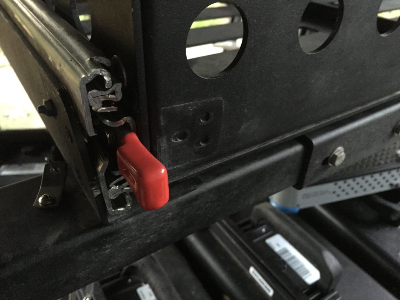

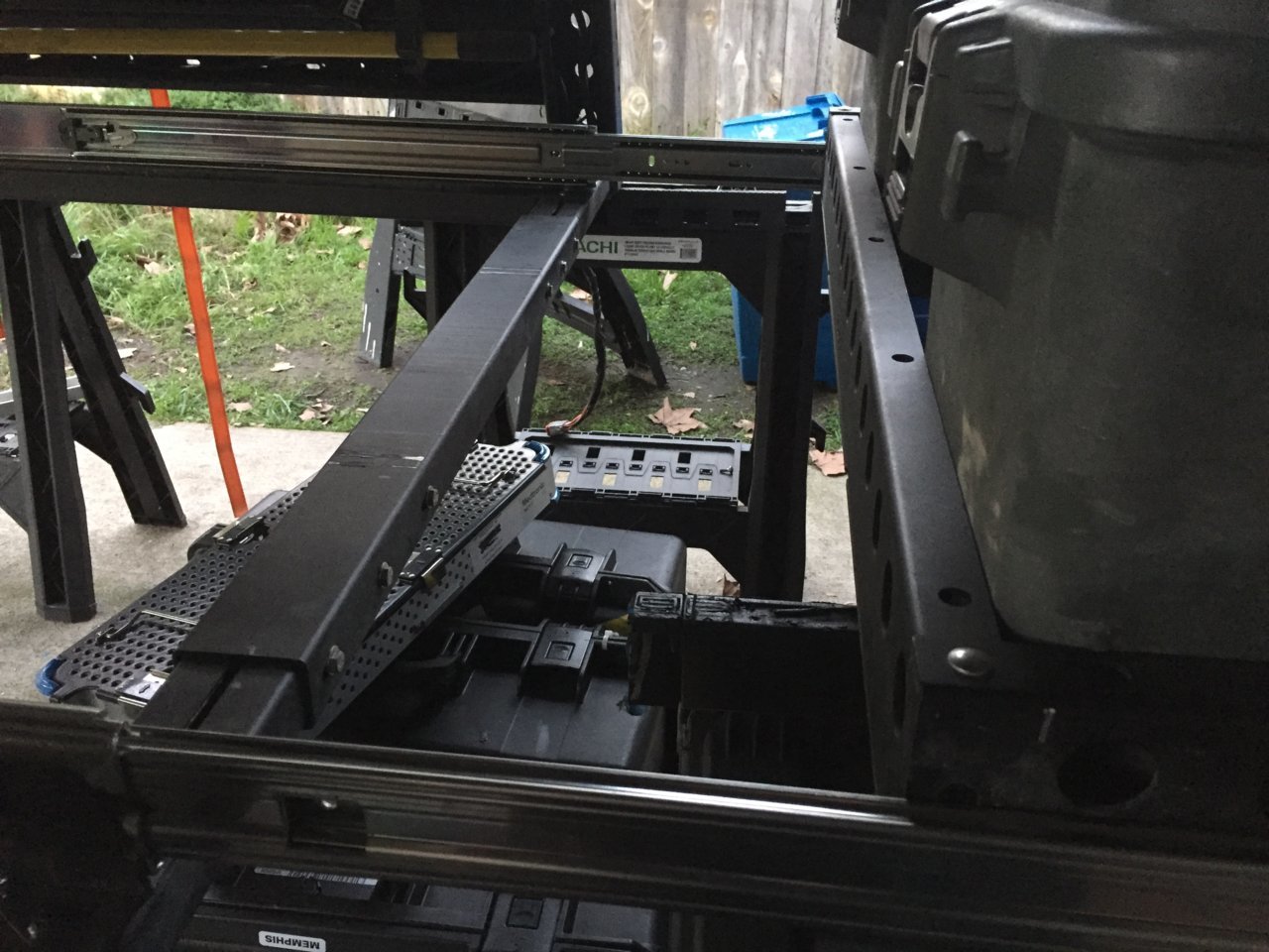

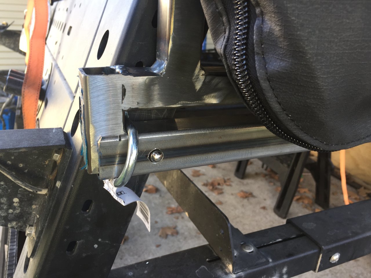

    I decided to add full extension 56” locking sliders to my @KB Voodoo drawer. It extends out completely now for easy unloading. I am going to extend the rear of the drawer 12” as I have the long bed rack on my short bed truck, and it will give me more room to fully utilize the space under the rack. Everyone likes a bigger rack

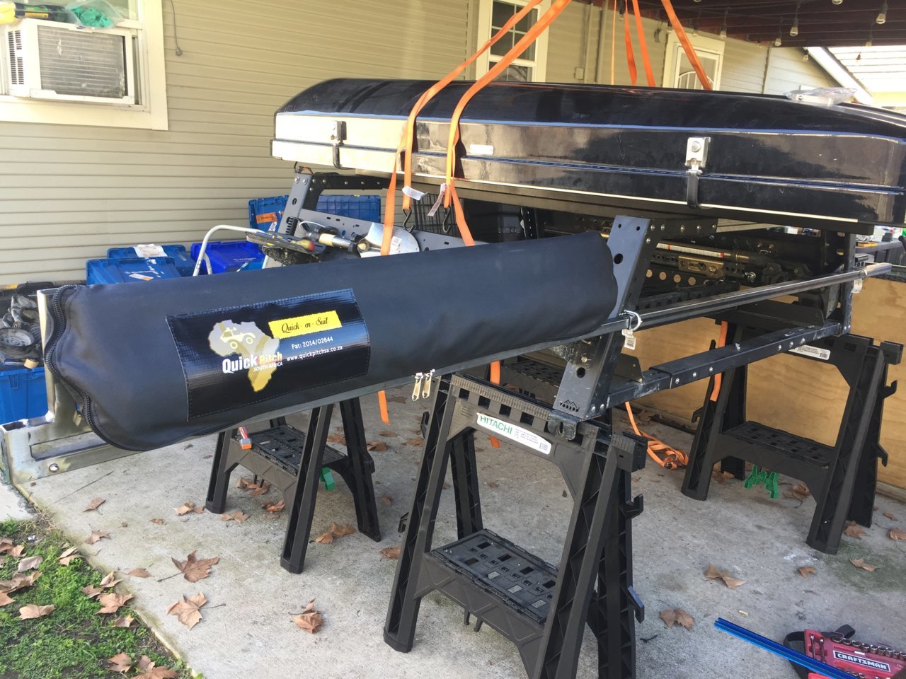

    My update is they are awesome, and I would buy it again. I made another change to my rack in that I added a perpendicular mount to the rack right behind the rear window. I added a Quickpitch privacy/shower, so my daughters would feel better about changing and showers.
    I find this rack is very versatile.
    The mount is painted now but not in these photos

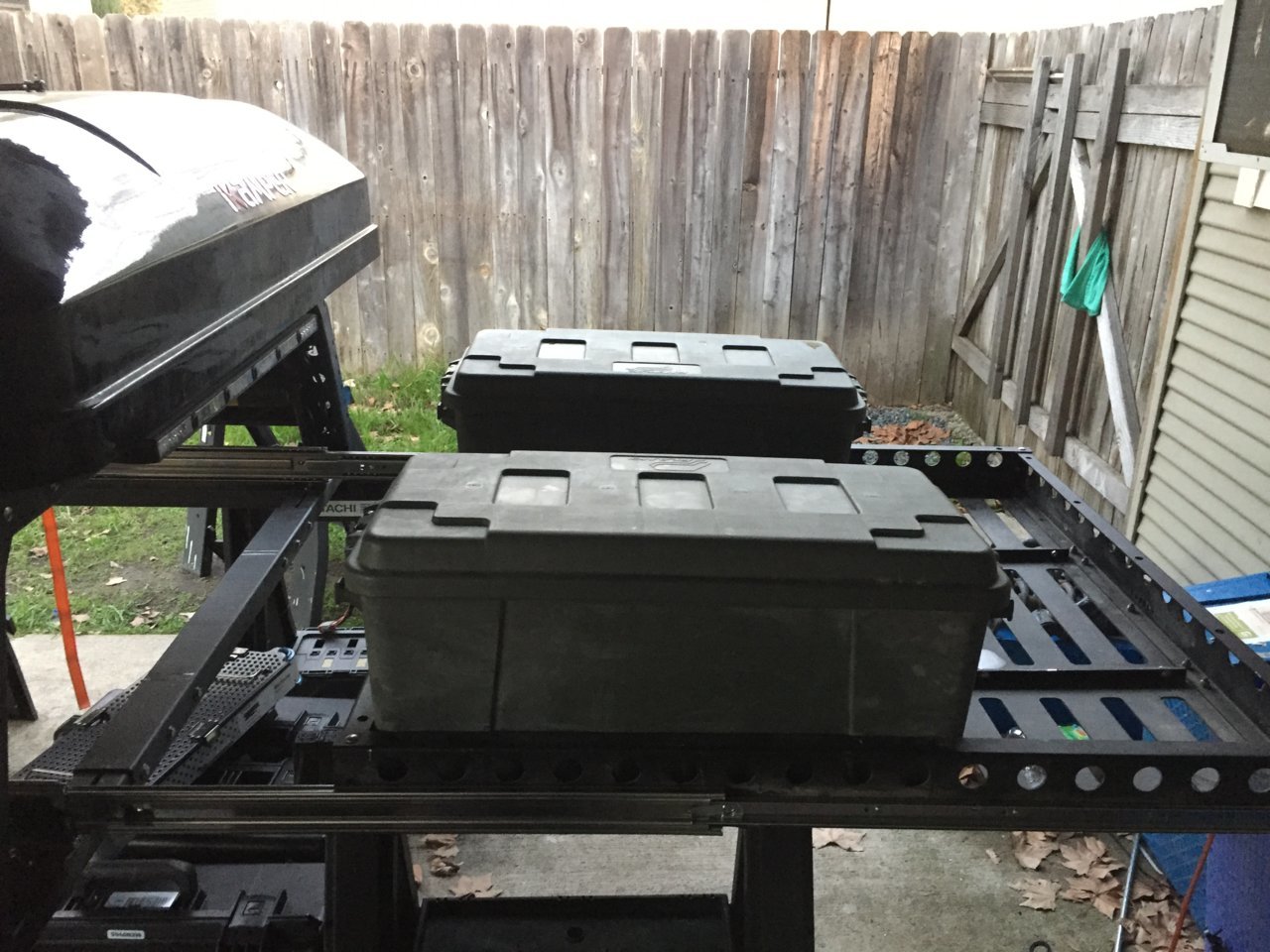

    1,938
    I finished my @KB Voodoo drawer extension. I had some aluminum leftover from my bedslide project so I was able to add another 12” of space. I switched out the standard sliders for 56” full extension locking sliders and added supports to the slider in the rear most section. Works well to be able to place some random gear like chairs which always take up awkward room wherever they go. Especially since I have camp rocking chairs :thumbsup:70C84912-E7F6-4E74-976A-130D774BC234.jpg 0963A1FB-58E9-4CC7-884F-12EBACB84DBC.jpg FF158A02-CF13-4533-ADE7-7F24F337D110.jpg27E2DE8E-8F71-409F-8A12-273887C28CC3.jpg
