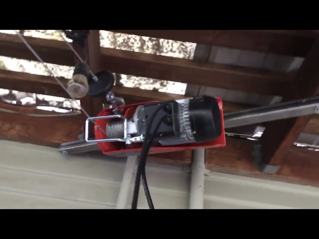

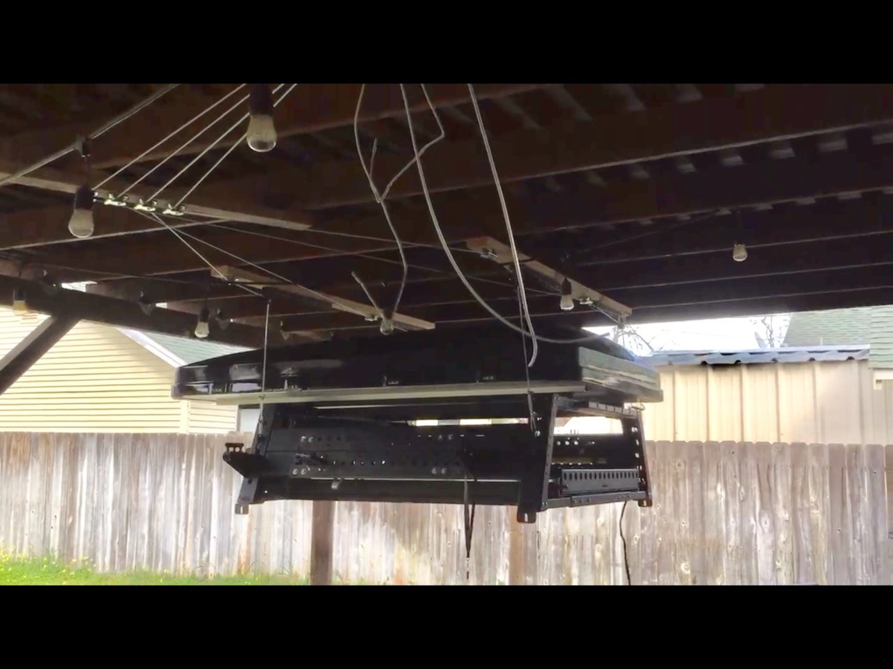

    I ended up changing my hoist system. I originally had tie downs but with all the gear I have on the rack now it’s hard to use those, and then bought a hoist system off Amazon. But it started to fail as it’s mechanism runs via my power drill. So I got a $100 HF hoist and rigged up some additional pulleys. Honestly I can’t believe how well it works and that it lifts evenly
    Rack and tent lifted, the loose end of the cables weren’t tied up yet in the foreground of this photoDB981A68-8ABB-42B3-9B85-19C5A5B0E02E.jpg

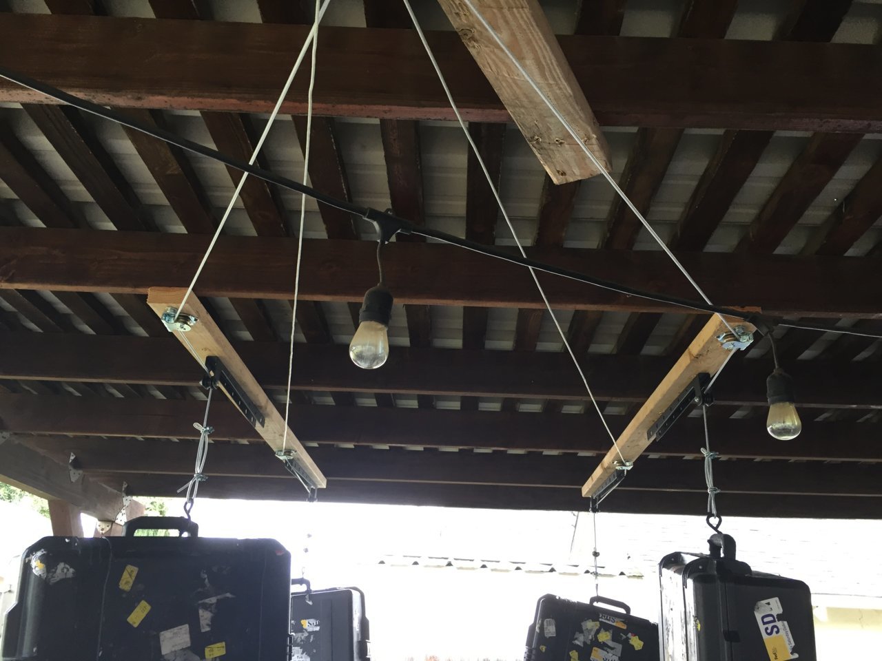

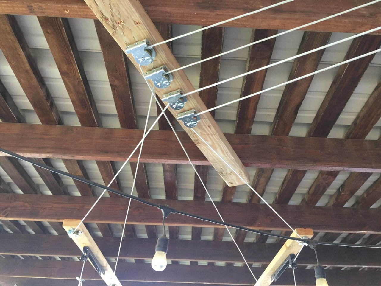

    Ceiling mount pulley to line up the cable better
    I used pelican cases as weights to make the cables tight to even up the tie points
    I lined up all the pulleys square to the winch so they pull evenly

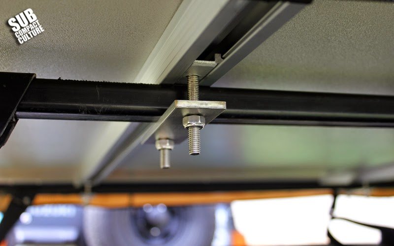

    Question about the iKamper attachment - could you not clamp the iKamper directly to the existing (width-wise) cross-beams that form the structure of the rack? Or did you add your own (width-wise) cross-bars because of where the iKamper attachment points are?
    It would seem that some RTTs like length-wise bars to attach to, but the iKamper mounts to the width-wise crossbars, which the Voodoo doesn't have...

    I could have attached it via the cross bars, but honestly I don’t like the way most RTT’s attach to racks. Depending on how long the tent is you can attach to the main 2 rack crossbars on Voodoo racks. I don’t like the little mounting plates RTT’s have with 2 screws and 2 nuts it leaves room for play and things working loose. I decided to drill a hole through the aluminum cross bars and use 1 strong carriage bolt to a stop nut at each each corner. It has worked well for me.

    Most mount like this. I did a single fatter carriage bolt straight through the rail cross bar instead

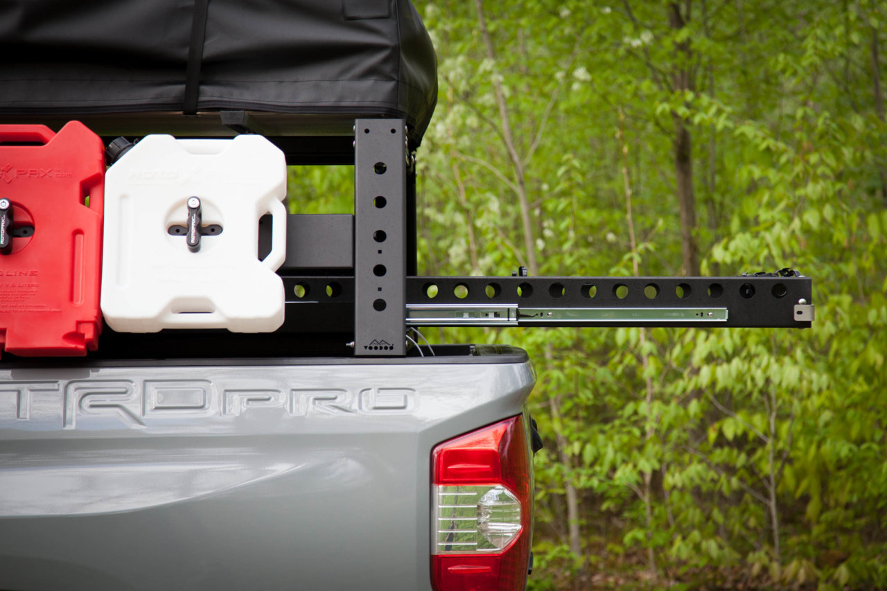

    Are these extensions sold by KB also or did you source them elsewhere?

    I got 56” full extension slides from cabinetparts. Com
    The standard slides are fine, but with my Plano totes I wanted to make it pull out further so I could load and unload them more easily. Then I figured if I was changing them out might as well go longer and added the extra storage
