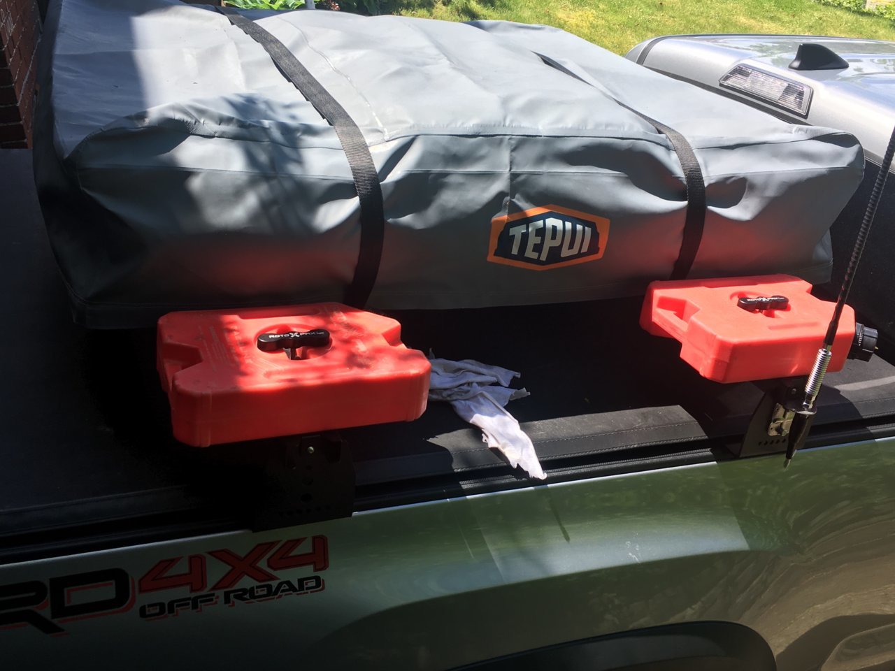

    Put your rear upright closer to the rear. I have the Alumax rack but the rear bracket is mounted closer to the tailgate. Although maybe the width there won’t work for you. It’s post #74 I believe that shows a photo

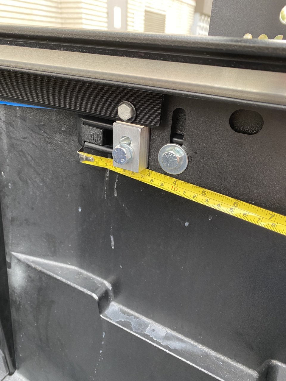

    For those considering buying a retrax to pair with this, if you plan on using an RTT you need to make sure to get no larger than a 2 person tent or go with a different tonneau.
    Tepui recommends a gap of 32-48 inches for 3 person tents center to center. These bars with a retrax sit at 24 on my TRD pro.
    Now, I haven’t been able to figure out why that is their recommendation. It either protects the base from bending (sleeping on the ends) or it ensures that the tent doesn’t tilt if you put too much weight on one side or the other.
    It doesn’t look like moving the crossbars to be by the canister will help much either because the tent will definitely not be center.
    The good news is that @Glenn_R has been using the setup with a ruggedized kukenum 3 for a few years with no issues. I shyed from the ruggedized due to weight restrictions, but I have to wonder if the diamond base plate has helped at least from a base bending aspect.
    I’m going to roll with it for now; I have the Autana 3 and I plan to watch for bending, but I’m not really worried about all the bolts snapping and the tent tipping (which would be a terrible day).

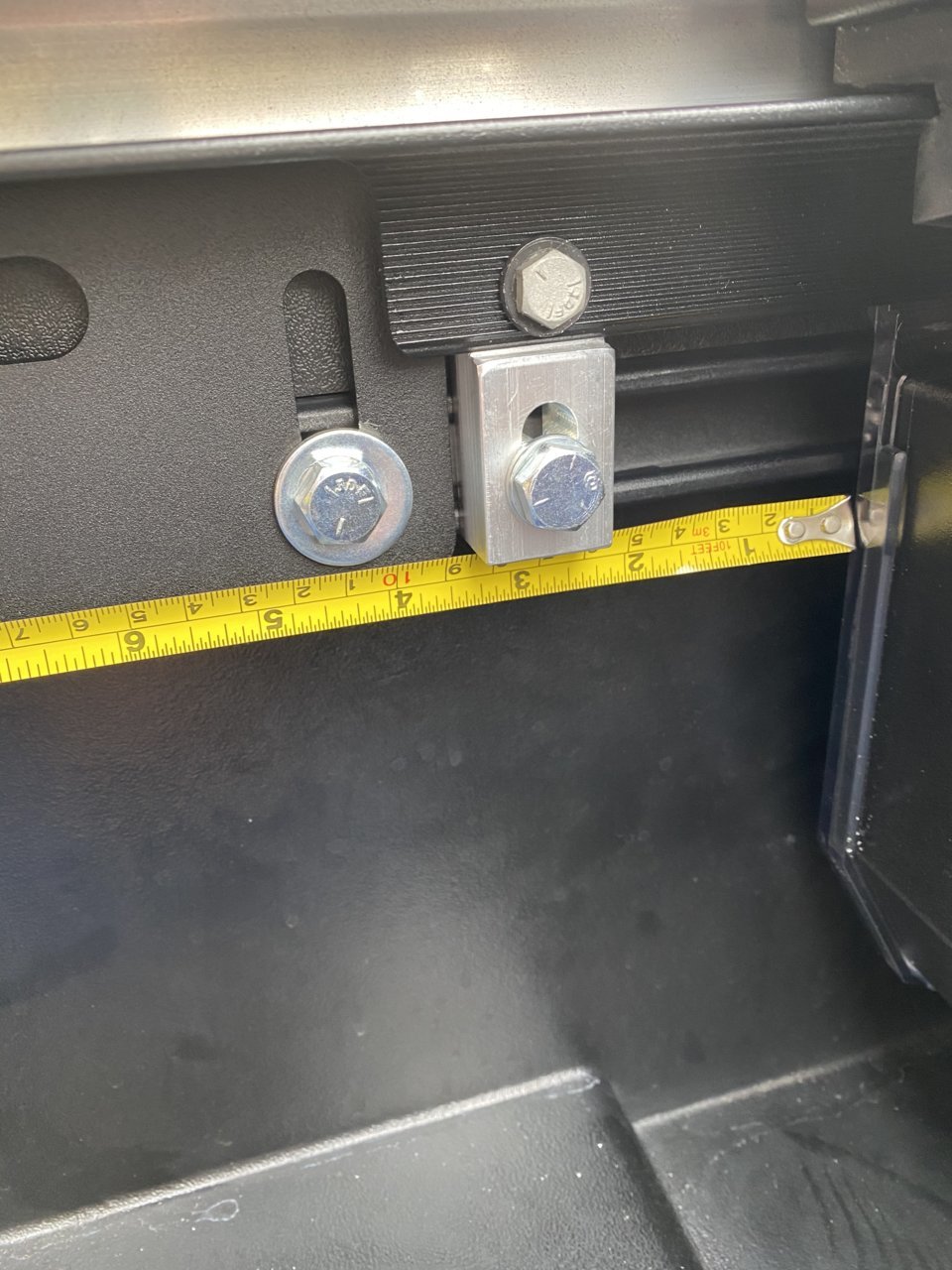

    So it does look like it would be possible to gain another 7 inches by replacing the cleat attached to the retrax rail with one that could fit over the crossbar mount. It would require drilling a hole through the mount and possibly a longer bolt but it seems like it would be at least a little bit safer for 3 man tents.
    I wouldn’t even know where to begin with the cleat itself so I’ll leave it as is unless kb voodoo were to come up with something.

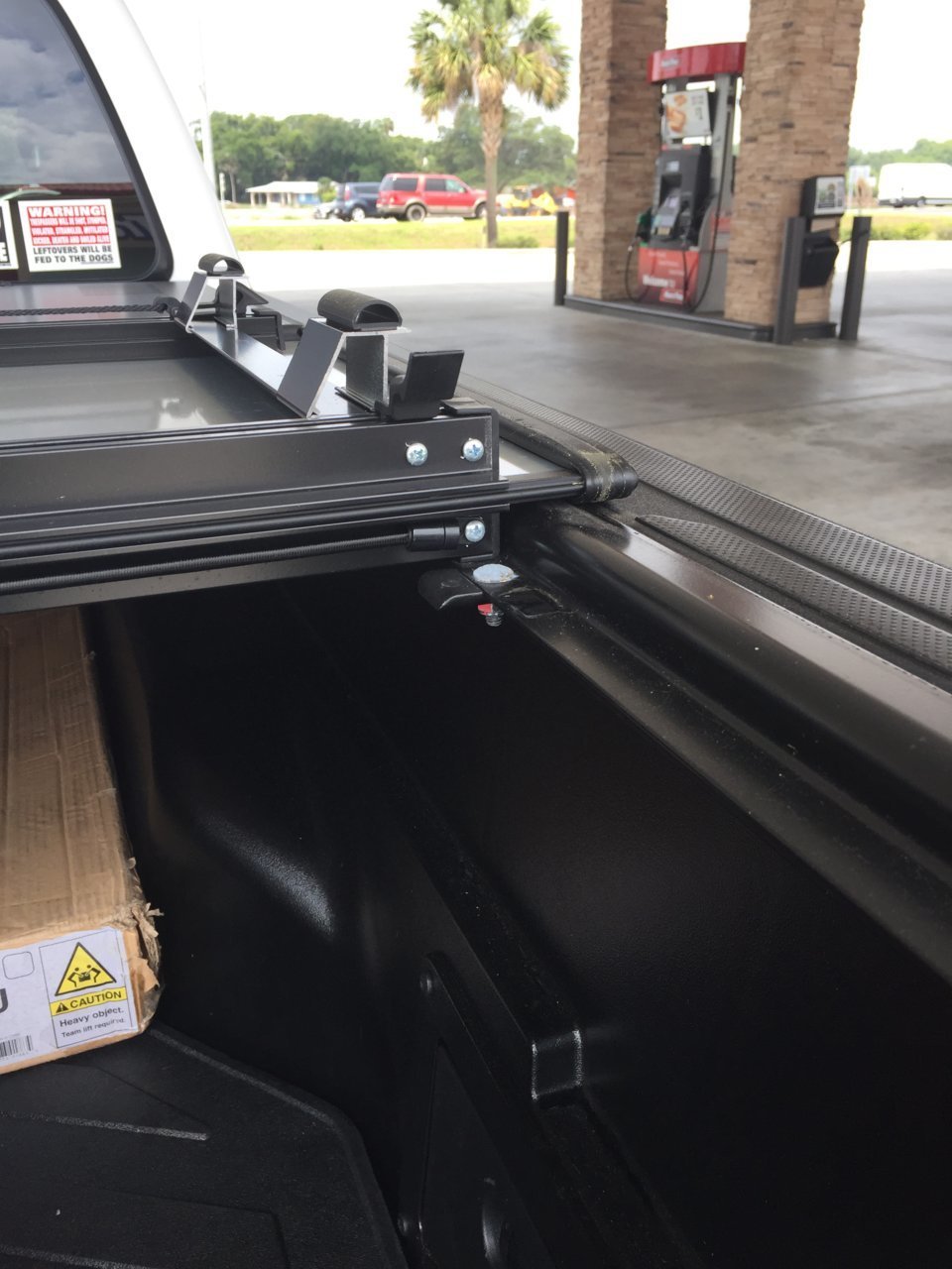

    My Diamondback cover has a gasket seal that just goes right around the bracket

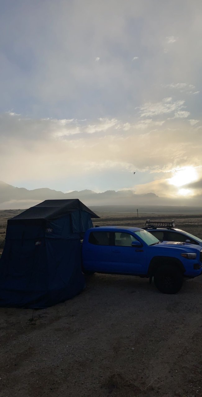

    Took the truck out this weekend

    Which tent is that? Looks good.

    Tepui explorer series autana 3
