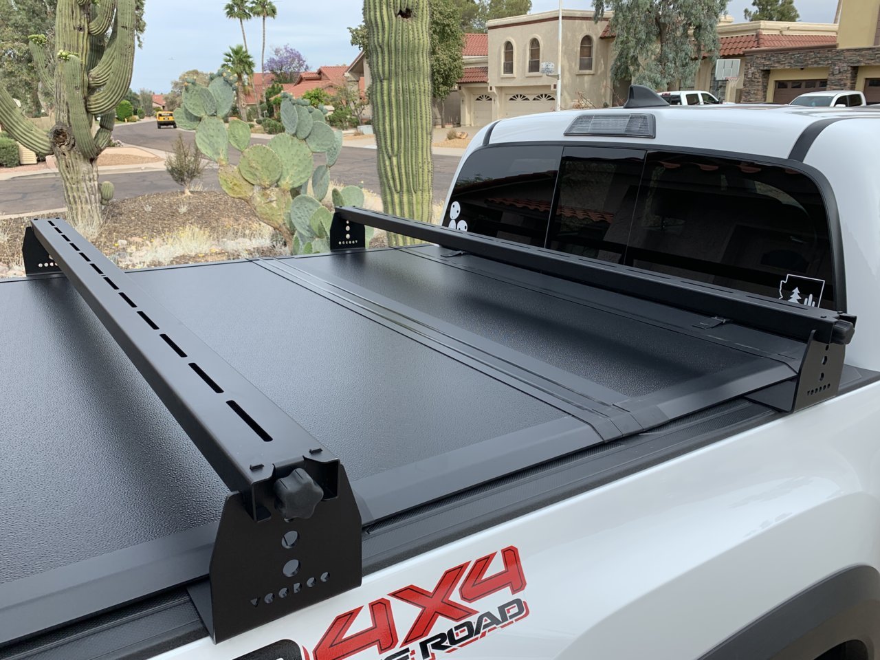

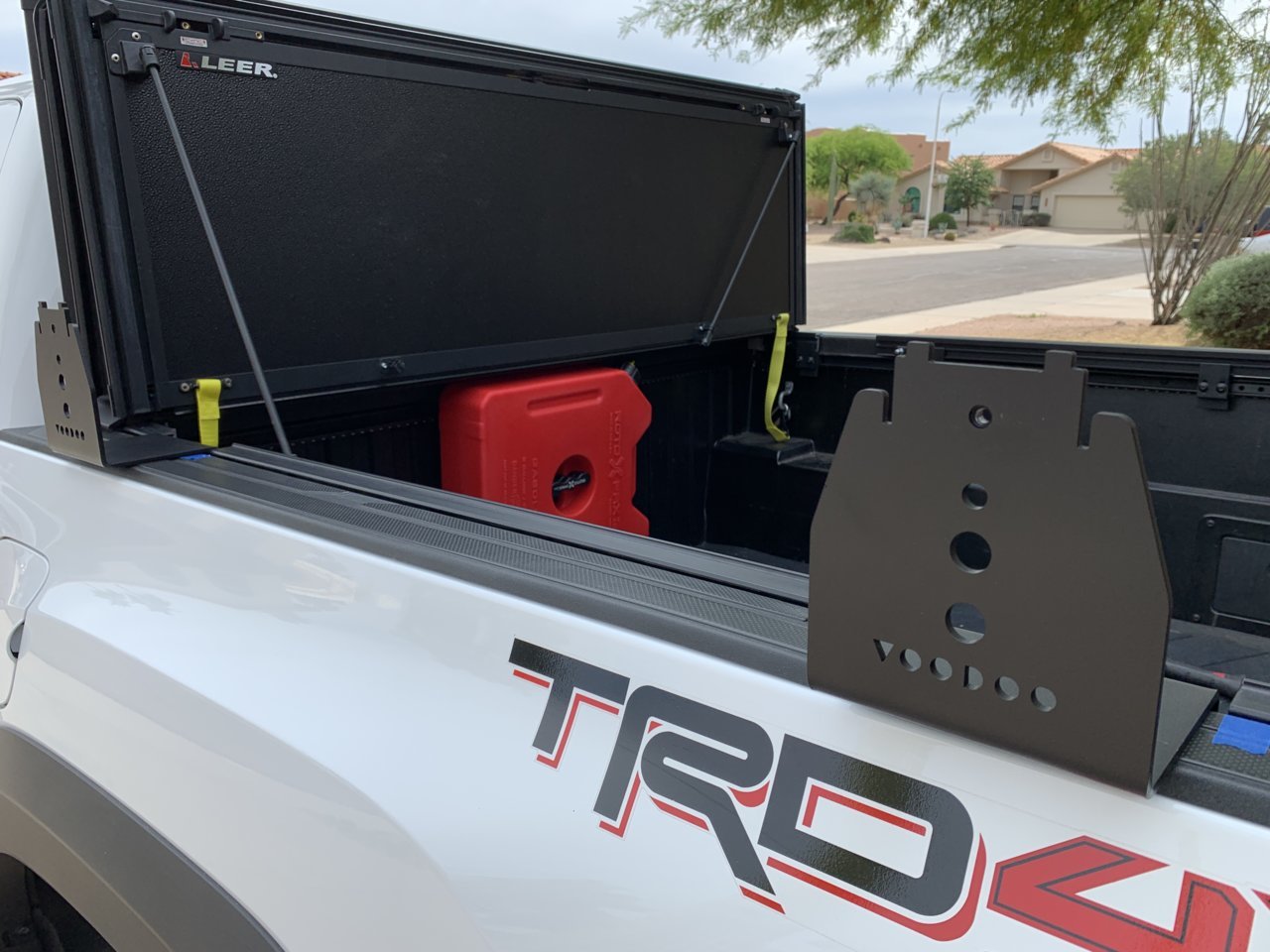

    Don't know if it'll help or not, but here's how I set up the KB Voodoo with my LEER HF350M cover:

    Thank you! Can you take a photo of how it's installed on the rail. Lomax uses oem rail to attach the cover rail.

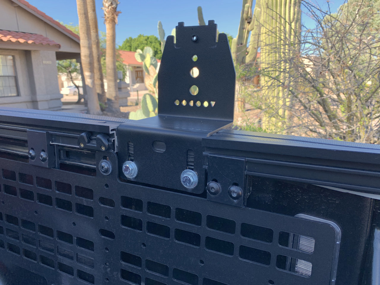

    LEER does the same. The tonneau rails are attached to the factory rails. In order to make this work, I had to cut gaps in the LEER rails to accommodate the KB Voodoo uprights. This has worked very well, although things aren't as dust/water tight as they were before:

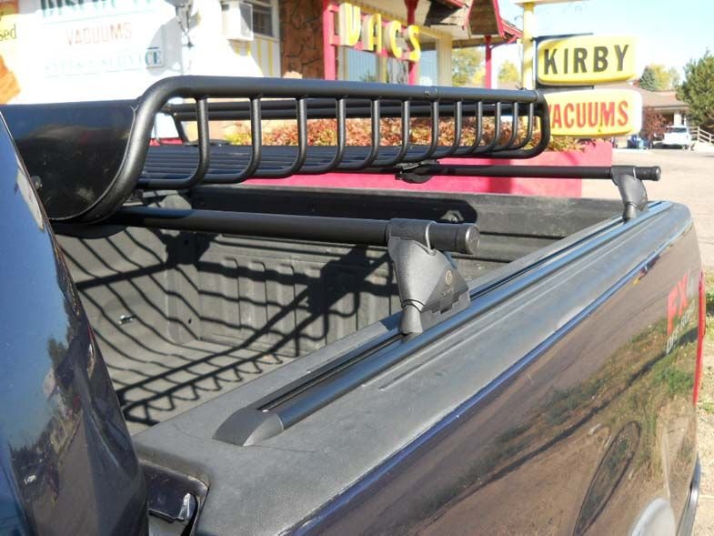

    Track mounted Cross bars seem to be a viable option.

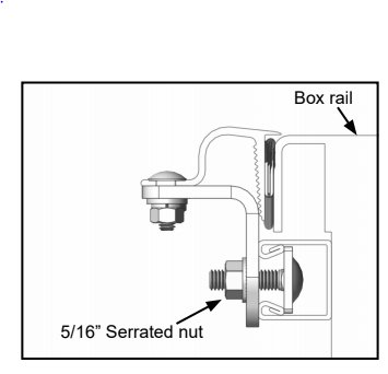

    Other than the dust and water you mentioned, was there any issue with the cover latching? Or did the smaller portions of rail stay in place? Looks like Leer uses two bolts to attach the bracket to the rail.
    This is the Lomax bracket.

    The rail sections stay in place with no problem, and the cover latches normally. I've had no issues at all in that regard.
