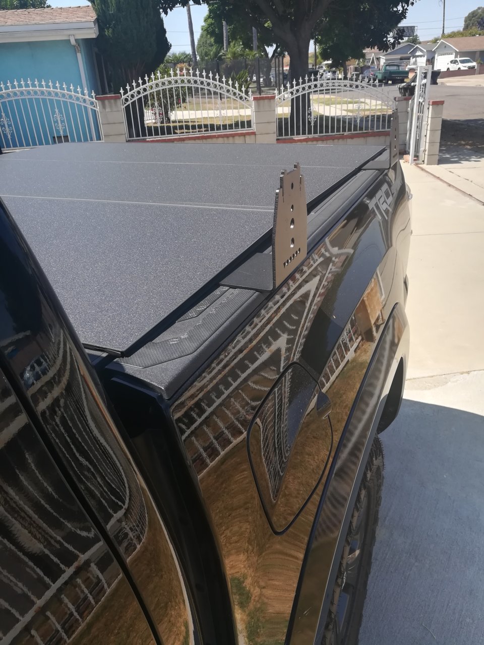

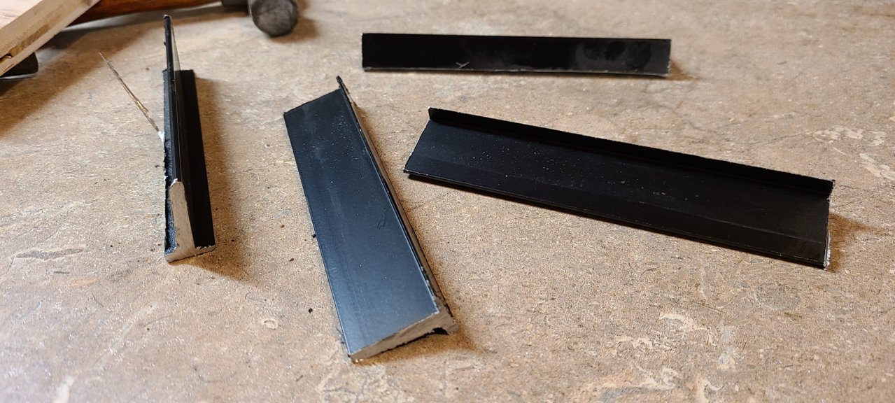

    I just cut the rails

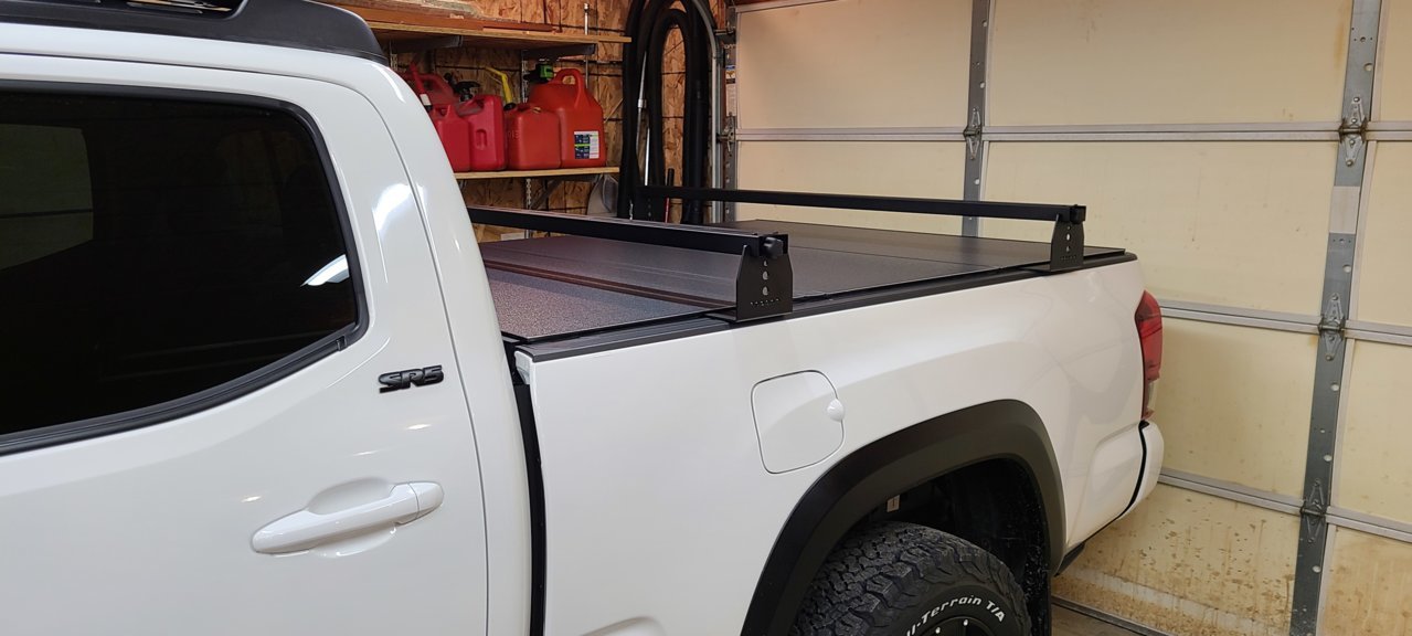

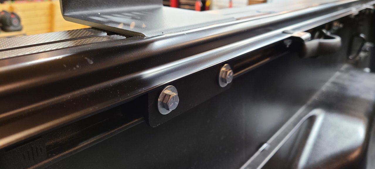

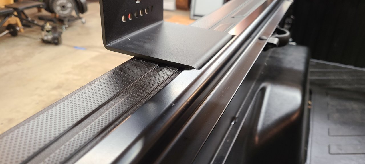

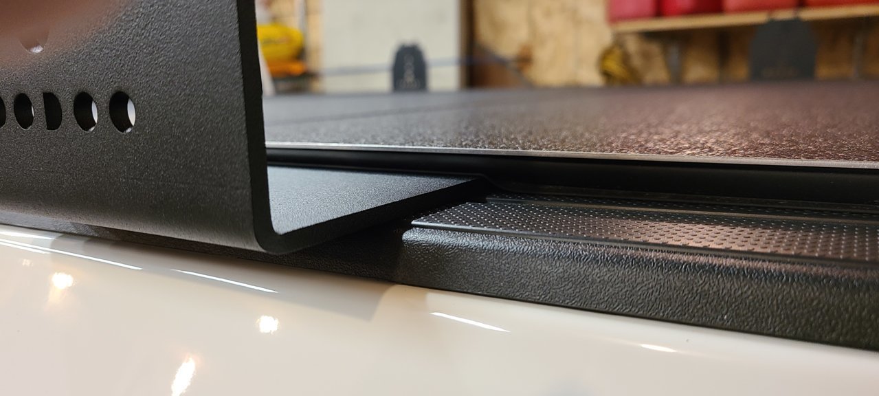

  14. Jan 29, 2022 at 9:06 PM
    #34
    danjones75
    danjones75 New Member
    Nov 25, 2021
    #383038
    3
    Dan
    Villa Park, Illinois
    2021 SW SR5 4WD DCLB
    You can do it! I couldn't stomach letting my Voodoo bars go for half of what I spent on them. So I got drunk and stared at my truck for 3 hours. Notches bitches! Figure out where you want the bars and just notch. 5⅝ inches by 11/16. Plenty of integrity left in rail. Very happy!
    donp, Dan2731, DMTaco420 and 2 others like this.
