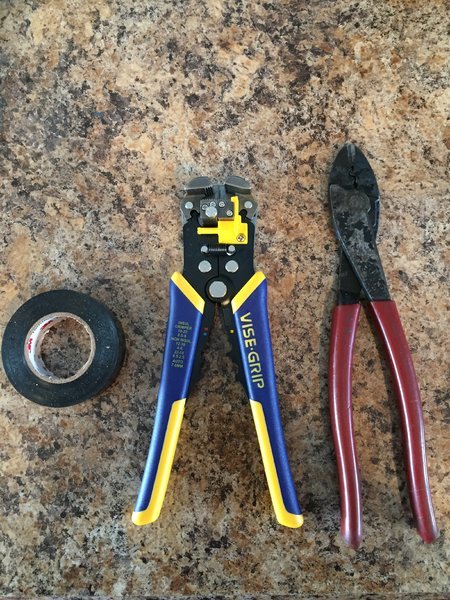

    Here is the only tools I used

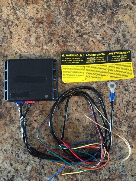

    Remote start Unit
    I will say the directions are pretty straight forward and very easy to follow. The wire colors and photos of the connectors made it a breeze to install.
    Now you do have to remove some interior pieces. I removed the kick plate which was 2 phillips screws and a 10mm and the steering column cover which was just two more phillips screws. The start button wire that needed to be tapped was easy as well.
    All wires were separated off so no cutting or modifying anything just plug and chug.
    Programming couldn't be easier no sequence just plug the module in and hit the start button twice with your foot off the brake, green light and your good! Once it was programmed and working I tucked it between the BCM just like nickj posted. Looks really nice.

    Which DEI model is that? What is the FCCID on the label of the box?
