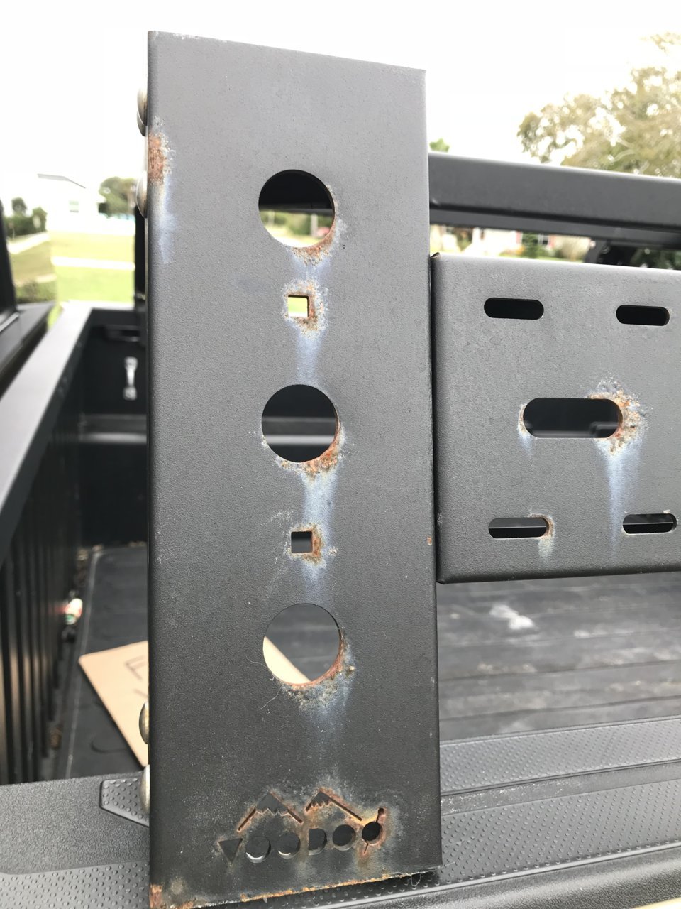

    6FA455D2-DFC9-4163-BE79-2938AB63FFB8.jpg 7487E4D1-5C0F-40F7-A9DB-7A02D5DE8BF3.jpg F684B3CB-0FEC-4A9F-A143-87918F0CC173.jpg I want to start this by stating I am not trash talking, just giving facts. When I started the process of getting the rack I read a couple of reviews that mentioned the rust problem. I contacted Chad at kbvoodoo and he said the issues were resolved and they got a new powder coater. I moved forward and was really excited because it is a cool product. Well.. 4 months in and it looks terrible! Chad wouldn’t back his product and I’m stuck with a product I have to sand and paint now after just 4 months. Maybe it was a fluke. Maybe he’s a cool dude. Maybe I caught him on a crappy day. Just a heads up.

    I, too, believed the "new powder coater" line, he must be on the third or fourth new and better coater. My steel tailgate cap, from the same seller, began to rust and to bubble very shortly after it was on the truck. I wrote and based upon the reply I decided I didn't want the hassle. I had Line-X encapsulate it.
    The cap is a nice design and a sturdy product. The coating is crap, the coating was probably never intended for rough use such as a tailgate cap. I also think the preparation of the steel prior to coating could be a factor indicated by the bubbling. When I took the cap off to take it to Line-X the underside, which is not exposed to rough handling, was bubbling in places and rusting.
    Buy it but be prepared to repair the coating.

    POR 15, topcoat of your choice.

    I am going to use Por15 and the topcoat of my choice, but I specifically bought a finished product so I wouldn’t have to apply a finish.

    If I had to guess he probably would on his third powder coater, so.. either they never actually changed PC vendors or they did but there’s no quality control in that prep or coat process.
    So, I’d either pass on his stuff or be prepared for this experience, it’s a bit of a theme and has been for a couple years at least.

    If people are worried about the quality of the powder, why not order bare and get done locally or just continue to treat yourself?
    That’s some gnarly rust, but you’ll find that one most steel products like this. Also very thin looking PC, but that’s the breaks :(
    Hope it works out. Winter is coming.

    The rust is gnarly. Lol. The option to order without pc doesn’t exist for his stuff...maybe it should. The worst part of this is that I was going to keep using his products: bike mounts, sliders, etc. I have already invested money( which I don’t have excess of) and my rust issue was completely ignored by Kbvoodoo. That type of response, or better yet, lack of response speaks volumes. Some people can overlook things like this and still think he’s cool or or a stand up dude. Not me. I can fix the issue, but he should’ve and he would’ve had a customer for life. All this to say buyer beware.

    Properly prepped and coated steel doesnt rust to that degree in 4 months, expecially during summer/fall months. Thats a bullshit line they fed you. Plain and simple. Voodoo cheaps out on the coating and passing the problem off on the customer.
    Do they not realize there are millions 20-30 year old vehicles made of steel with less rust than that rack? :rolleyes:

    From my experience in rust, that is due to the prep.
    If you want it to last, you have to get it zinc coated, and then painted ontop of that. This would definitely add to the price, but zinc coating that rack would probably be in the range of $100 +/-

    Too See that kind of Rust after a mere 4 month equal pure crap for a finish Now ok if it was only around the bolt holes that you used I would say "well that could be damage from your mounting bolts" but what we see here is even badly rusted around the logo so that is clearly Garbage quality from the vendor even if they did not do the coating they are the Seller of it with the finish on it and a truly good Honest vendor would stand Behind their Product and take the issue up with the shop that did the coating and that reply from voodoo just so lame because I have had properly prepared powder coated bumpers on a FJ Cruiser last better than than for 7 years in Upstate NY outside all the time!

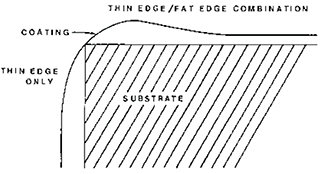

    This ^ powder coating in not a magical coating that stops rust.(not saying it should look like the OP's pics after 4 summer months) Most powder coats are a thermoset powder that forms an egg shell type coating over the metal. If the coating is not sealed 100% it allows moisture under the coating causing the base material to rust underneath. All the spots that are rusting in the OP pics are notorious for the powder pulling away as it flow out making the edges thin. A Zinc Phosphate pre treatment defiantly helps prolong the life of the powder. Or multi coats to build up a thicker film thickness.
    Here is what's happening on a microscopic level.
    Most manufactures don't Phosphate treat due to costs as they would nearly have to double the powder coating price. Here on the west coast they don't issue too many permits for the treatment as it's not the greatest for the waterways. Hell our county won't even allow it.
