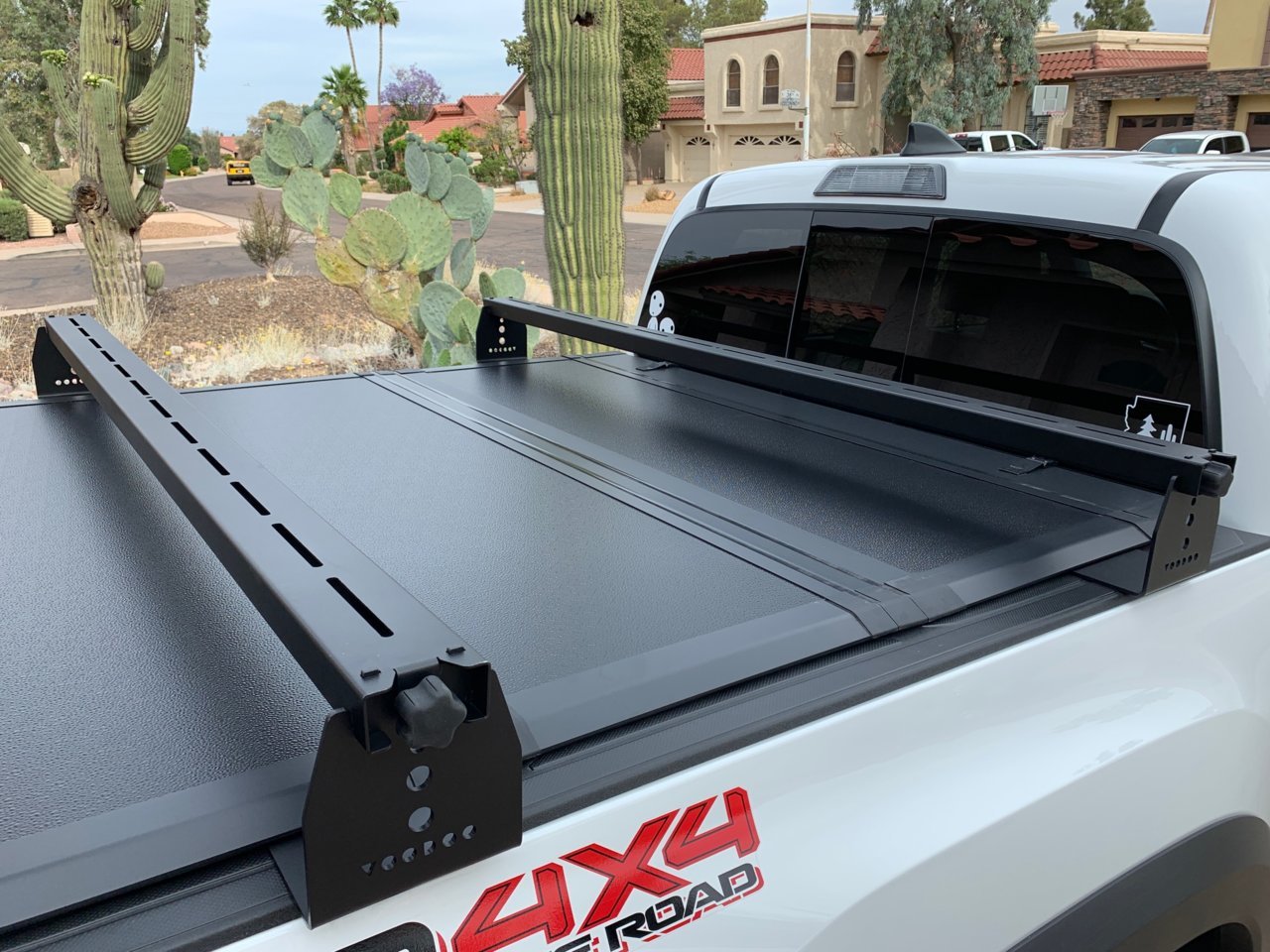

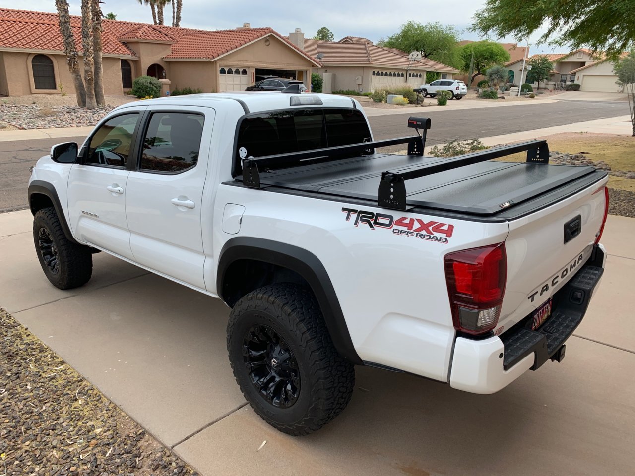

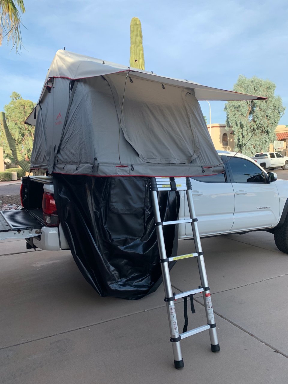

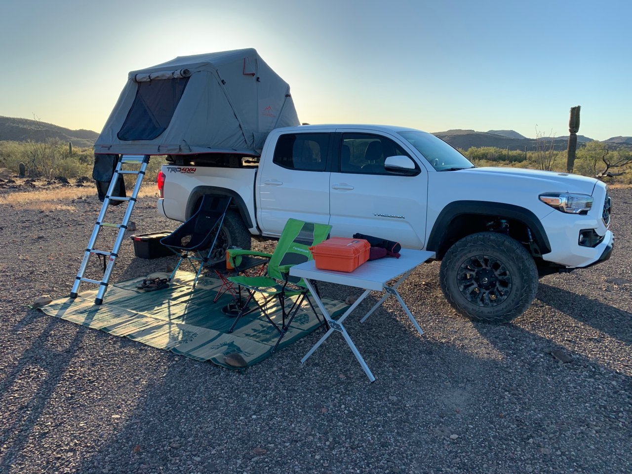

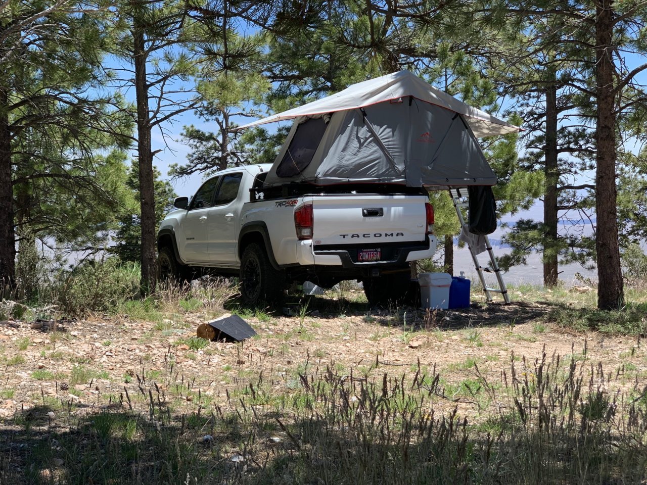

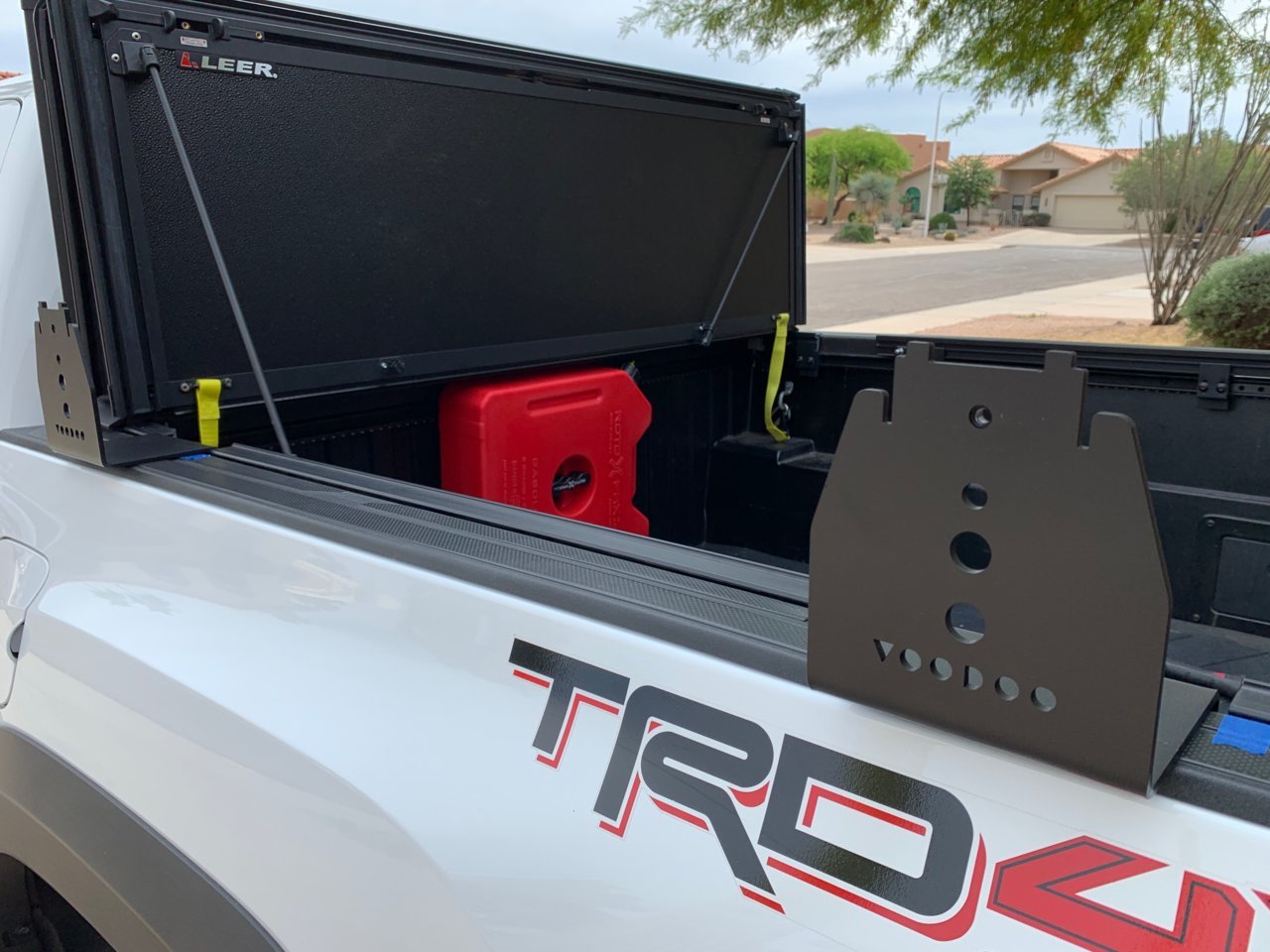

    I've got this setup and it works well. Be aware that you WILL have to cut the LEER rails and get extra clamps from LEER to make it work. Here are some pics:

    ^ Looks clean!

    That is super helpful thank you!! Did you just use a metal saw to cut the rails? And did you order the clamps separately from leer or did you order them with your tonneau?

    Yep, I have a friend who has a complete metal shop setup, and he cut them for me. I wouldn't want to do it with something like a hacksaw though. The rails are pretty robust. As for the extra clamps, I contacted my dealer about buying some extras and they contacted LEER. This was about 3 months after getting the tonneau. LEER sent me an entire set of clamps for free. Nice.

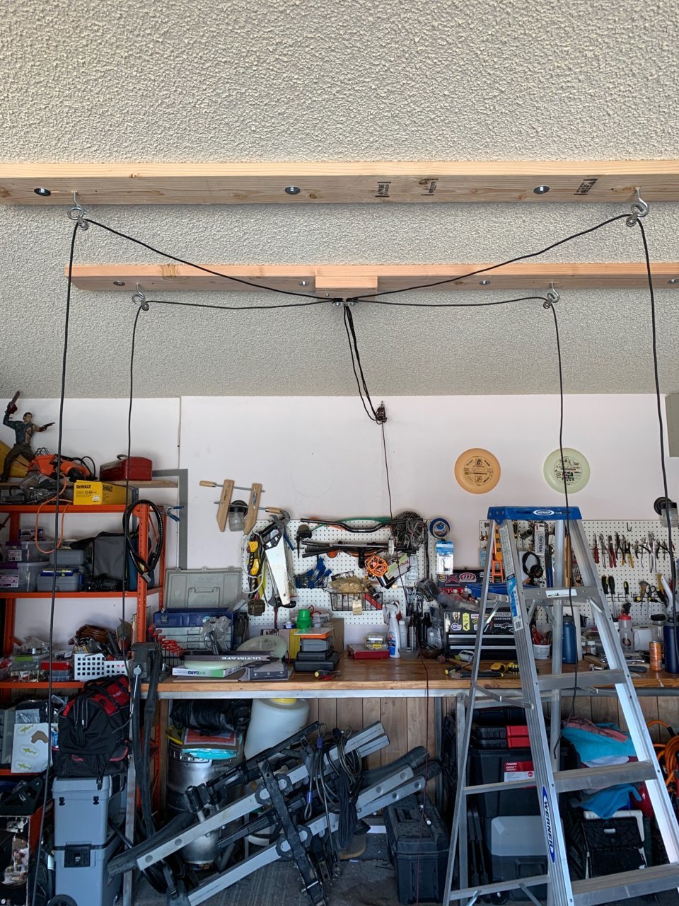

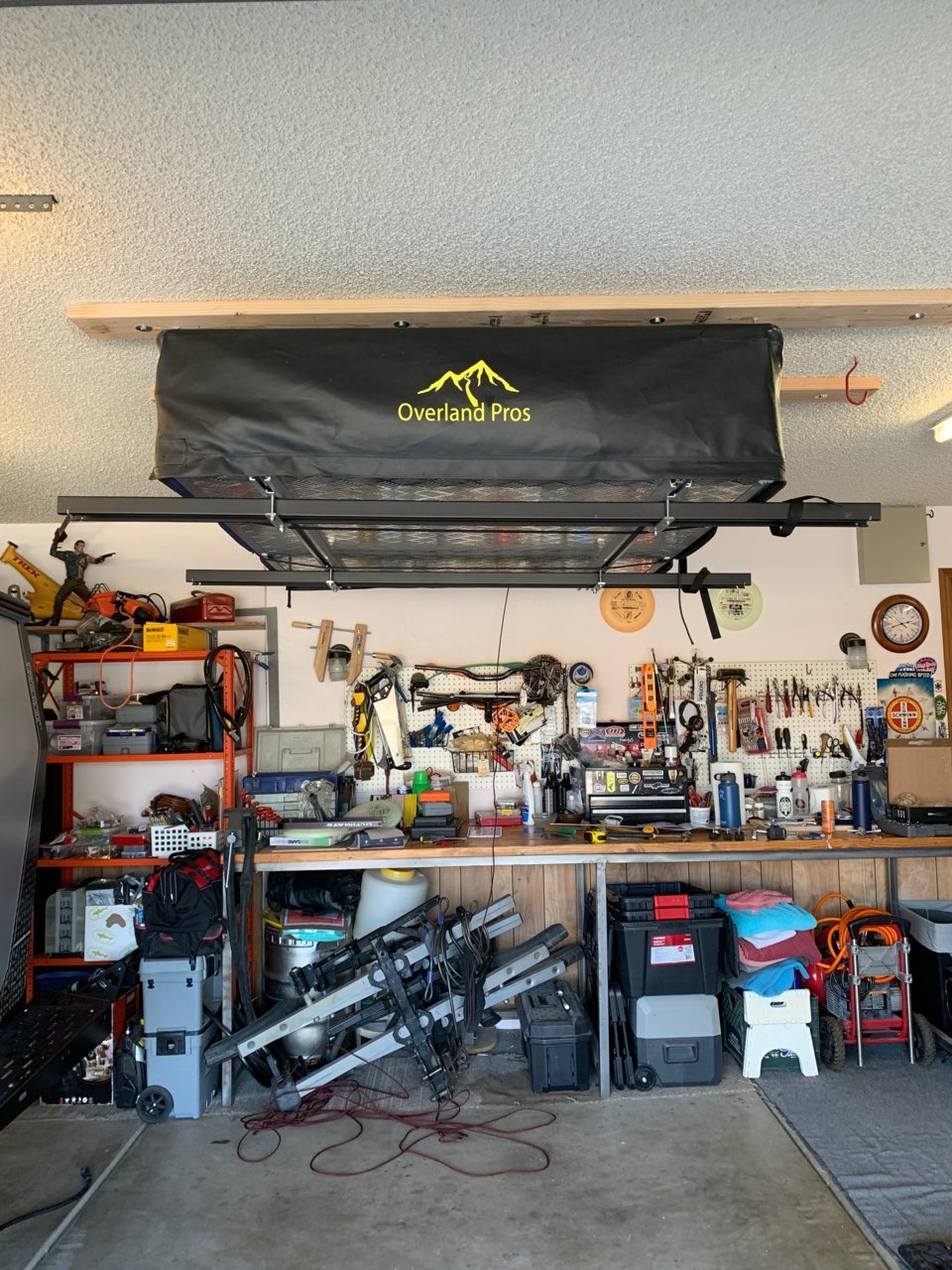

    Forgot to mention that I leave the KB Voodoo crossbars attached to the RTT and just hoist the entire assembly up to my garage ceiling. Back the Taco into the garage, attach the straps, and hoist. To load the tent up, just do the reverse. I've been super-happy with this system:

    So you got the tonneau before the bed rack? That's likely what I am going to do and cut the rails when I get the rack in. Good to know though, i've got some friends with band saws that I could get access to.
    As for your garage set up that's exactly what I want to do! Good to see people who have actually done what I am thinking about without me just shooting in the dark.
    Definitely going to pull the trigger on the LEER then. I've looked at other tonneaus and leer seems to have the best reviews / best quality out of the ones that work with the KBVoodoo setup.
