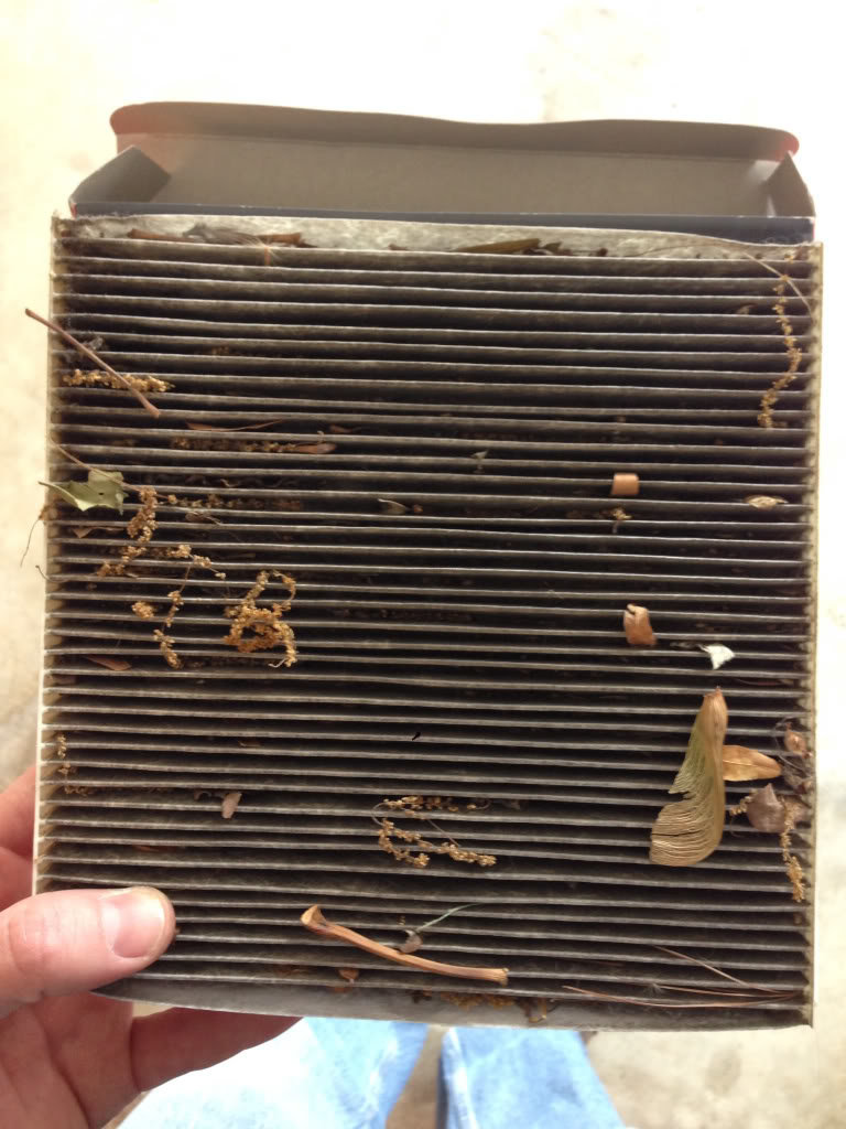

    45,000 miles :eek:

    ^^ Holy Shit...that's nasty! I need to change mine for sure.
