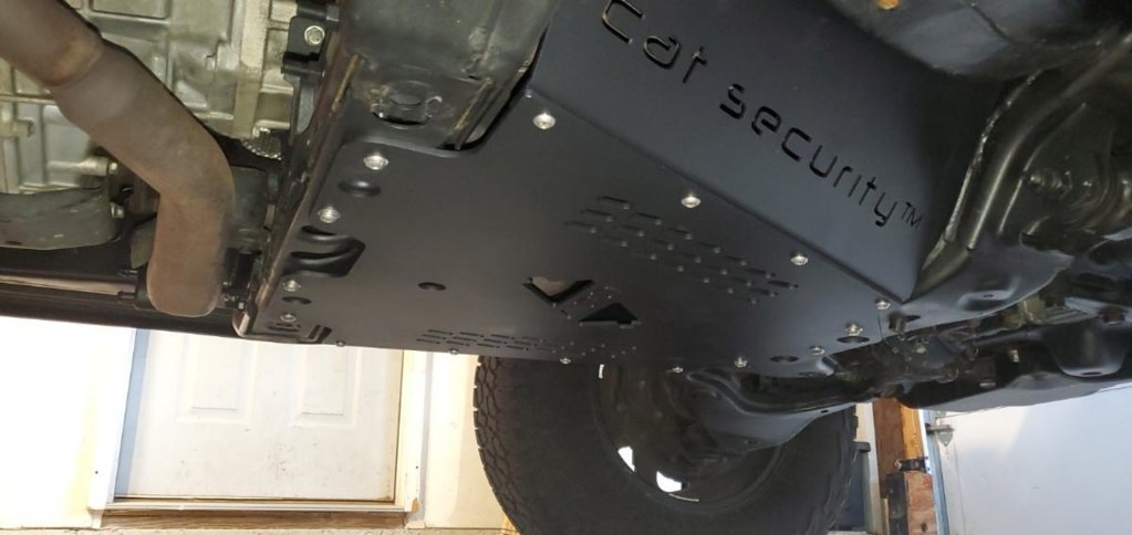

    Got my cat security https://www.getcatsecurity.com/c-tacoma-9 installed yesterday. Went fairly smoothly. Only 7/16" drill bit I had (4 new holes for threaded anchor nuts) was long so I had to jack up the front end a bit so the drill would fit between the ground and frame. Anyway, seems like pretty nice hunk of metal and should deter thieves enough to move on.

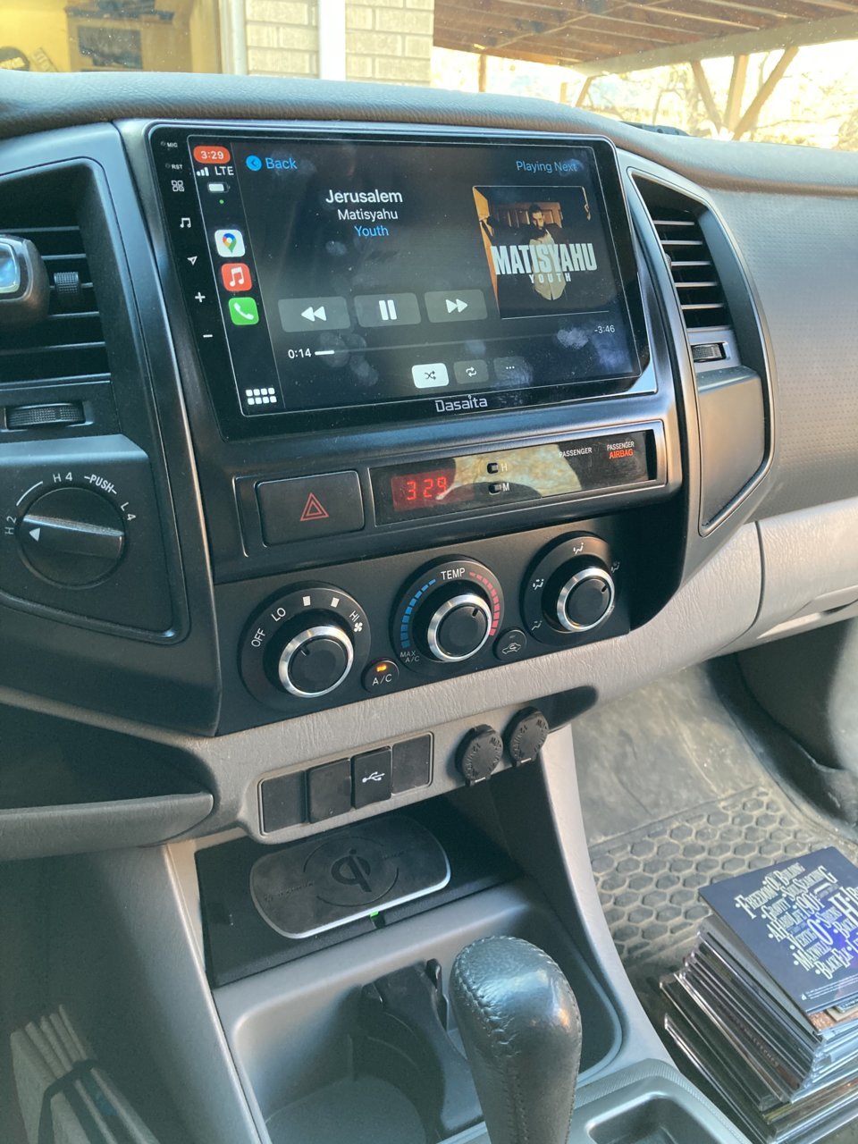

    Next Project Goal:
    Estimate $400 total in parts and shipping costs.
    Supplies needed:
    Ordered - $43, Scosche dash kit TA2111B,
    https://www.amazon.com/dp/B00FK1UZSQ?ref=ppx_yo2ov_dt_b_product_details
    Ordered - $90 shipped, Black A/C Heater controls from 12-15 tacoma https://www.car-part.com (search heater a/c contols)
    - $85, Black hazard button / clock unit https://www.car-part.com (search clock)
    ..........- 55900-04070 /w Bluetooth (Gloss)
    ..........- 55900-04090 w/o Bluetooth (Flat)
    Received - $106 shipped, Black dash vent surround (05-11 model) from ebay, p/n 55670-04020
    https://www.toyotapartsdeal.com/oem/toyota~panel~instrument~cluster~finish~center~55412-04060.html
    Ordered - $29 shipped - $3 and $4 each 2x plus $15 shipping, Wire harness connectors https://www.easternbeaver.com/Main/Elec__Products/Connectors/NH-025/nh-025.html
    ......... - 16 position NH025 Female, 16P025NH-F
    ......... - 12 position MT090 Male, 12P-MT090-M
    Ordered - $49 including tax
    Crimpers $16
    https://www.amazon.com/dp/B07G98DLB8
    Wire $14
    https://www.amazon.com/dp/B07TGJGJGD
    Pin removal tool $16
    https://www.amazon.com/dp/B0922GF9W8
    Still need to source:
    - Daisita HU
    For future reference:
    Black A/C control panel thread:
    https://www.tacomaworld.com/threads/black-climate-control-swap.655341/
    Wiring harness build:
    and these are the connectors:
    Are pins included?
    Options:
    9" head unit bezel for ATOTO HU's: https://www.amazon.com/YOFUNG-AC-TYTM02X-ST-Installation-Mounting-Compatible/dp/B097PB68Q8
    Android HU: https://www.amazon.com/dp/B0B2DP4YD...43e&s=car&sp_csd=d2lkZ2V0TmFtZT1zcF9kZXRhaWwy
    Oddity to note from anothers truck: So my non-electrically-savy self figured out a hack on mine, but YMMV. Since doing the swap, everytime my battery is disconnected for any longer than like 30 seconds or a minute or so, the AC button doesn't work when I turn the truck back on. What worked for me was removing the new AC panel, plugging in the original 2006 AC panel, turning the AC on (which then functions perfectly), removing the 2006 AC panel, and reinstalling the new AC panel. This seems to make the system recognize the new AC panel or something, idk, but it works for me.

    Started on the black dash finally. Ordered the black dash vent surround. Found one on ebay in excellent condition for $87. Should be arriving next week. Next is to find a black hazzard button/clock assembly and the hvac controls.

    Vent surround arrived last week. Looks to be in great shape. Just cleaned out the dust from the vents and good to go. Couple days ago I ordered a new dash kit from Amazon (TA2111B) for the HU I already have. Maybe not doing the Dasaita HU right away. Also, today ordered a HVAC contol unit from car-part.com. Once that arrives, I will look into the wire harness and make sure I got that harness built and working before I order the clock/hazzard button unit. Too bad the button isn't removable as it's the only part that is not black on the whole assembly.

    Ordered the wire harness materials on Amazon today and should be receiving the dash kit for double din HU today.

    Messed up and ended up with 3 different dash kits. 2 for the 2012+ which don't really match up with the vent surround but I like how they look better and one that's for the earlier 2nd gen but has the dimples.

    Sent out new climate controls and clock to swap out the white leds for orange to match the rest of the dash.
