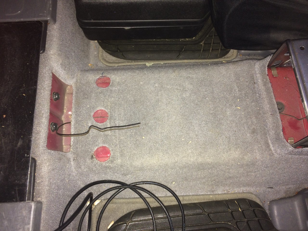

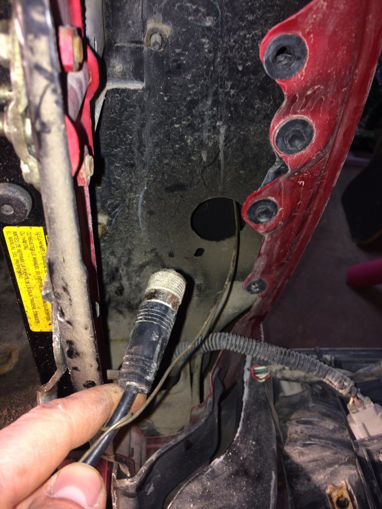

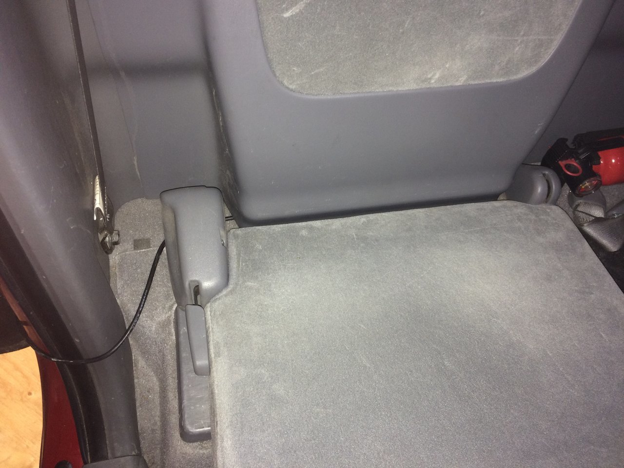

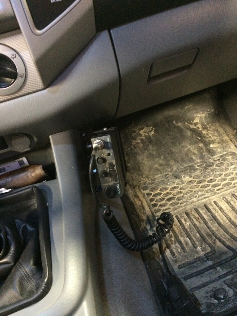

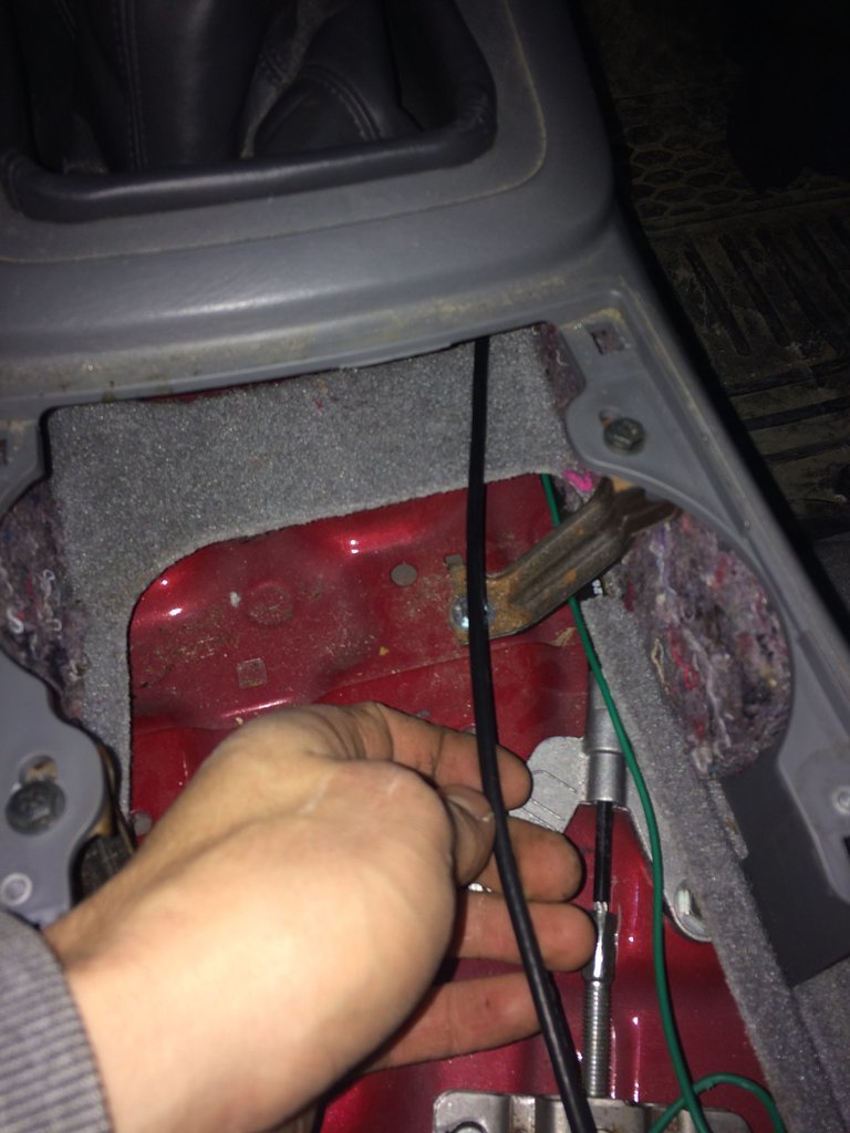

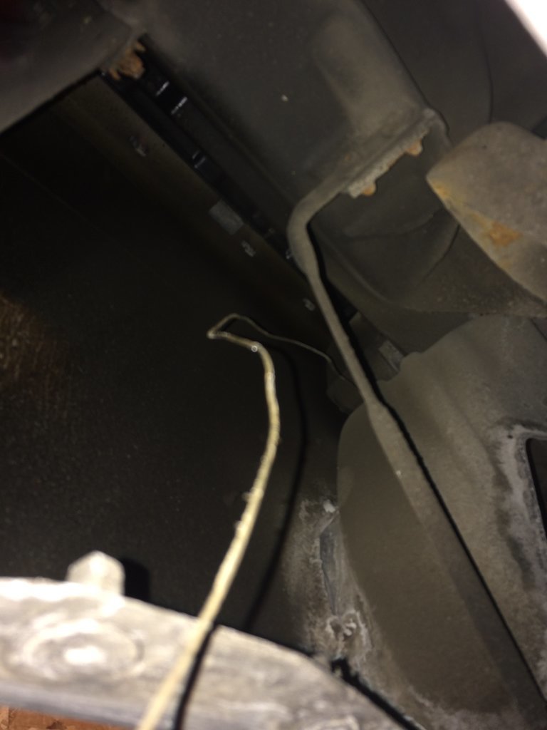

    I think it could be interesting to share the way I wires my CB coax to have it out of view
    - First I pulled out the passenger side tail light
    - I took maybe 6' long of steel wore and attached it to the coax and ran it inside the fender pannel, until I see it by the 1/2 door of the cab.
    - I decided to take it in the cab by the 1/2 door since I was too lazy to crawl under the truck lol
    - I ran the wire behind the jumper seat and, since I removed the back centre console, I was able to hide it under the carpet and run it to the front center console.
    - I took the coax straight to the front, still under the console, and pulled it out on passenger side, where the feet are, and connected it to the CB.
    Took maybe 1/2 hour and makes a clean install IMO
