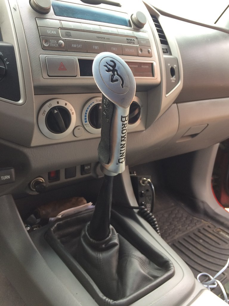

    Because I talked about it yesterday I had to do it today. Swapped my oem shift knob for the Browning Pistol grip. I had it before but the summer heat softened the plastic sleeve and it stripped on the steel tread of the shift stick so i put the oem one in the meantime. Today I used silicone hot glue and I glued it back in place. That glue is strong enough to hold the summer heat but soft enough so I can break it with hands to take off the stick in case I need to remove the center console

    How did you get your boot like that?! That's what I was going for, but it didn't work out too well.

    I gotta admit that pistol grip has some old school/muscle car look to it. Would like to tear through some gears with that!

    haha I popped the ring and tried to roll the end of the leather inside, which worked a bit and then I slid it lower lol
    I really like it! And with the @Gadget@URD short throw shifter it makes the driving experience really better!

    I bought this one from a friend but they seems to be available online too. I used it in my old 90' toyota pickup and then I use it in the taco. I think price is around 20$, which is decent. The knob sits higher, and the short throw kit lift the shift stick 1", so now the position of my hand on the knob is pretty comfortable.
    I wish I would a bought the Hurst short throw with the shift stick tho, the Hurst one looks like it is really made for the comfort of the driver! And a round ball seems to be really comfortable.

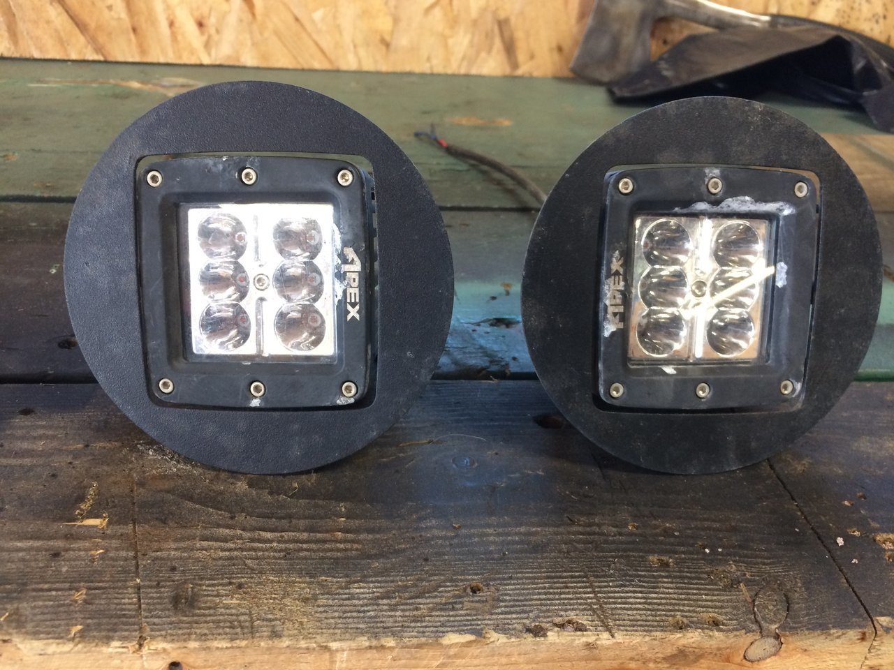

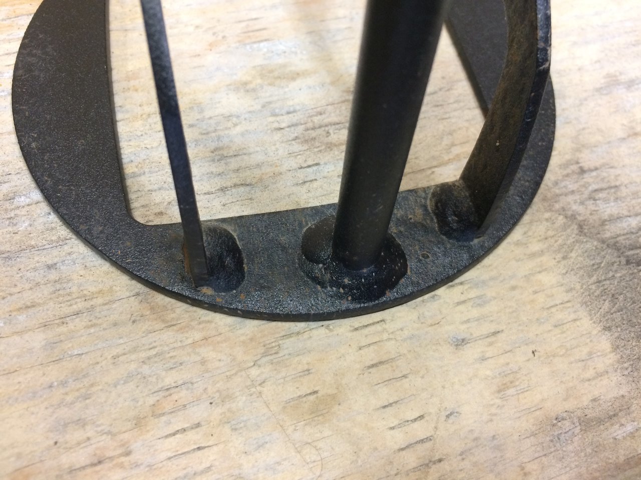

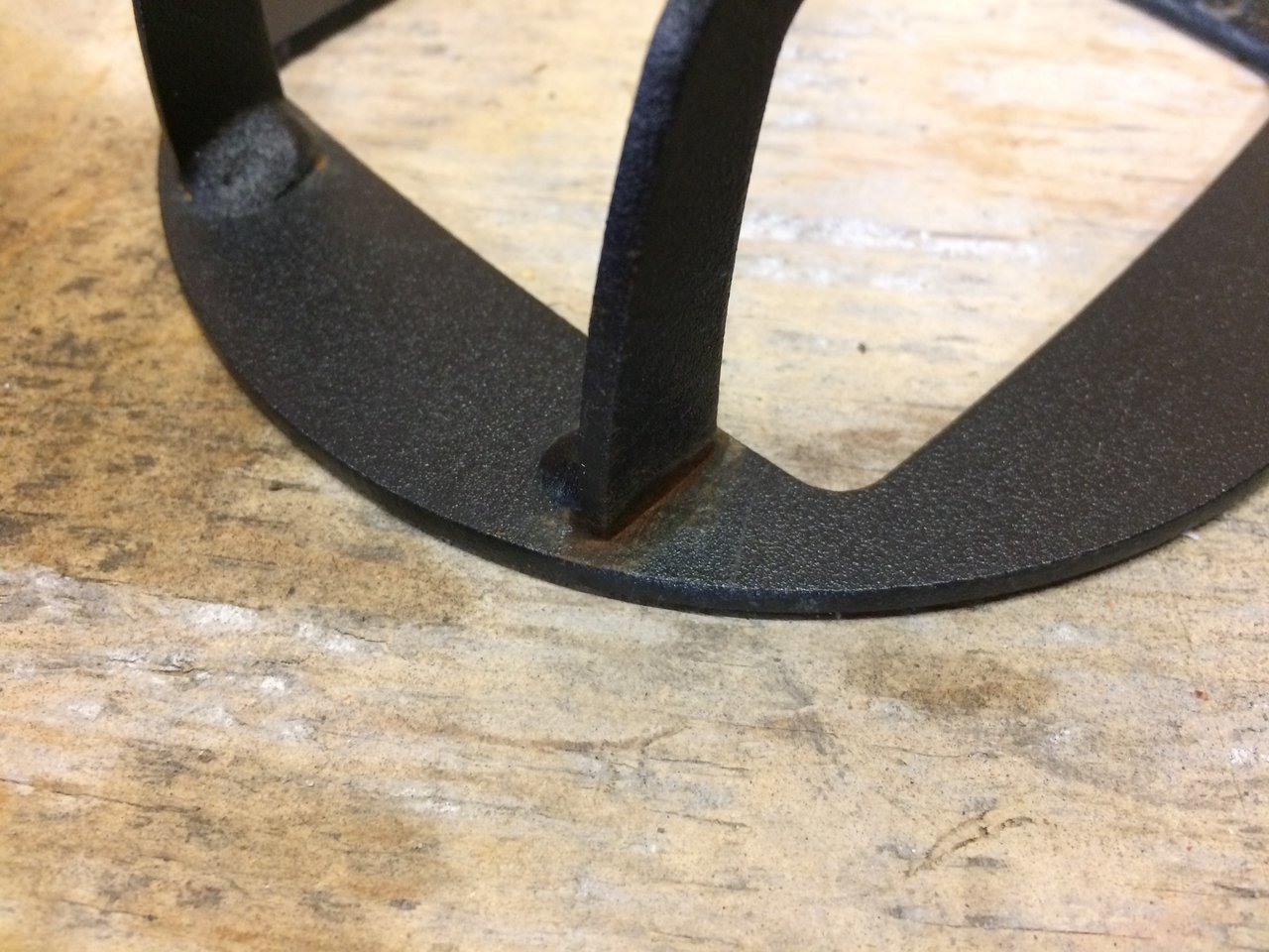

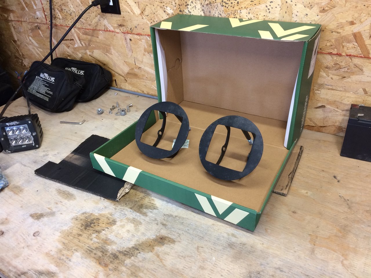

    Today I went ahead and remove my Apex led for light bracket to give them a little paint coat. The powder coat on it seems to be pretty thin, and rust was noticeable under the coating. I set them up in my home made spray booth and gave them a great coating of paint. I'll let it dry a few days and will put then back. It will also give me the opportunity to do my wiring better than it was.

    Are you going to do the pods also?
