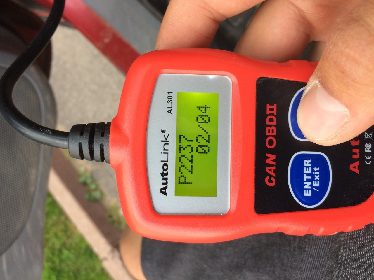

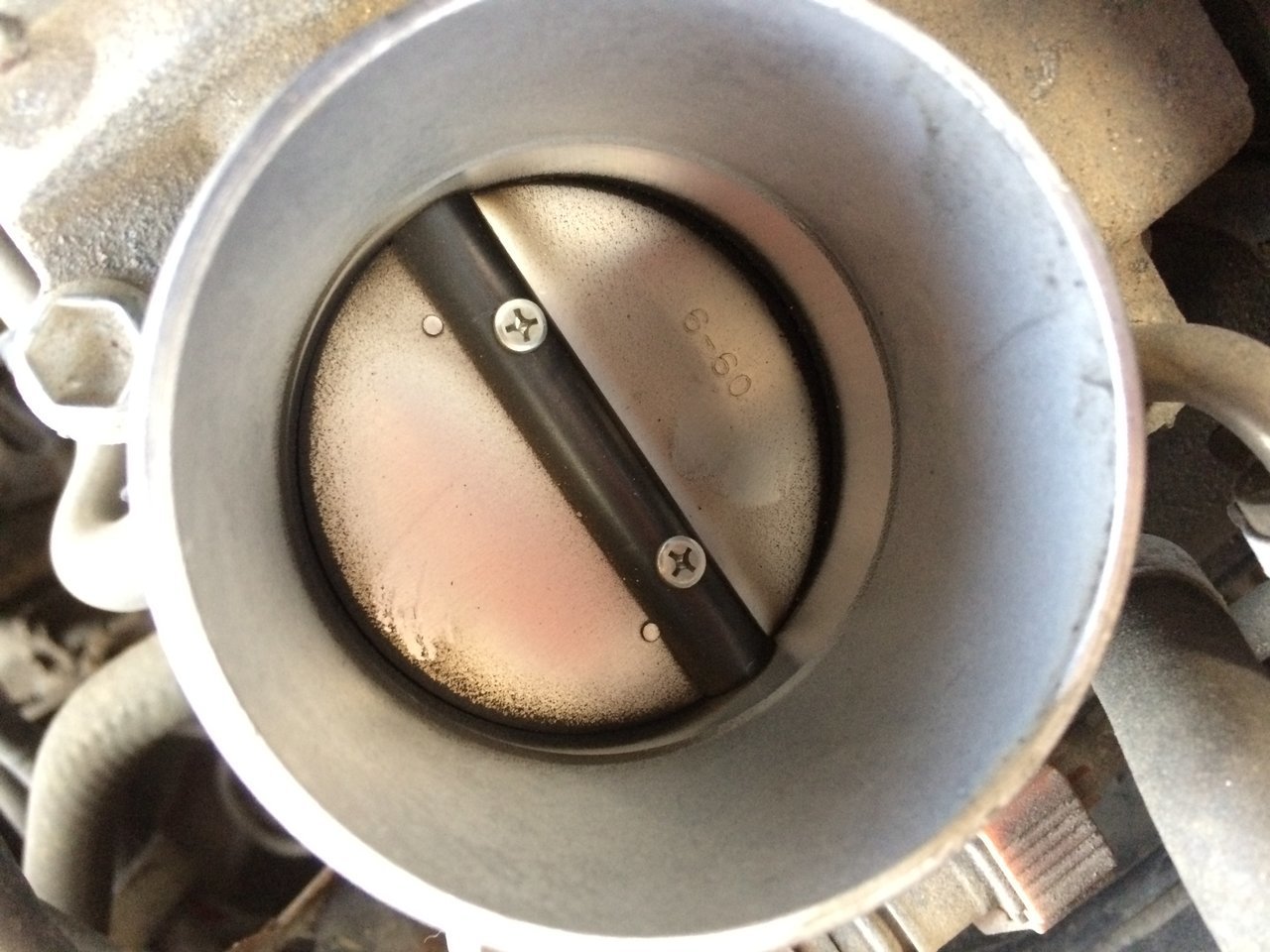

    A few days ago my engine light came on, with the little sliding truck logo too. It happened to me before, when I bought the truck, and got the O2 sensor changed under warranty. Now it's been 3 years since and the light is on. Took me a few days before using my scanner to see what it is. It had 3 fault codes, which are all related. P0031, P2237 and P2238. I erased them, but the light came on again this morning. According to TW, it something related to O2 sensor or maf sensor... so I went ahead and cleaned my maf with electrical cleaner, and also did my throttle body. The TB was pretty dirty! After the cleaning, I scanned the code again, but this time there was only one fault (P2237) I'll do my homework to find what it is. I also erased it again and will see if it comes back tomorrow with the maf cleaned. I hope not!:fingerscrossed:
