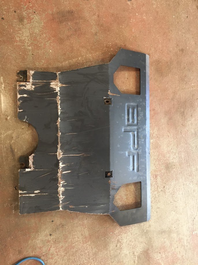

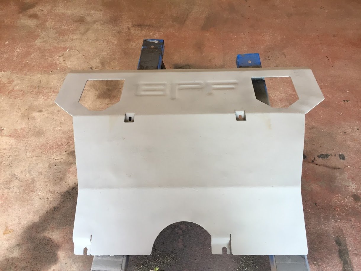

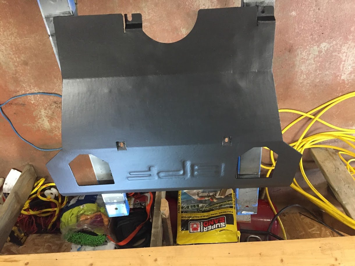

    Took care of @Bocsy44 BPF skid plate. grinded it, heated and hammered it back to something close to straight, then sprayed some "cold galvanized" stuff and then painted. Still on the work bench waiting for another coat of paint.
    UbVj-hXpn30isFE7xQ4eyDuPZf1bWS9vo8EijRox_532beae679b68a4d70568a899d979e3d768a2c4f.jpg
    2SRwk_2W8PhsvLM5KMXVrjK08mj6wI1ek3DXrOMn_c15b2a0a6c30e1a8f726a7678c2defe1ec8b9c6e.jpg
    NNx7d9ynLlYPGxHcnmeroF90xZAJaEW83LxfvtKK_12cc5bd3fc2f63206f3bc7a721ed650f13131630.jpg
    Yeah I know, upside down lol

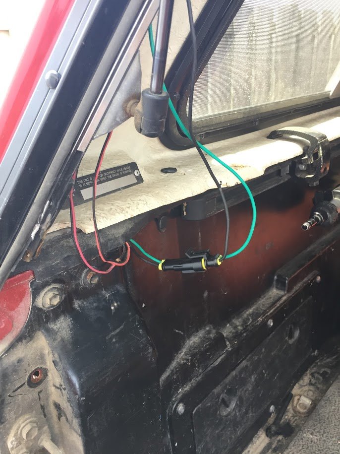

    Then I added connectors to my leer cap lights so if I have to take it off, I won't worry about wires

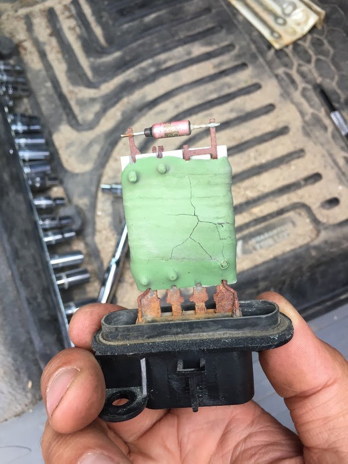

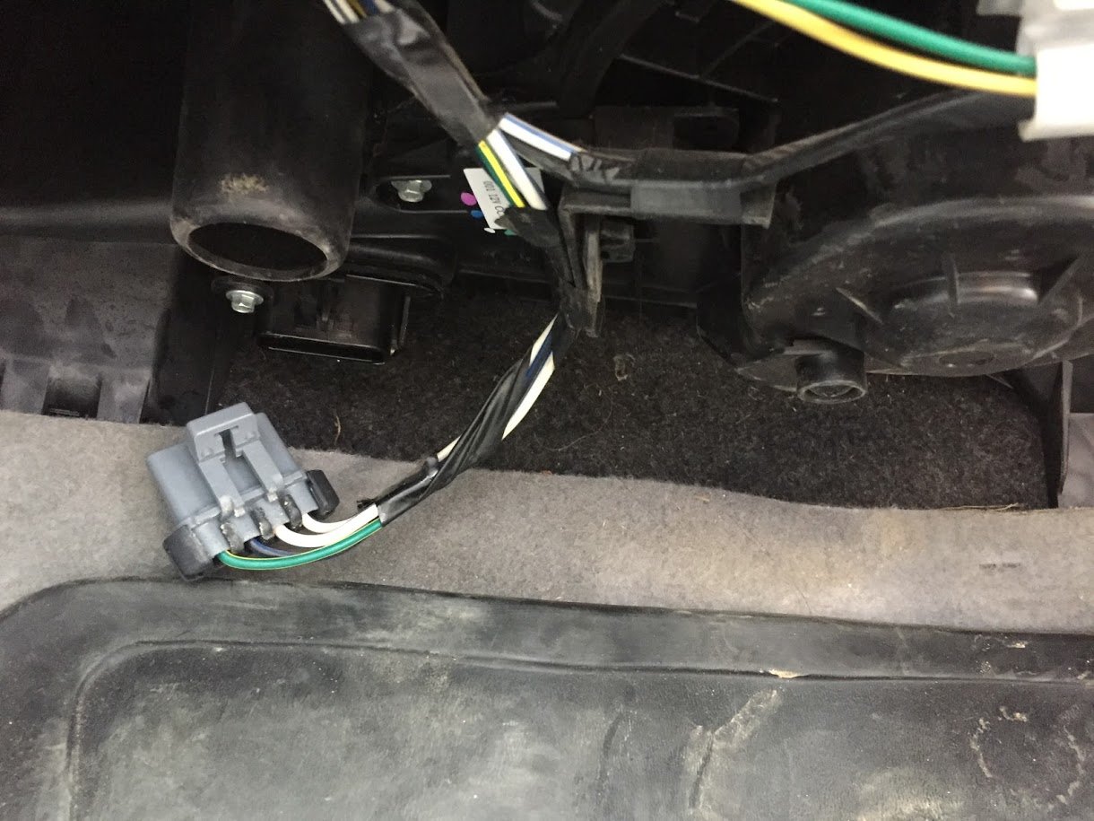

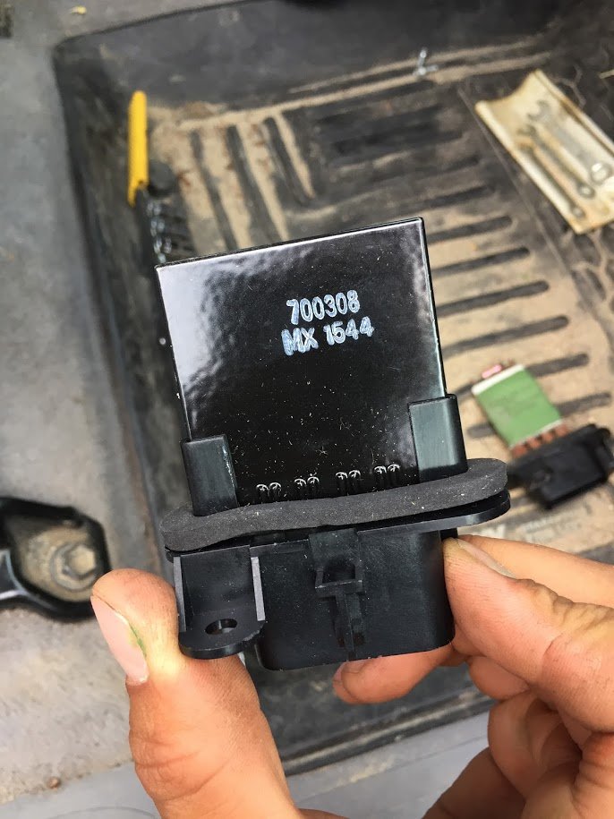

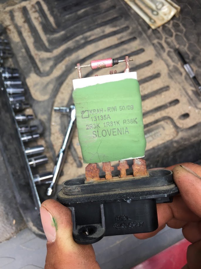

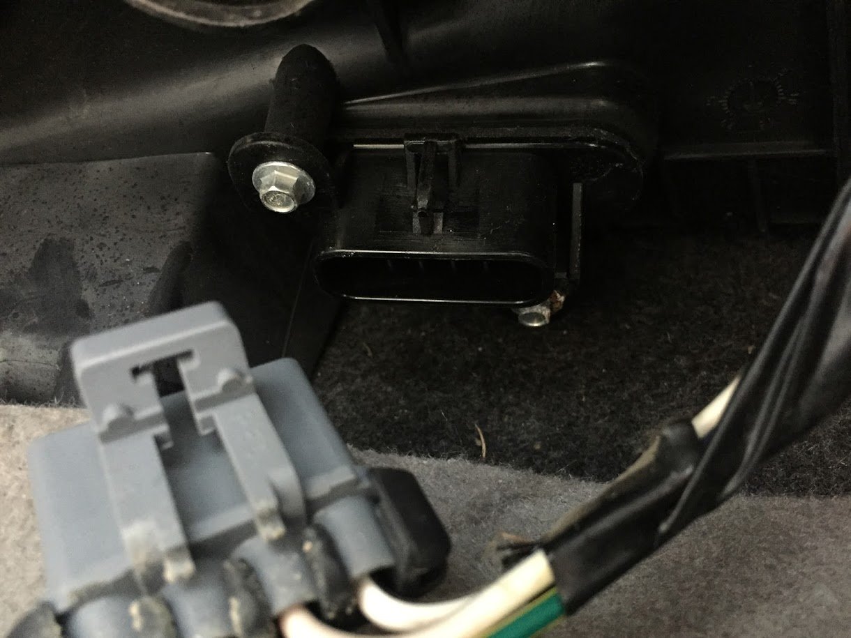

    Last Thursday I noticed that my HVAC fan was only working on the 4th speed. quick search on TW and it is my fan resistor. Ordered the resistor through my local part store and changed it today after work. Problem solved!:cool: Thanks TW!

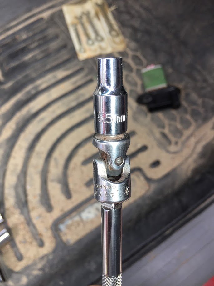

    First time I use that 5.5mm socket lol also, that wrench u joint is a must to reach those small bolts

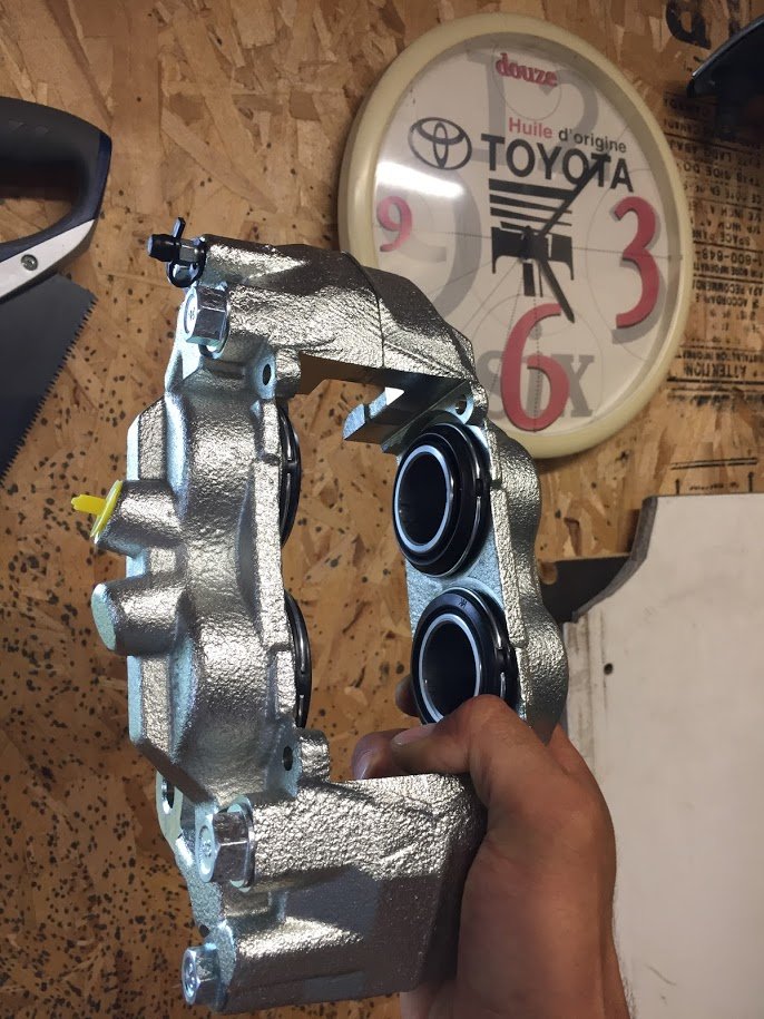

    I also got tire of my truck pulling left when braking, so I bought the right caliper and plan to change it sometime soon. stay tuned!

    Kemo do you have details on the cap wiring? I need to replace mine and re do it but the dealership disconnected everything so not sure what wires to splice to

    I dont remember which wire but I can to think about poping the tail light and take a few pictures. I remember having tested the wires with a test light to see which one get power with parking lights on (send it to the inside light of the cap) and which one get power when braking (send it to the brake light, obviously lol)
    Saying that, I noticed that my cap braking light don't work anymore. I tested the wire after the quick connect and there is power going through, so I'll have to get another light...

    I tapped the shell brake light with the blue wire of the braking light harness. The inside cap light is tapped on a wire I ran from the battery/switch/relay for my rear lights, so not tail light related.

    6,200

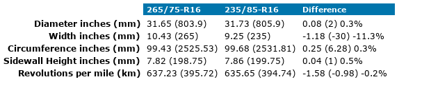

    I was talking with a buddy after work. He is the guy who showed me the secret lake to fish arctic char. The trail to get there is really fun, and no car can go. 4lo is a must to climb a few hills.
    Today he talked about another lake he used to go, but not anymore since it is harder to get there than the other lake. Says it takes 2 trucks, or a winch. Fish are bigger tho. I.Need.To.Go.There :D
    Also need higher tires. Seriously considering 235's pizza cutter in general grabbers AT's.
    I may try my skills and fab skids to complete the BPF i have. Winter garage project

    The LCA BJs are weird. We did them in one truck with absolutely no issues. Then on another truck, we used the same exact BJ removal tool, but it was a smidge too big and wouldn't work. Hopefully you don't have that issue like us!
    That sounds fun! And the fact that people can't really make it there will make it very secluded. Why 235s though? They're only +1" over stock. I think 265/75r16 would look better being a little wider but the same height.
    But what you should REALLY do is some 255s :D Those are awesome.

    I am lost in that tire thing. I am pretty set on 235's because they are higher (a little) and with less surface on the road they should be better on mpg and power wise. I am scared that 255's would kill the little power I have lol. And there aint that much choices in 255's around here. If I go that size, i'd get KM2, but I'd rather have AT's
