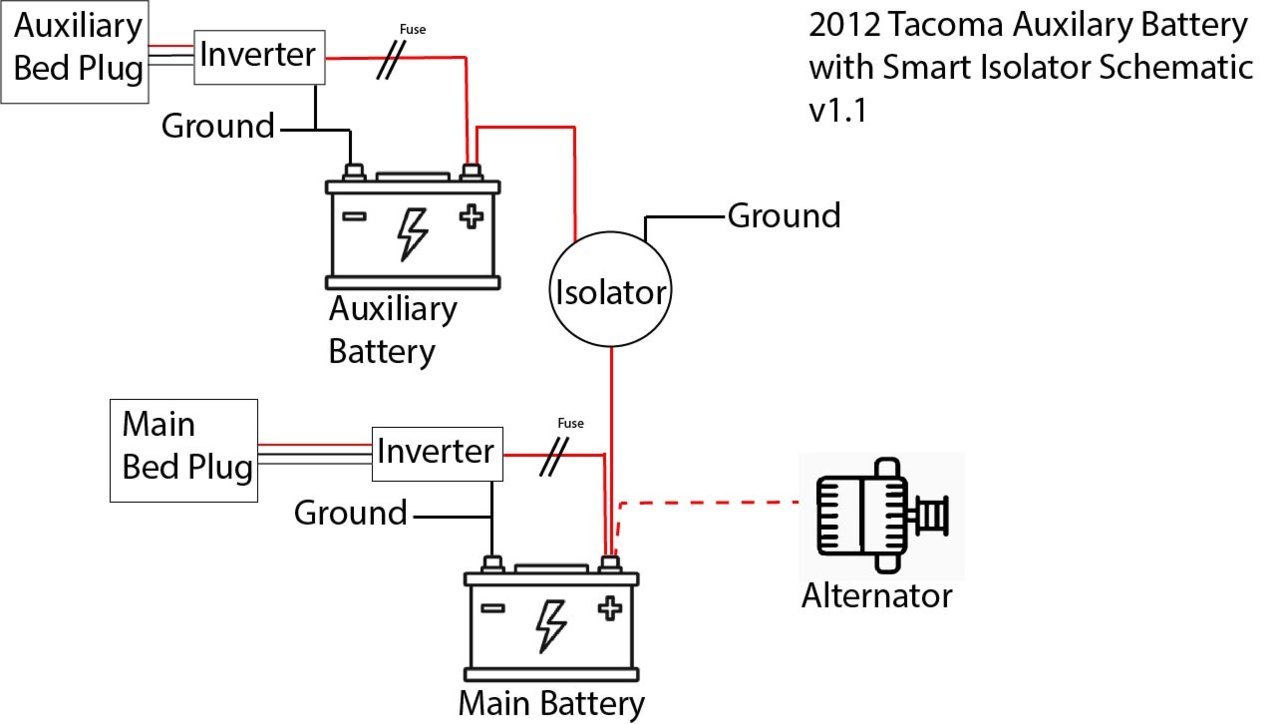

    Thanks! How's this? I added wires and grounds for the inverters and fuses where I guess they should go. Positive current in red, negative in black, neutral in gray.
    I am considering the KeyLine Iso-Pro140 Smart Battery Isolator for its simplicity. Is that a good choice?
    Would this design allow me to jump the main battery using the auxiliary battery should the need arise?

    The fuses need to be as close as possible to the battery. The wire in between the battery and fuse is not protected by the fuse. So we get mount them close to the battery.
    That kit is basically a voltage sensitive relay similar to the blue sea.
    however I do not see a “jump” feature available. This unit will only connect the batteries when it sees charging voltage. There doesn’t seem to have a link override

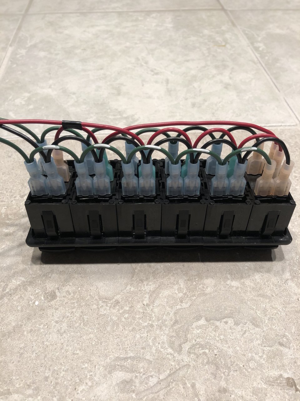

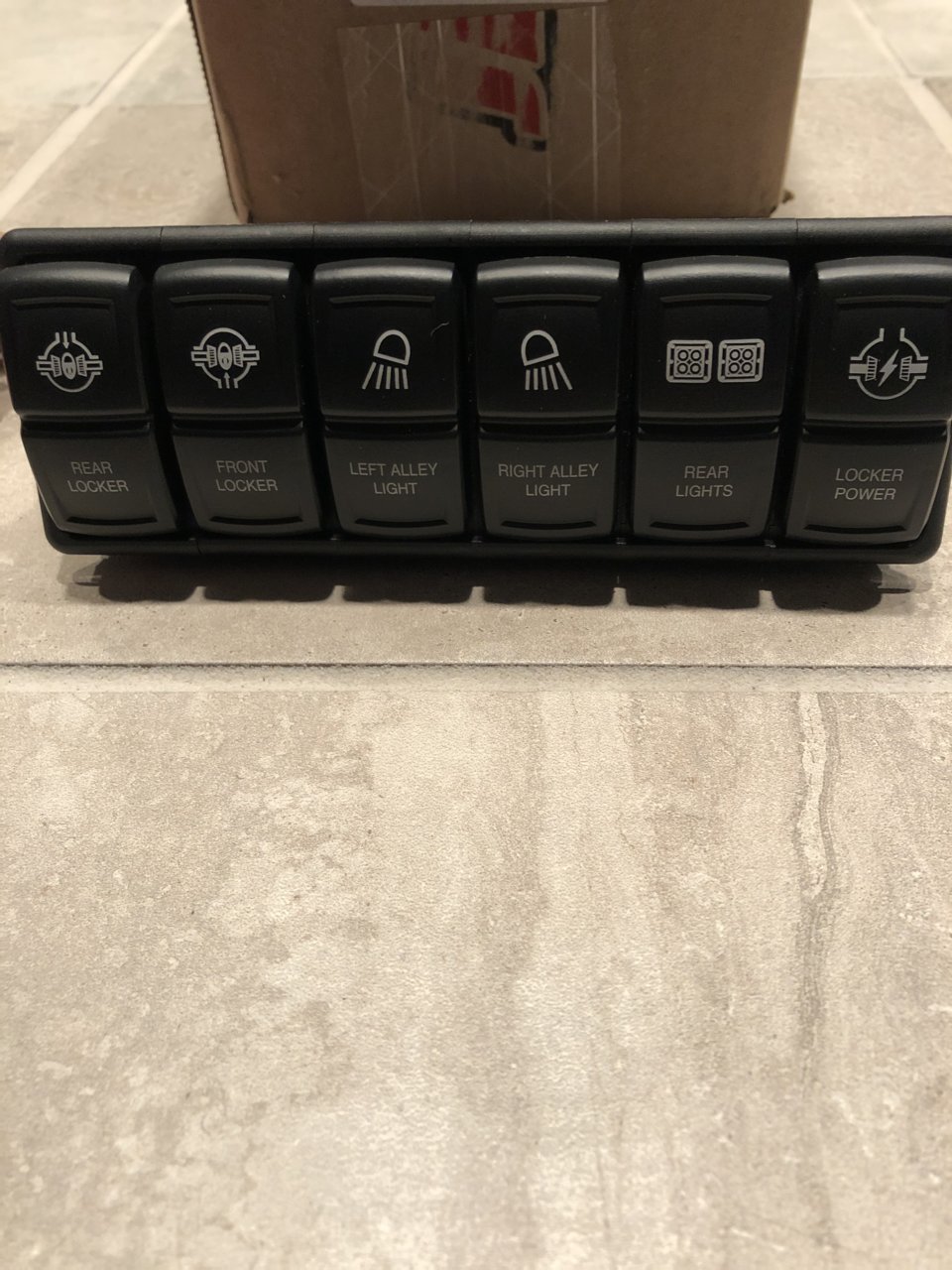

    Thanks for your help. I wired things up except for the accessories and checked my work. Switch power works and the locker power switch has to be on for the locker switches to be live. The upper part lights when the switch is turned on and the dash light wires work too, lighting the bottom when the lights are on.
    E6988BDC-21B2-49F7-B591-17084D9C3E2F.jpg 875FA0FD-B9F5-4B85-A9F9-EF461DB3FB9E.jpg

    He’ll yeah brotha!! Those switches look really clean. Might have to make a change to my switch panel :thumbsup:

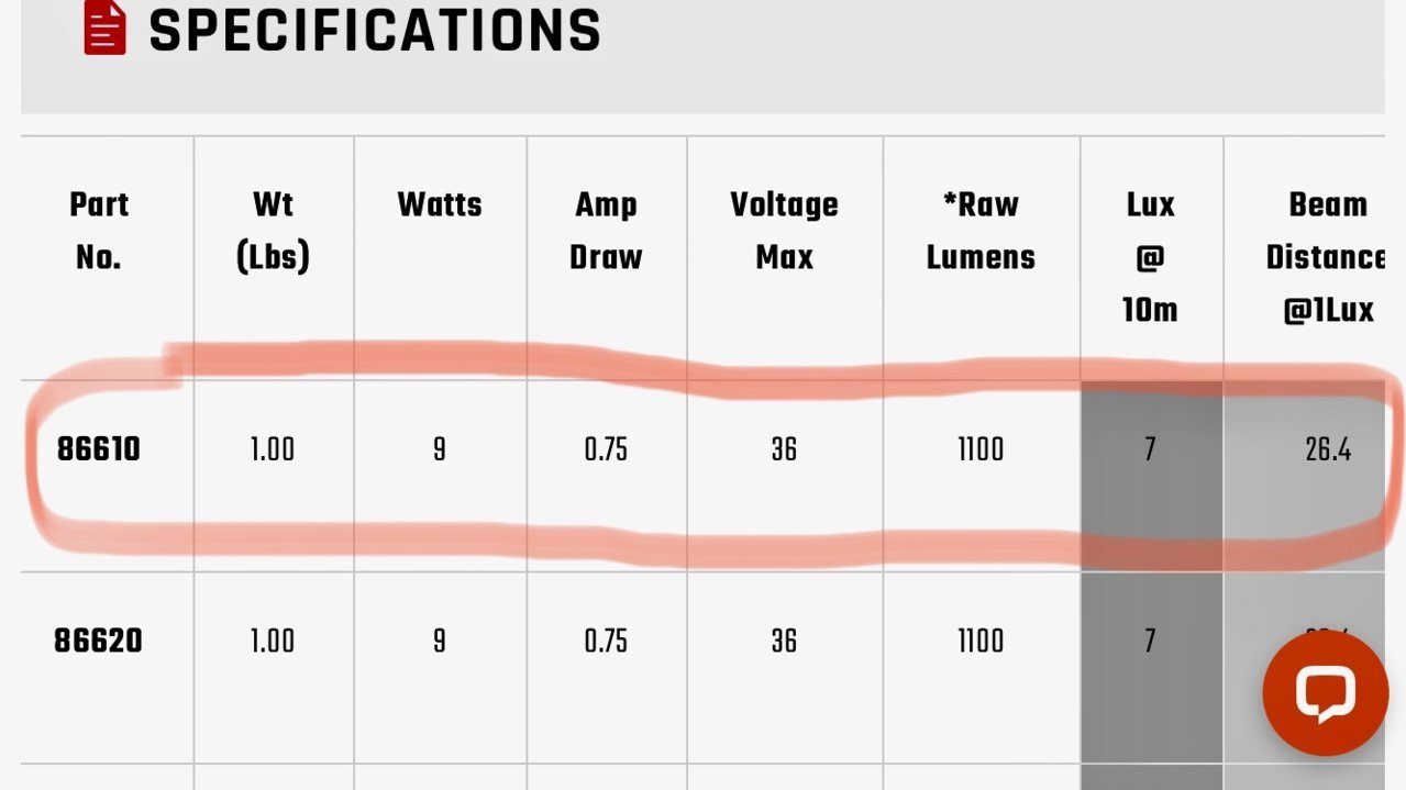

    Well it looks like I need to pick your brain one more time. I have 4 Rigid Industries scene lights (https://www.rigidindustries.com/led-scene-light-led-scene-light.html) that I’ll be wiring 2 per side and am wondering what size awg wire I should be running. I believe the wires coming off the light are 16awg. Also what size fuse for each set of 2 lights. Thank you!

    .75A x 1.5 = 1.125 ..... next size up is a 2 amp fuse
    16 gauge Is perfect.
    You also shouldnt need to relay these your looking at a 2.25 Amp draw most switches can handle this without even feeling it
    double check the switch max amperage spec because there are some tiny tiny ones that are like 1 amp

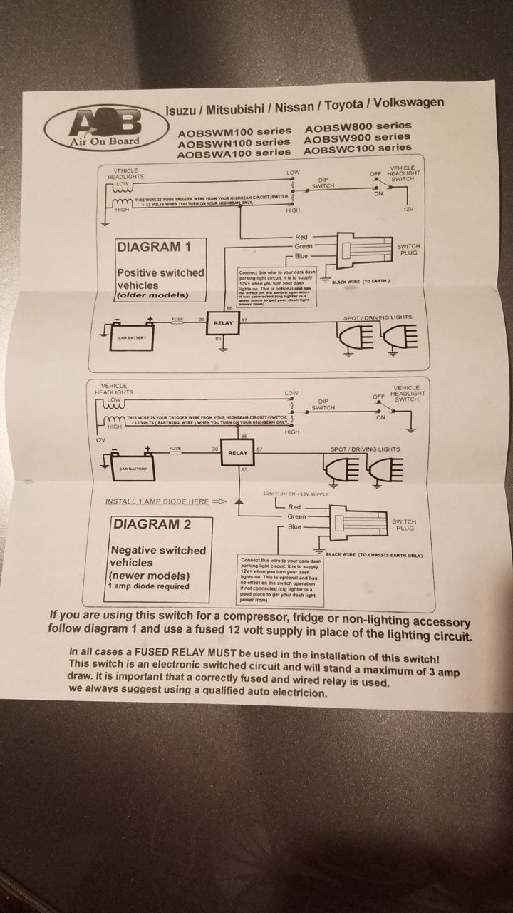

    This switch is supposed to illuminate the text when the dash lights are on, and the picture when switched on. Is there a way to wire it up so that it is illuminated entirely when the dash lights are on?

    not based off the document you linked. Sorry bud. Send me a pic of the back of the switch where that socket plugs into

    Memphis
    2018 DCSB SR
    It's just 5 unmarked pins in a straight line. I can get over the indicator. Any idea on which way to wire it up? I know black goes to body ground. I'm assuming on an 18 I'm switch negatively?

    I ask because your prewired switch socket may not give you every possible option of the switch.
    The led grounds may be connected internally and that 5th pin that’s not called out in the wiring diagram or there’s other options. There’s a way to test the pins to tell what does what or if you can get any number or marking off the switch we can look it up to see it’s internal workings.
    If you want I can walk you through how to find out what that extra pin is for

    Idk why the listing says light green. I have the same switch in blue, but that listing is now missing, so idk. Here's pictures of the back of the switch as well as some more information on it. Thank you for imparting some wisdom on me.

    From what I could find.
    The top led is paralleled inside of the switch with the switch output. We could wire it so when it’s ON both leds would turn on and then when turned off they both turned off. But with that style switch we can’t have both leds on with the switch in the off position.
