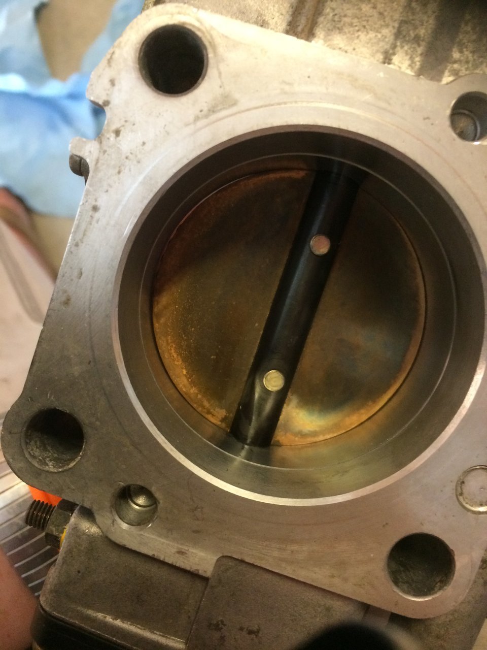

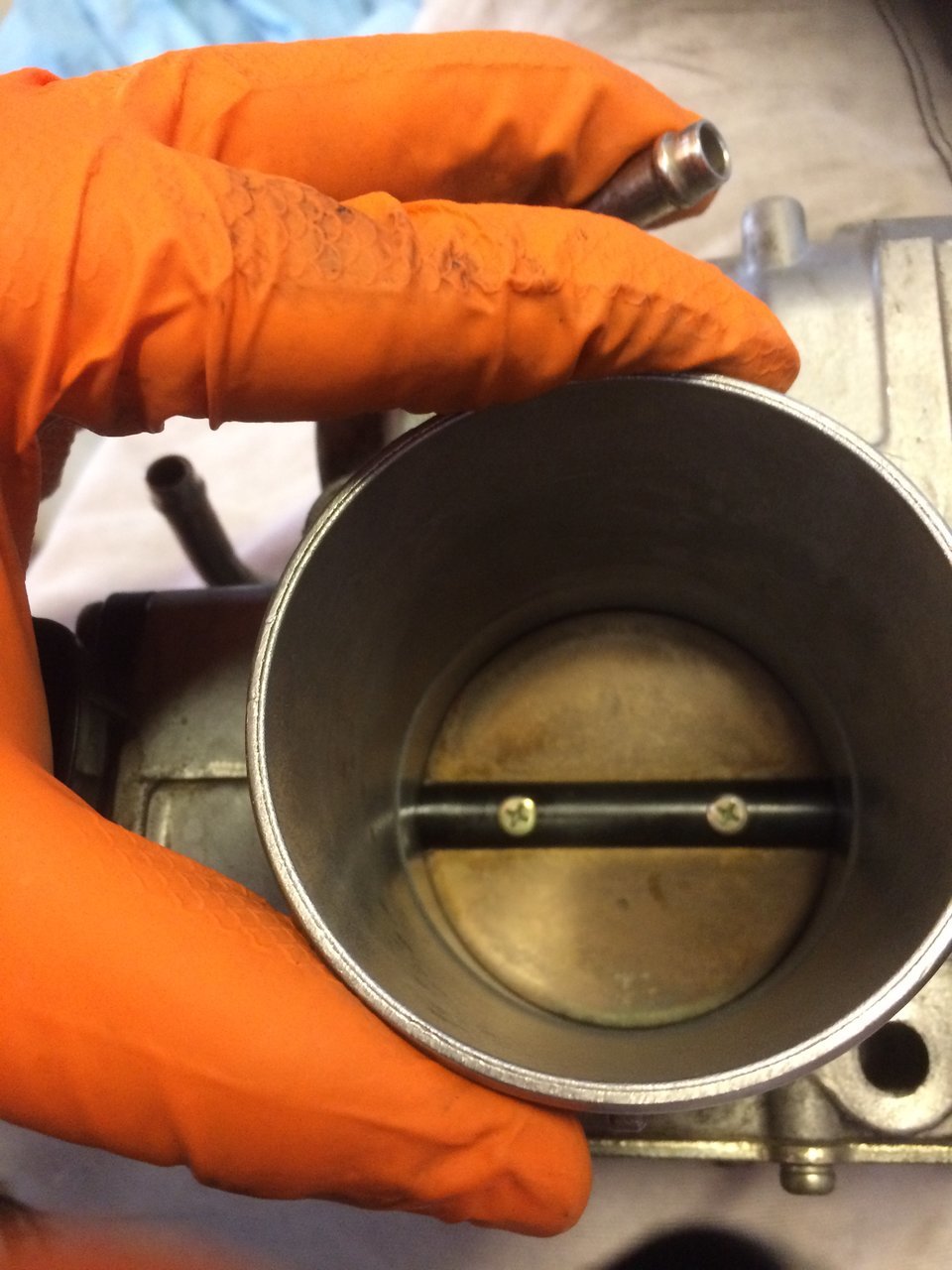

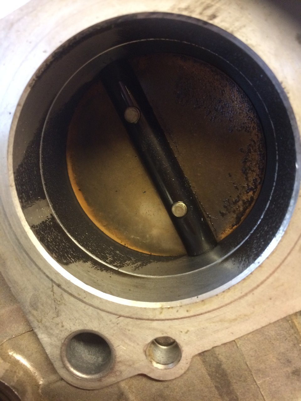

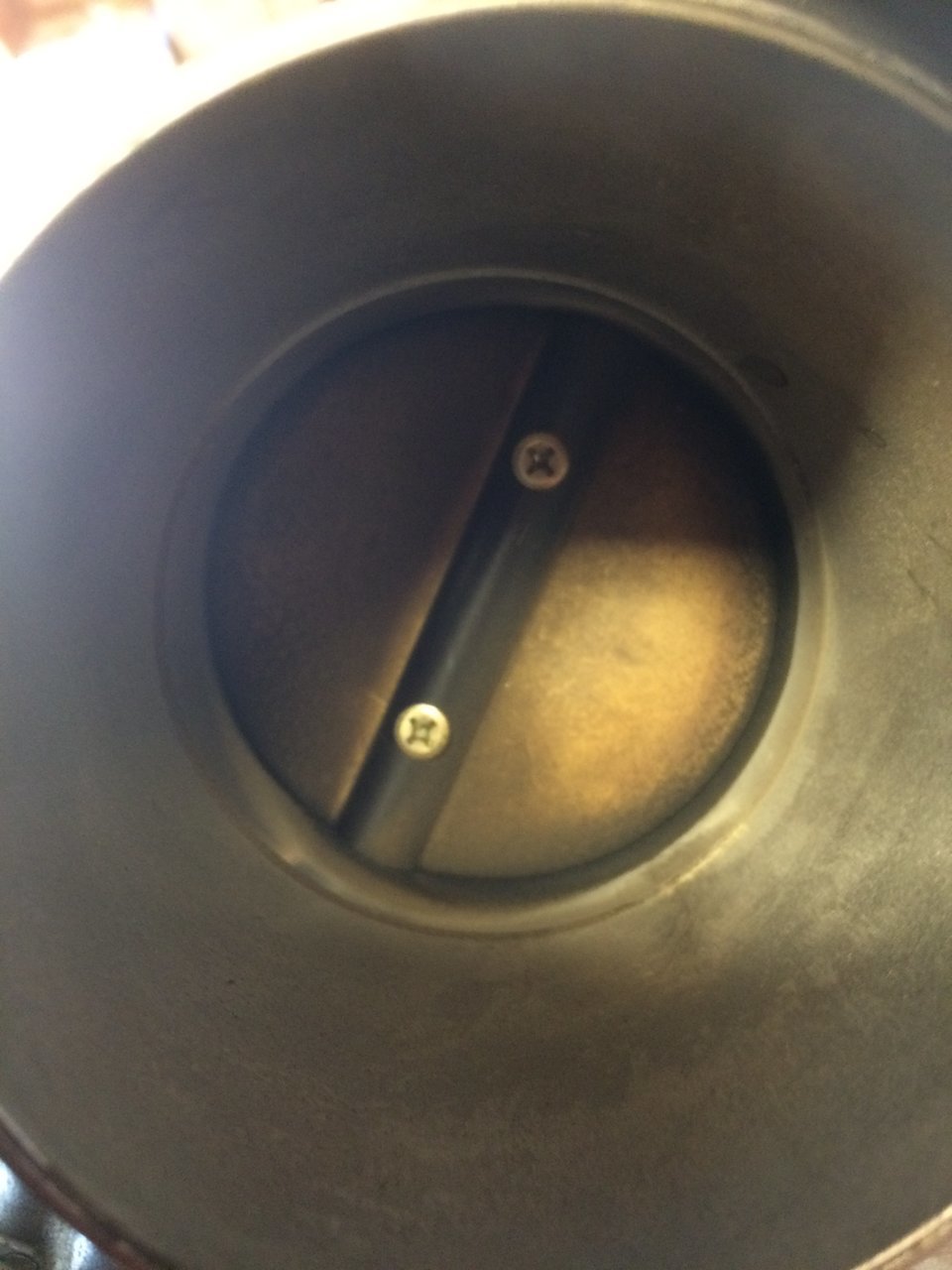

    IMG_1922.jpg IMG_1923.jpg IMG_1925.jpg IMG_1924.jpg Serviced my throttle body the other day because my truck was idling a little rough intermittently. Looks like this has never been done before because it was fairly dirty. Also since I'm fly by wire the truck doesn't have a IAC but small ports and a door which leads to a vacuum tube. When I took the 4 screws out to open to little hatch it had a bunch of debris in it. Glad I went ahead and investigated. Seems like it fixed the problem. I reset the ECU so it's still relearning but it seems a lot smoother

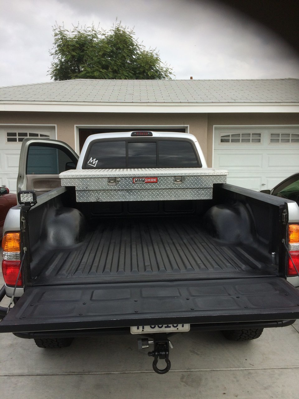

    IMG_1930.jpg I know doing your bed liner yourself doesn't get you as good as results. But man it sure is nice to make it look like brand new in 5 minutes and only costs 7 bucks
    (Ignore the tail gate) lol

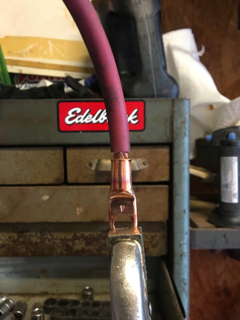

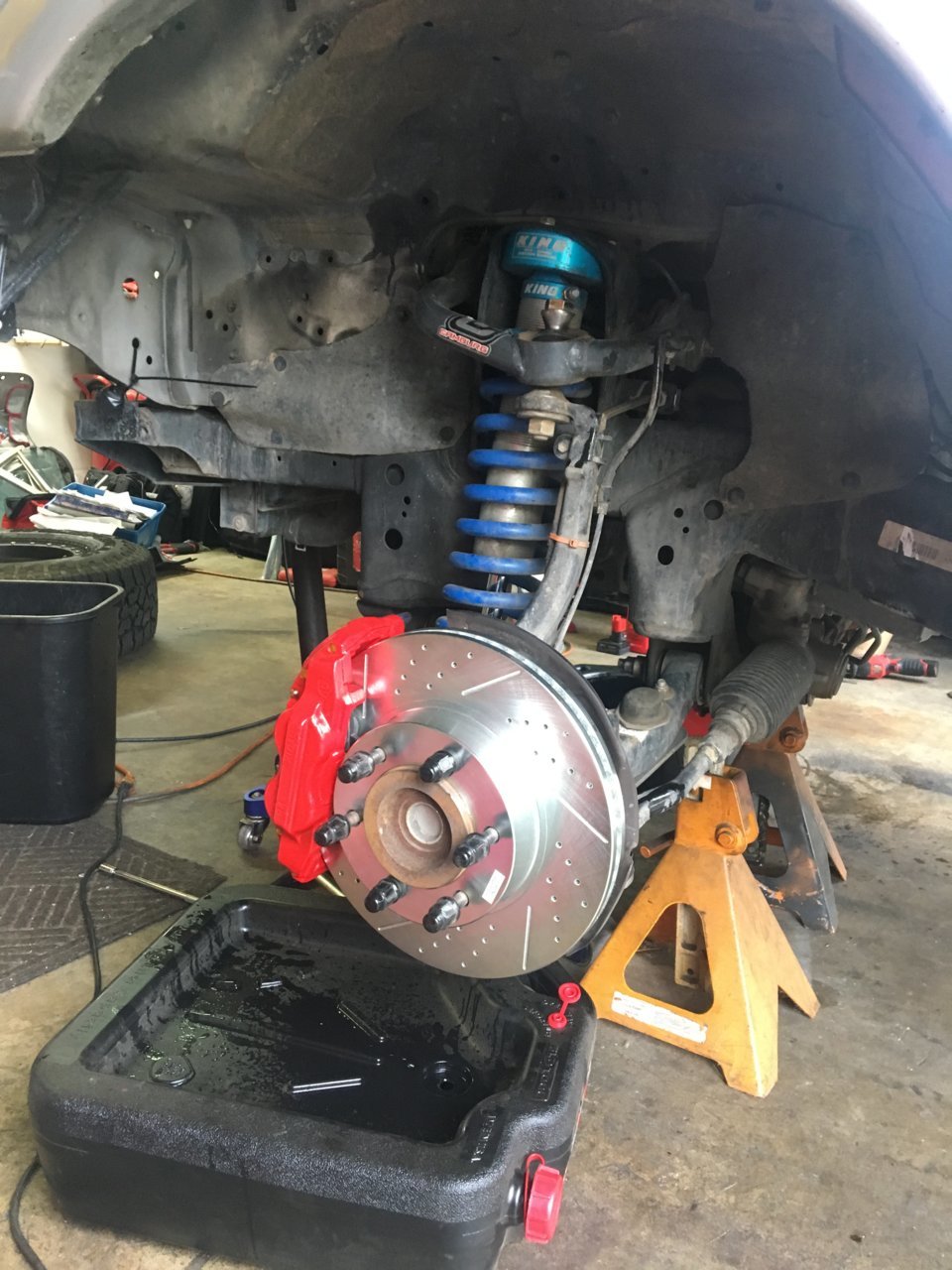

    Finished my tundra brake upgrade and started my big 3 upgrade today. I went with 4 gauge welding cabe. Noticed a difference right away. CS144 alternator coming soon.

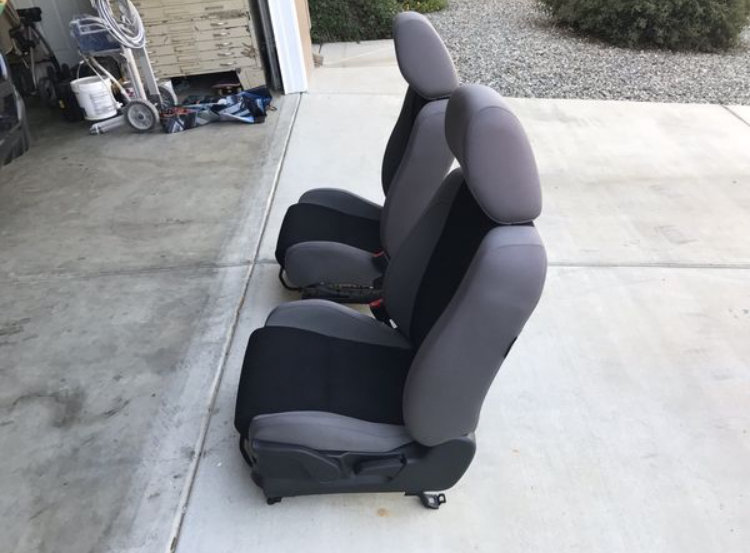

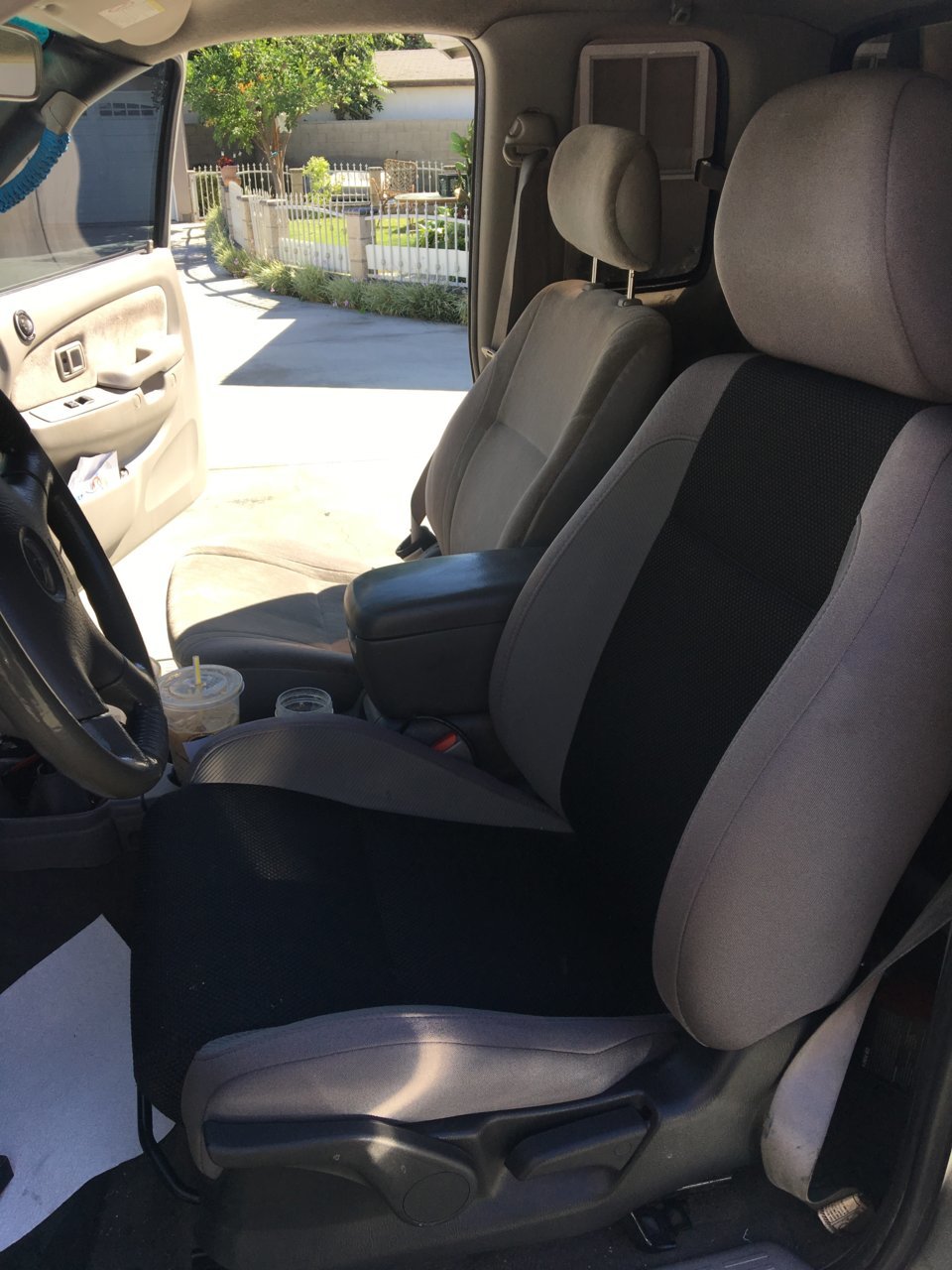

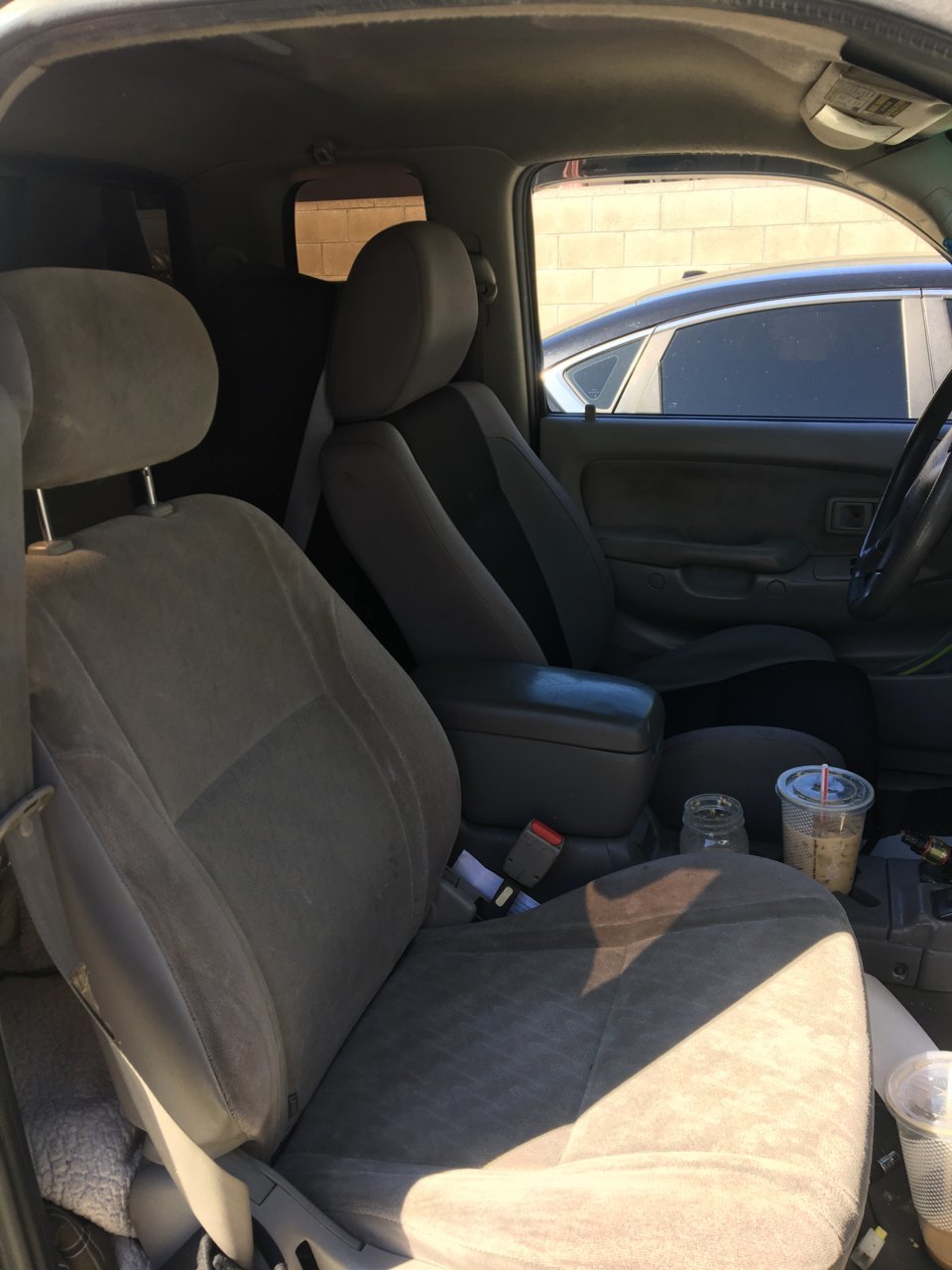

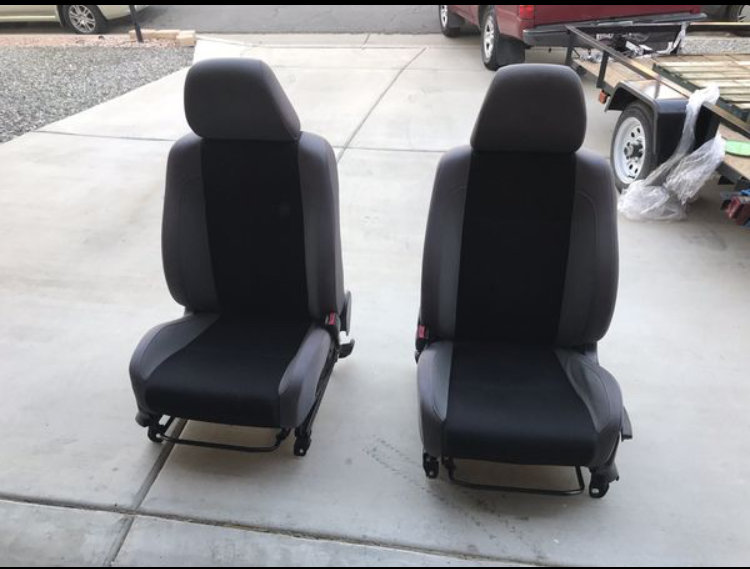

    Just picked these up for 50 bucks! Out of a 2007 wrx and they are in perfect condition. I got the driver seat installed but I’m gonna have to remove it and modify the bracket slightly. Surprisingly these things lined up really well in the Tacoma. They are full recline, double slider, heated, the whole shebang. These are way better than my stock seats. I’ll do pics of them in the truck when I get the other one in.
    DJB1, LOLLY, Maggot61 and 1 other person like this.
  13. Oct 15, 2018 at 3:21 PM
    #73
    Kens04Taco
    Kens04Taco [OP] Well-Known Member
    Sep 11, 2016
    #196991
    1,770
    Sunland, CA
    2004 PreRunner 4x4
    kangs and thanngs

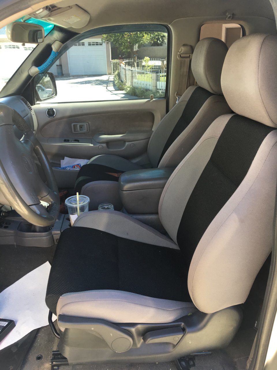

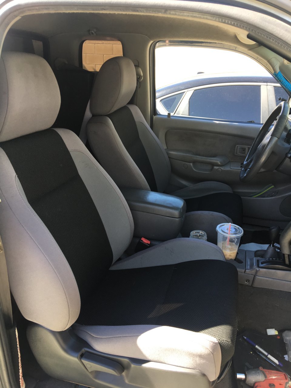

    Ok so I got them in today. Gonna have my buddy make me 2 legs for each seat to make them fit perfect. Here’s a pic with the factory seat and the new seats and some with both seats in.

    How did the swap go for those WRX seats? Did you have to redo the rails and all that?

    Pretty simple actually. Only had to modify one leg
