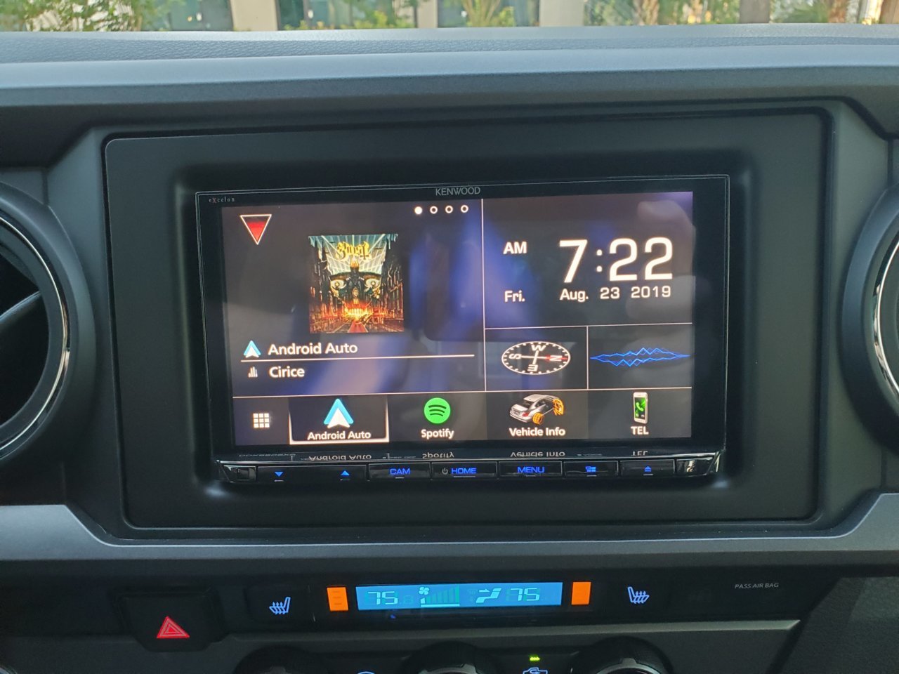

    Here it is installed:

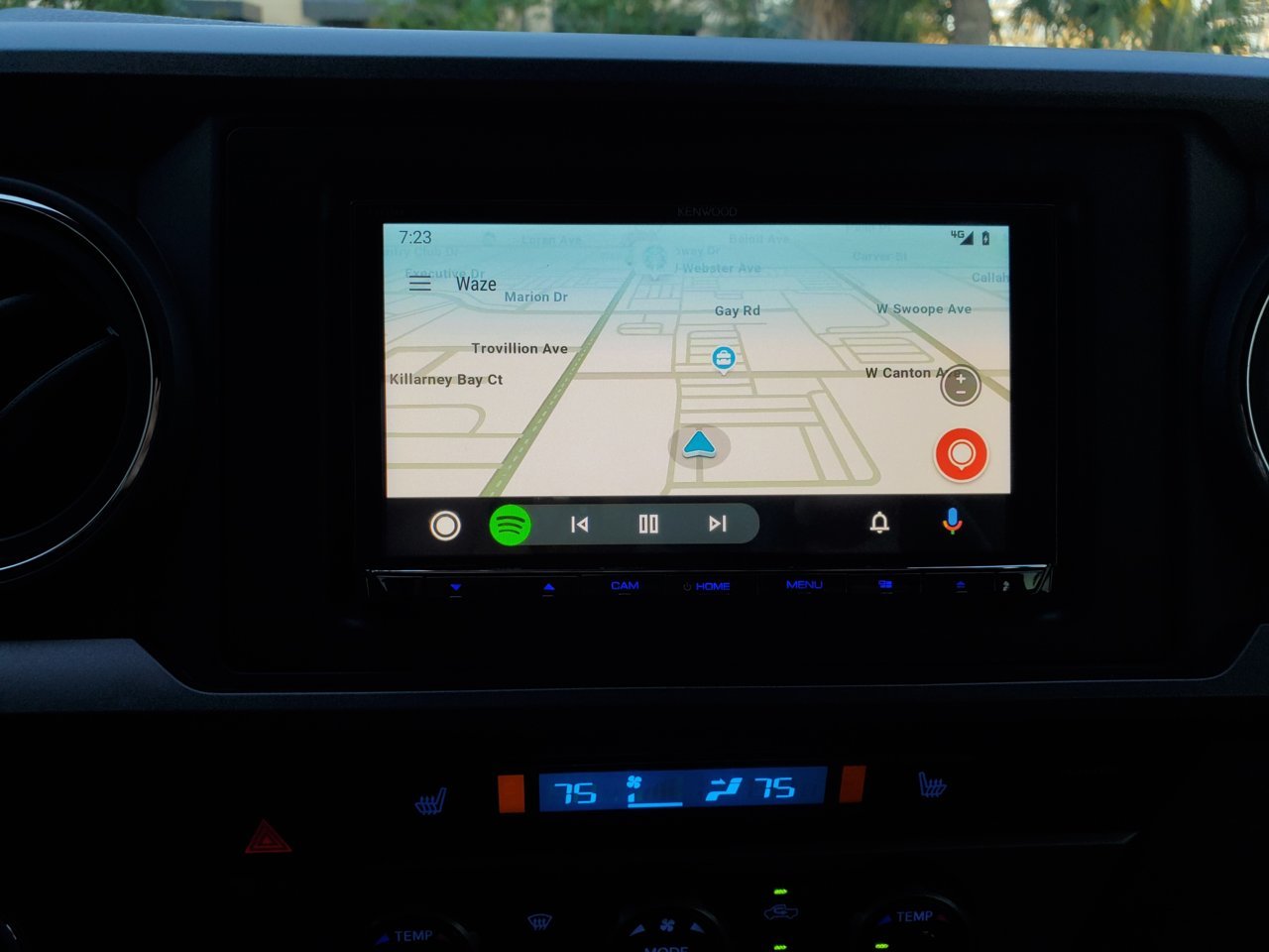

    Android auto fully working (and no, I'm not hanging out on gay street):

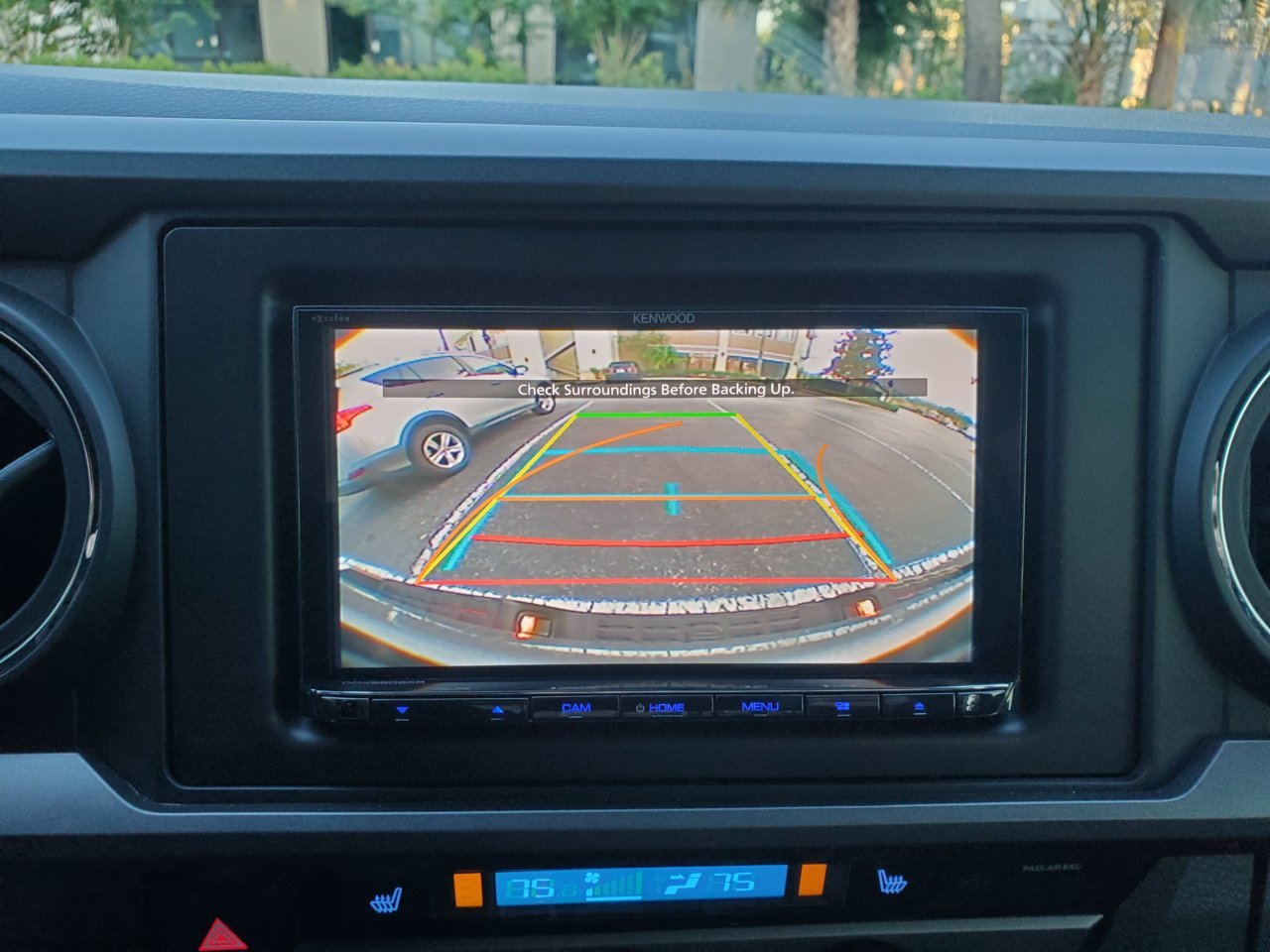

    Here is the backup camera parking lines. The orange lines move with the steering wheel. Not really needed but neat I guess.

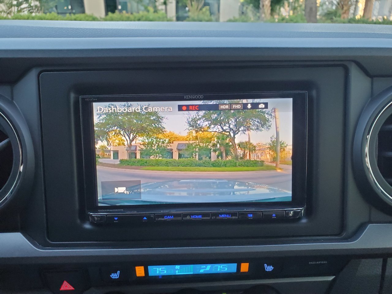

    Dashcam is pretty good. It plugs into the dedicated dashcam port and is tapped into the harness (acc, always on, and ground). There is a parking sensor that always runs when off. If it detects a hit, it'll record and alert me when I turn on the truck. I can then immediately watch the video from the screen.

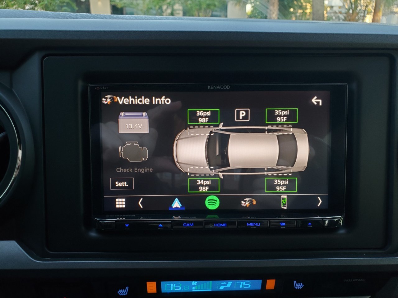

    TPM Screen

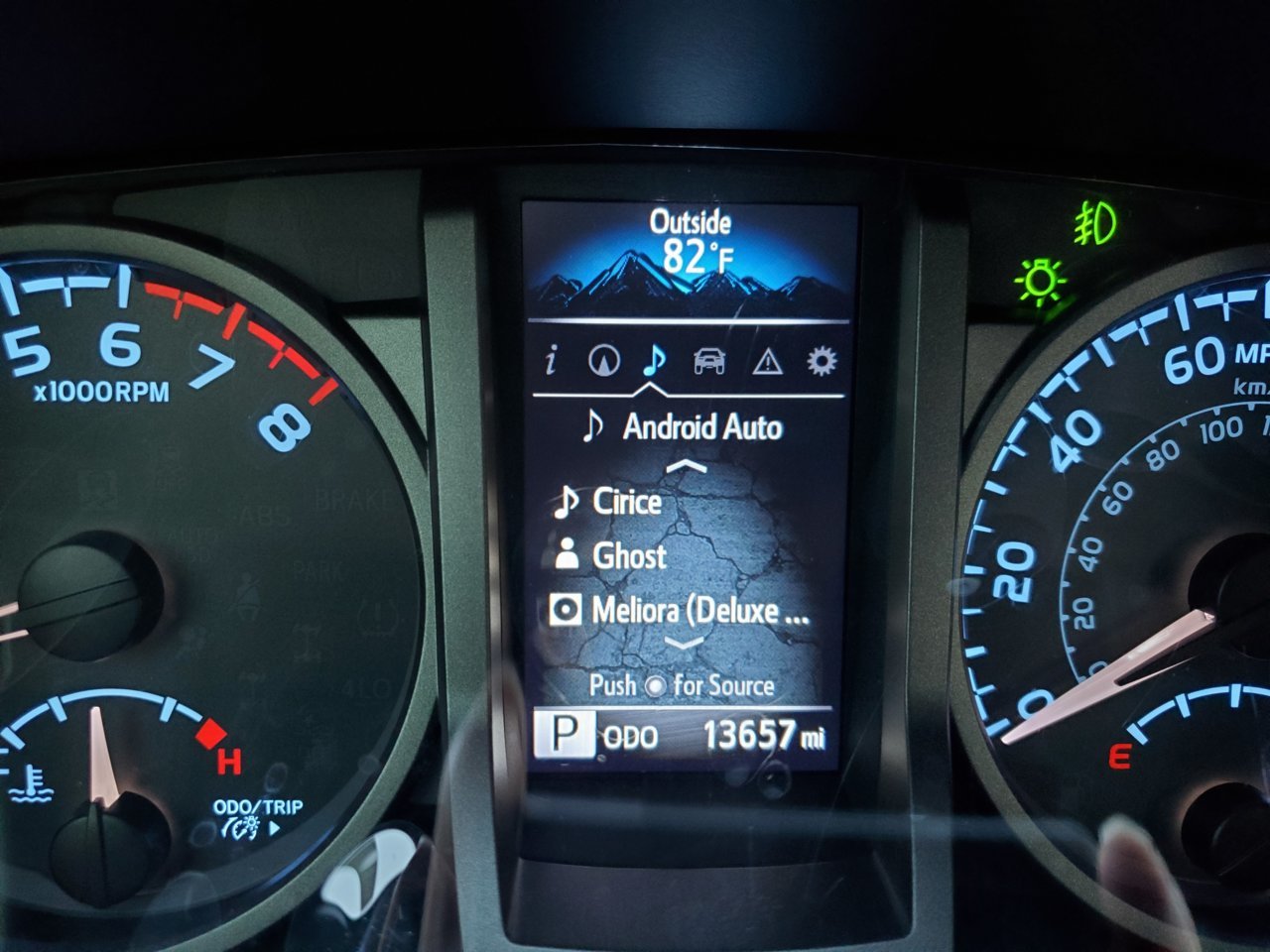

    The iDatalink Maestro is pretty good with integration. The only piece I'm missing is nav data on the center console screen, but I never used that anyway. The best part is that I can reprogram the buttons. No more stupid left and right for volume. I fixed that in the programming. Now up is volume up. Down is volume down. Left and right are now skip back and forward. Sure the buttons don't say that, but it works correctly and I'm good with function over form.

    So far, the head unit is great. I didn't think the moving parking lines were that needed, but it's been awesome. They are spot on.

    The integrated dashcam camera has been good, but after installing a CAI, the engine is much louder when hitting it hard. When that happens, it triggers the dashcam to record so it fills up the event recording every few weeks. I've adjusted the sensitivity as low as it'll go and it still triggers an event recording when I merge. :D

    Android Auto has been really good. There was a bad update a few weeks back but it smoothed out and works great. There are a few songs that never update cluster screen, but I don't really care.
