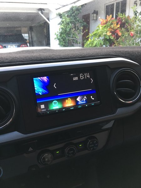

    Yes I have one!

    How difficult was the installation and does it look clean? Any wires or cables running visible?

    You'll need these parts for keeping your steering wheel controls and backup camera
    I datalink ADS-MRR
    I datalink HRN-RR-TO2
    Metra AX-TOYUSB
    You can get the bundle with the trim piece for 150$ at crutchfield
    You may want to call crutchfield as they will help put a package together, forgot to mention the Metra harness so you don't cut or tap factory wires..

    Did you use the whole Crutchfied Kit Like the trim ring and stuff? I know the Kenwood DMX4407s comes with it's own cage and trim ring. Thanks Again for posting this.

    I got all my stuff locally, I used crutchfield for my research. The trim ring is not used in my case, will try to get that model number for you later, it doesn't need that ring.

    It looks great in your dash for sure!!
