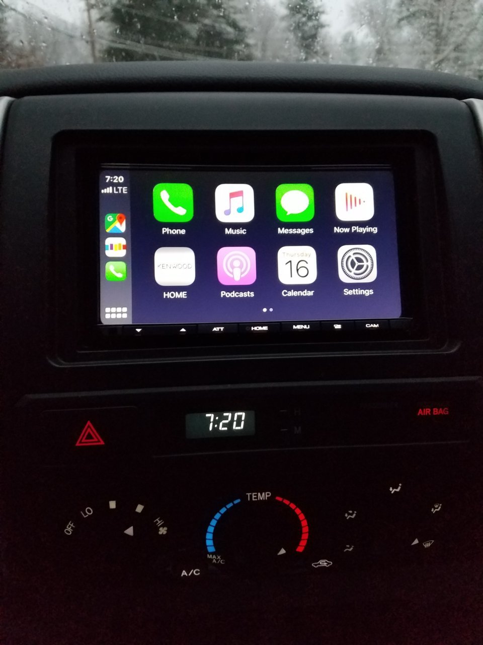

    So I think I probably fixed it, I'll have to confirm this afternoon.
    Went out and bought an iPhone 11 Pro......that should do the trick.
    Buttttt the charger cable is USB C, have to get a USB to Lightning after work. This has been a anything but seamless

    I did need a new phone anyways, this just put me over the edge of actually doing it. Kill 2 birds with 1 radio

    Works like a charm now. Thanks for all the attempted help
