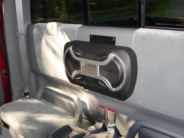

    Here's a pretty good all-in-one alternative to putting in an amp, subs, and custom enclosure.
    KENWOOD KSC-SW1 DUAL 6.5" POWERED ENCLOSED SUBWOOFER
    It fits perfectly in the storage bin right behind the passenger side rear seats without any kind of mounting. Sits on top of the removable dividers that go in the bin and also held up by the hook for the child restraint. It doesn't move at all once you put the rear seat back up. I tested it out by doing some rapid braking and it does not bounce around at all. Also, you can tuck all the extra wiring inside the hollow cross bar for a clean install.
    There is also a KENWOOD KSC-SW10 which is a later version of this powered sub. It does not have as many good reviews as the model I have but is smaller and could fit in the driver side storage bin instead.
    Here are some pics:

    how do oyu wire it? does it just use the pre-outs and ground wire a normal amp does?

    Has anyone mounted one of these or the newer model under a seat? I've bought the KENWOOD KSC-SW10 with the intent to mount it under one of the seats. I really don't want anything like this visible to wandering eyes,
    Wiring? I thought about splicing to the battery wire from the stereo. My son thinks this will draw too much current in conjunction with the radio. I thought the primary source of power for the head unit would come from the keyed power and the battery lead is to keep the unit from losing memory such as settings and presets. I have replaced the factory unit with a Kenwood eXcelon KDC-X592 CD Receiver.

    Hi. I tried to fit mine under the seat of my 2008 Ex. cab, and it didn't fit, thats why it's mounted where it is. I'm pretty sure you won't have any problems wiring it from the head unit power scource. Mine was done at a shop though so I'm not positive. Sounds great to me.

    I just put a SW1 in my dble cab a few weeks ago. I ran the power cable directly to my battery (heavy gauge wire)than I ran the blue cable to the stereo's blue or blue/white (cant remember)on the wiring harness of my Kenwood x-792 and hooked up the rca's. I dont think the SW1 will fit under a seat. I put mine on the right side behind the seat storage. You dont even have to mount the sub it just sit there in the behind the seat compartment.
