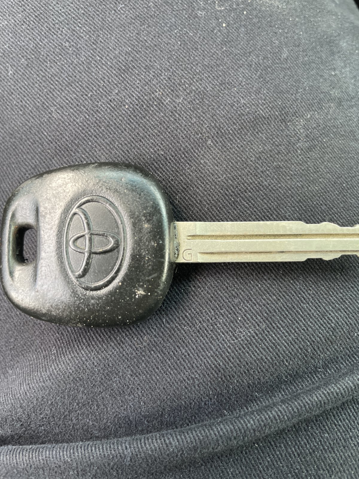

    So if you look at the key itself, there should be a letter “G” on the key. If it’s there, which it more than likely is, it’s got an immobilizer chip in it.

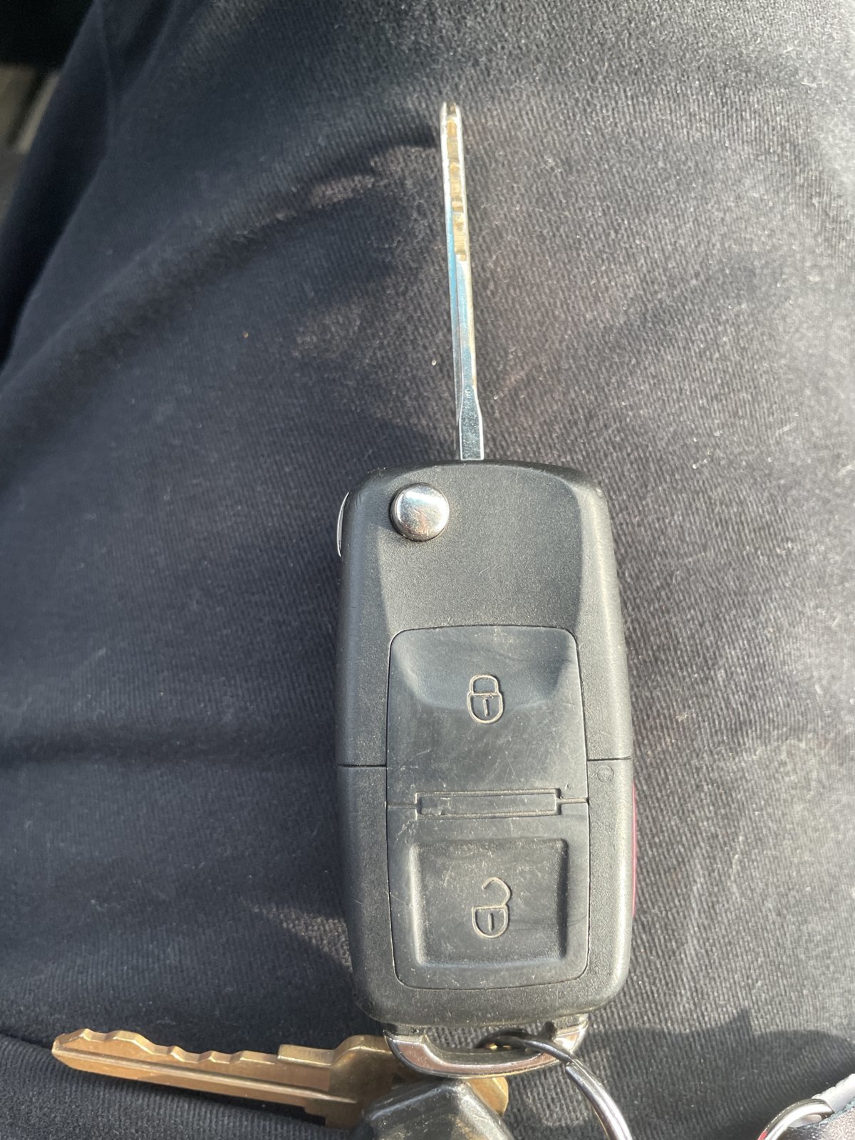

    Even tough I do all the work on my Tacoma, I’d rather not do this. Has anyone had luck buying a Toyota-like combo key (key with remote on top/connected) from ACE and had it successfully programmed? Thanks

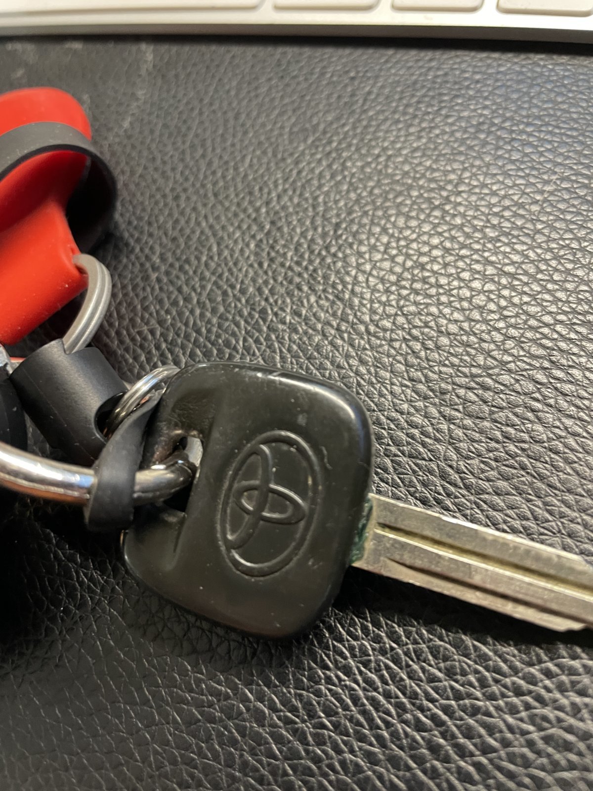

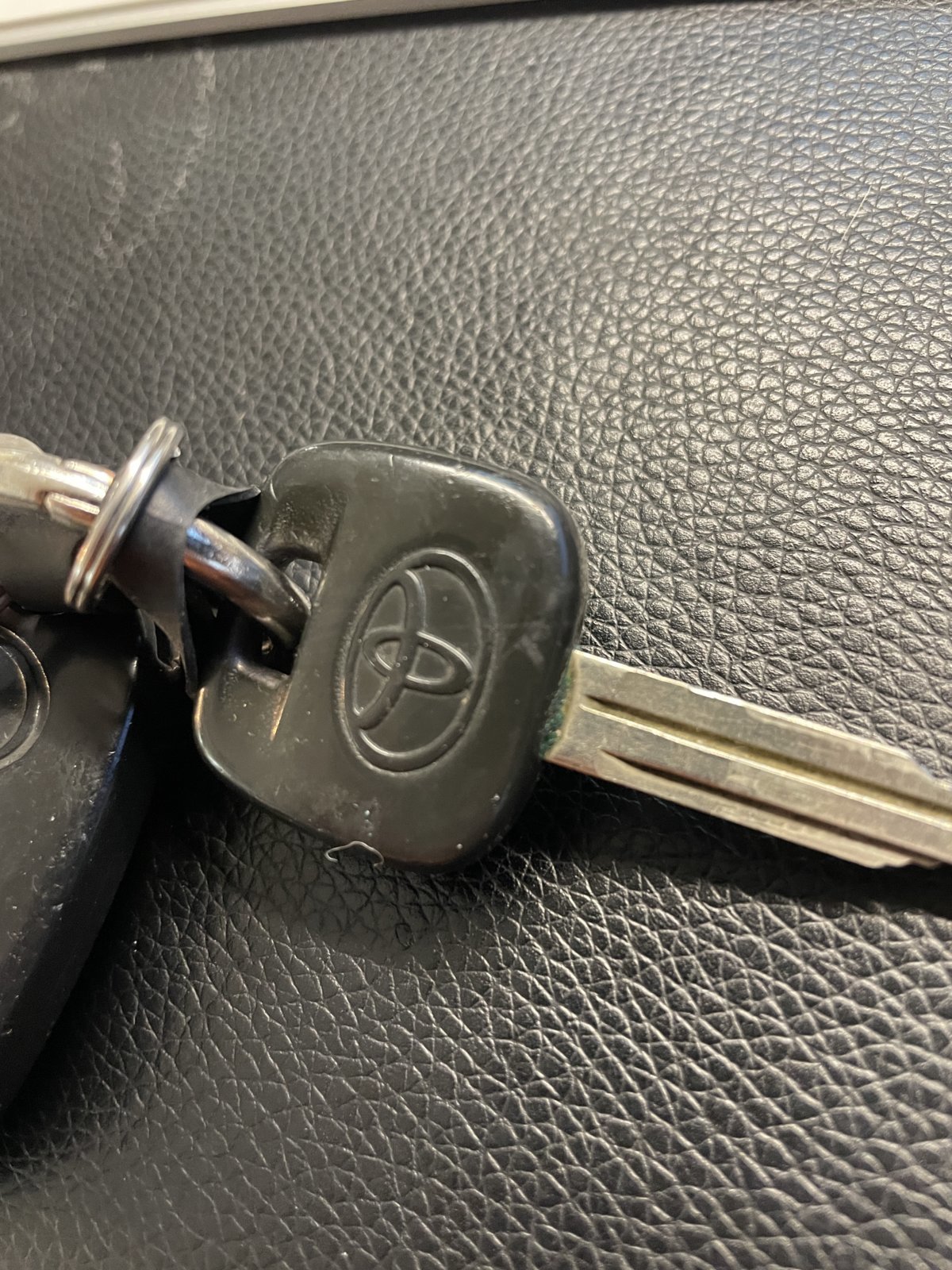

    Thank you very much for helping me understand my options better. My key appears to have no markings whatsoever on the black rubberized top nor the metal key itself. Photos below.
    That, combined with the info in this thread convinced me my key does not have an immobilizer chip...
    My Tacoma is a 2012 SR5 access cab 4-cyl 5-speed manual and I confirmed the key fob says "GQ43VT2OT."

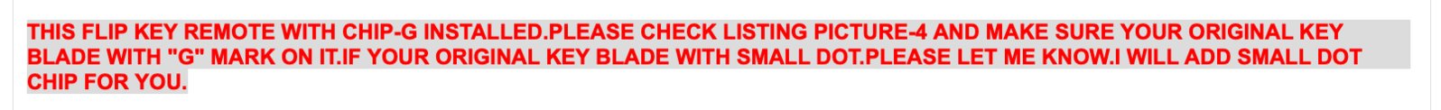

    For the benefit of anyone else here: I could not interpret what the seller was trying to say here in the auction:
    But I messaged the seller who confirmed the key/fob would work for my key which does not have a "G" marking, and that I need to inform them my key does not have a "G" marking so he'll end a remote/key without the chip installed.
    Correct, I uploaded a copy of my key that shows the G on the key itself, but that key fob code seems the same as mine. If you want the flip key like mine, then yeah you’ll just follow the steps in the video where you open/close the doors a few times, and take the key to get cut & programmed. Luckily a family friend helped me get it cut and programmed for free so I just paid for the flip key itself.

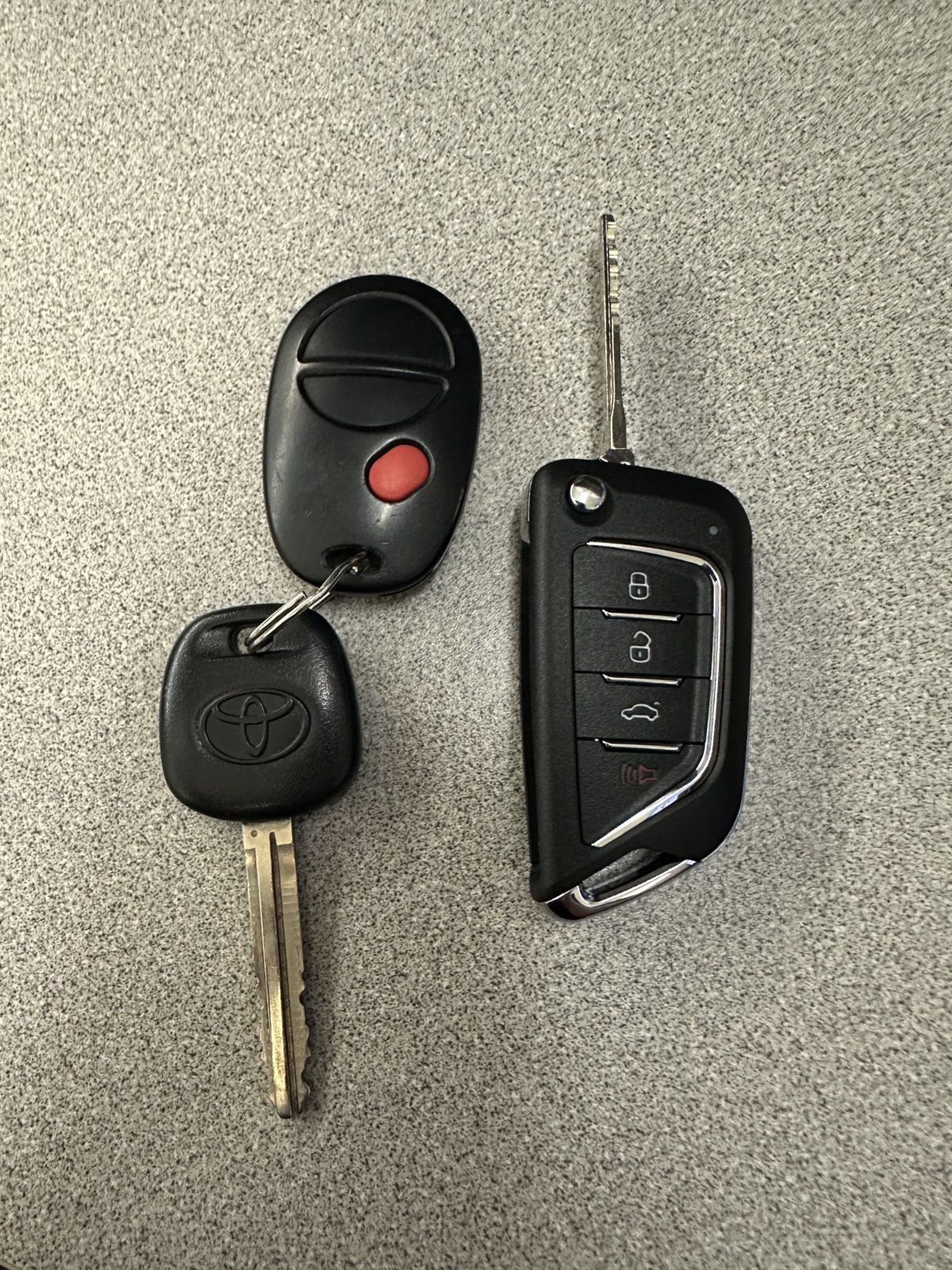

    Old and new. Used Tom’s Key to program and it was ridiculously easy. Dealership cut the key for $15. All in was under $100
