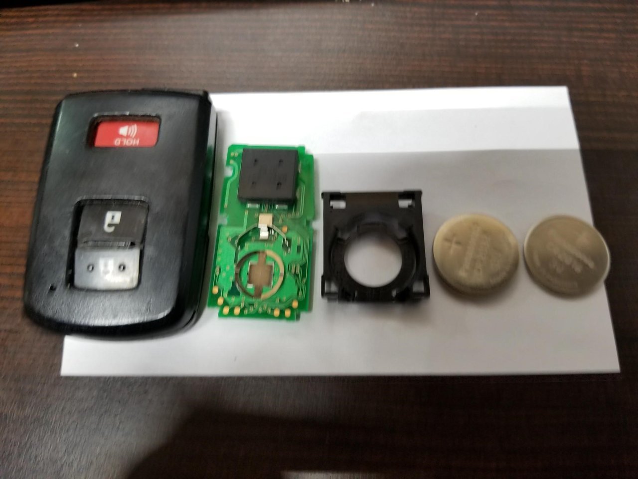

    I've been looking at ideas for reducing the bulk of my key fob in my pocket or eliminating it altogether. With proximity sensing and push button start, I feel like I shouldn't have to have a huge fob taking up room or possibly being lost.
    I thought about getting a Lexus credit card key, but the expense is pretty ridiculous for a minor upgrade like that. So now I've come to the conclusion that making something myself is the best idea.
    I'm only in the ideas phase right now, and have disassembled my fob to see what I've got to work with. I've included photos and would like to hear your ideas.

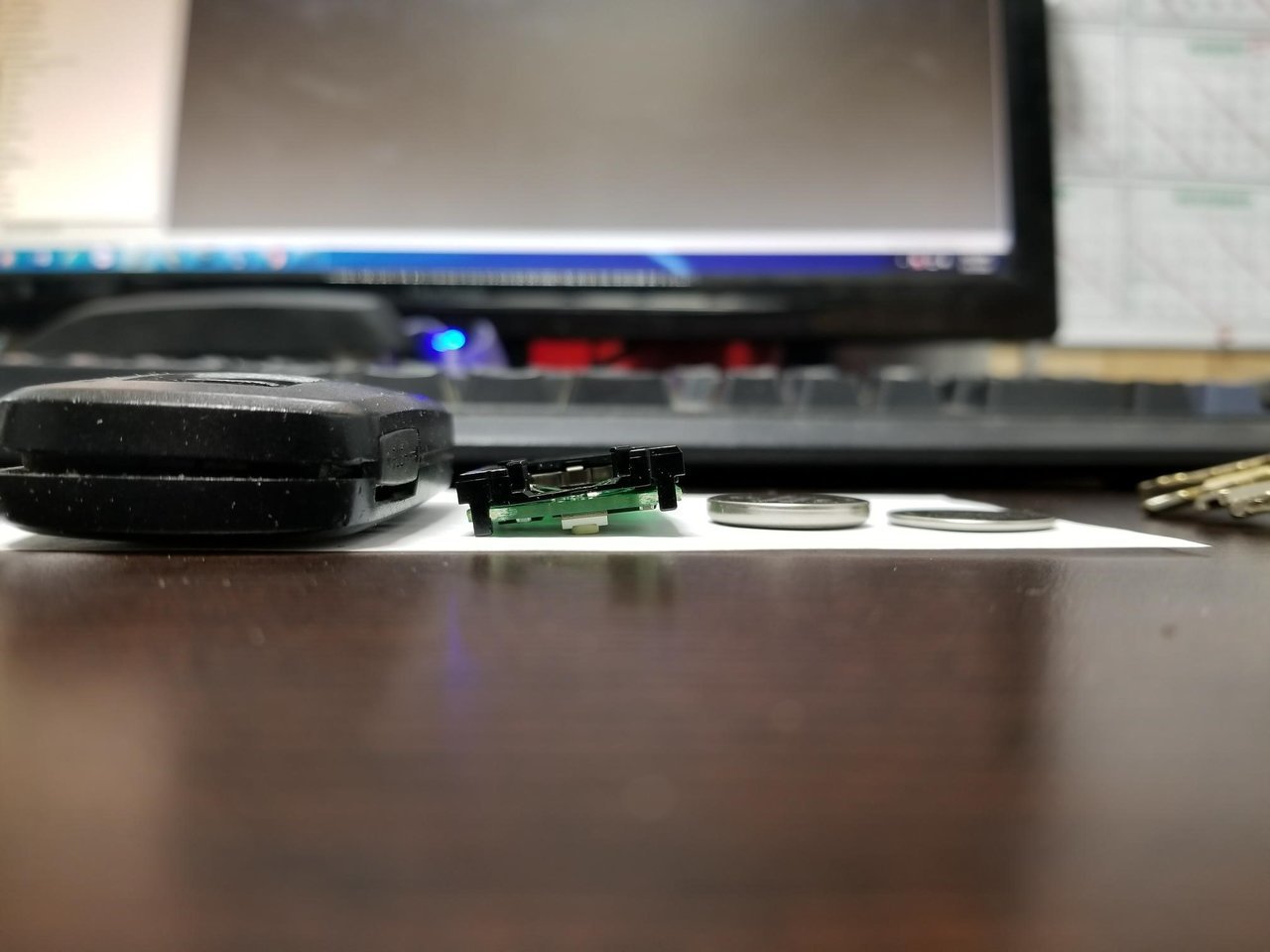

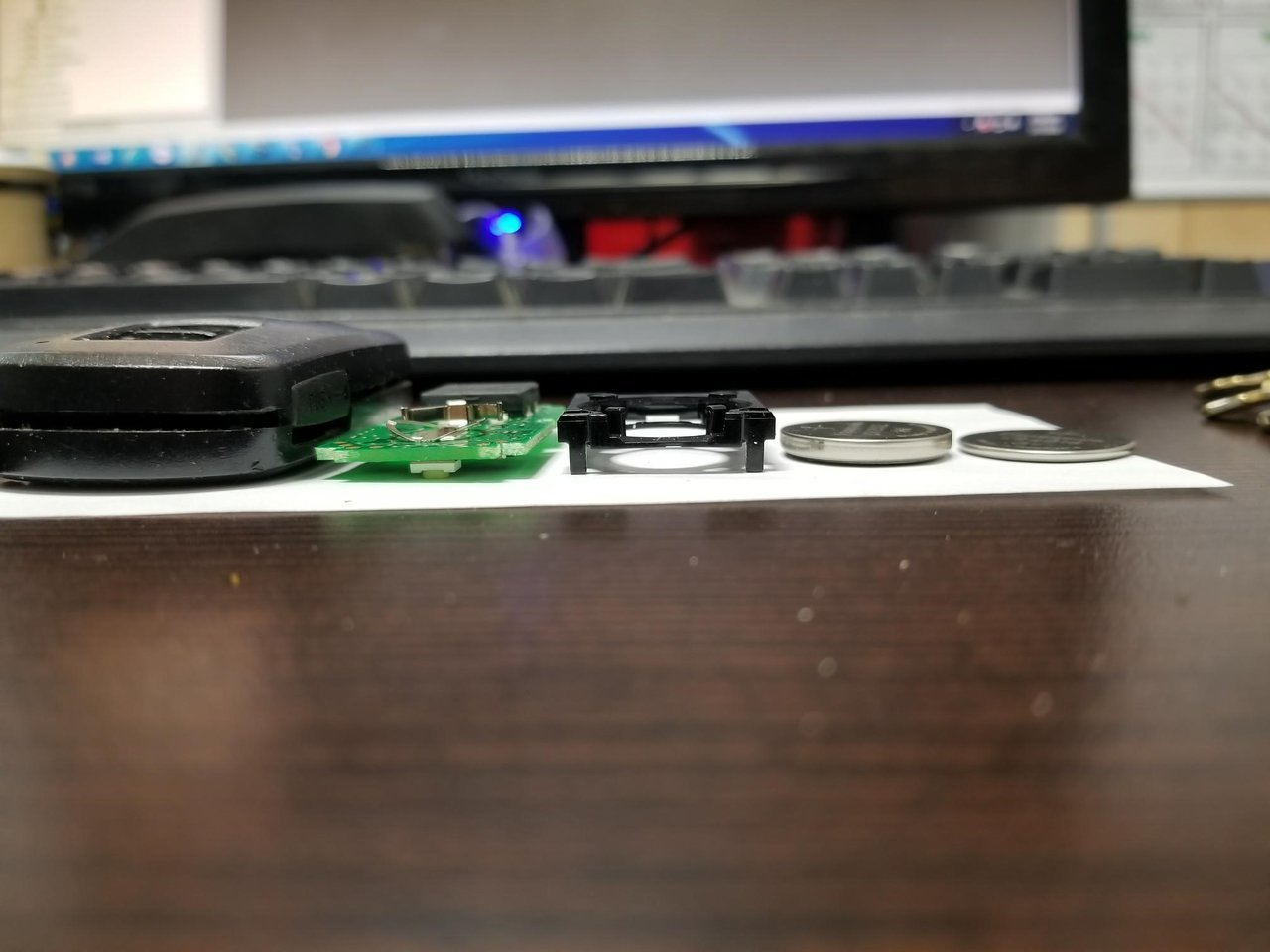

    The CR2032 battery in the fob is twice as thick as a CR2016 but has more than double the capacity. So the 2016 would save space but reduce the battery life. That's a trade off I'm willing to take. Batteries are cheap.
    The plastic battery housing can be eliminated entirely, if you integrate a battery housing with whatever you decide to mount the board to.

    I thought about putting thick heat shrink tube around the entire board, but I have to fab a small button spacer first to keep them from being depressed by the tubing, and have to make sure the CR2016 battery is completely secure.

    Maybe I can find heat shrink tubing large enough to fit around a credit card sized piece of plastic, drill small holes for the buttons, and then heat shrink the whole assembly together?
