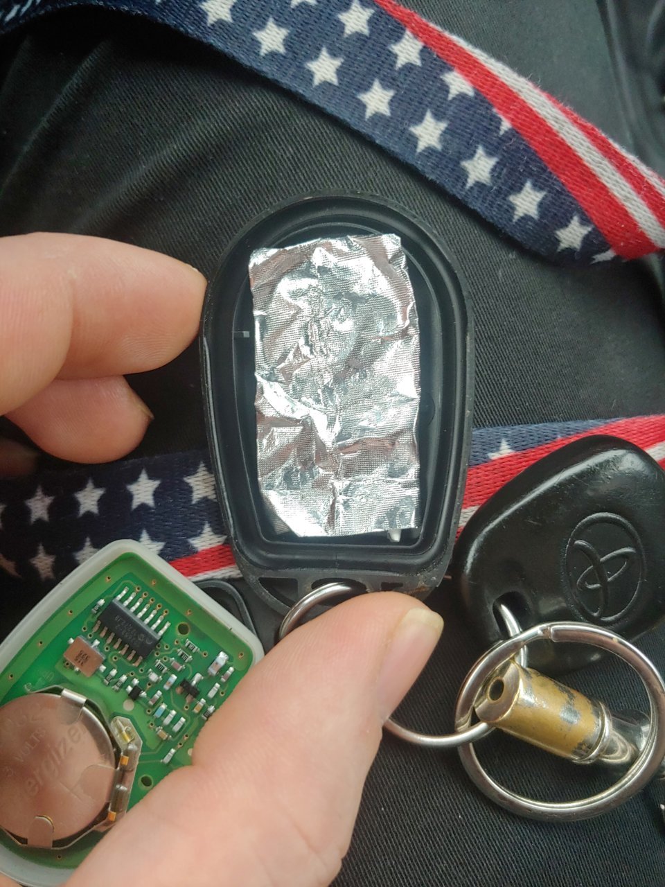

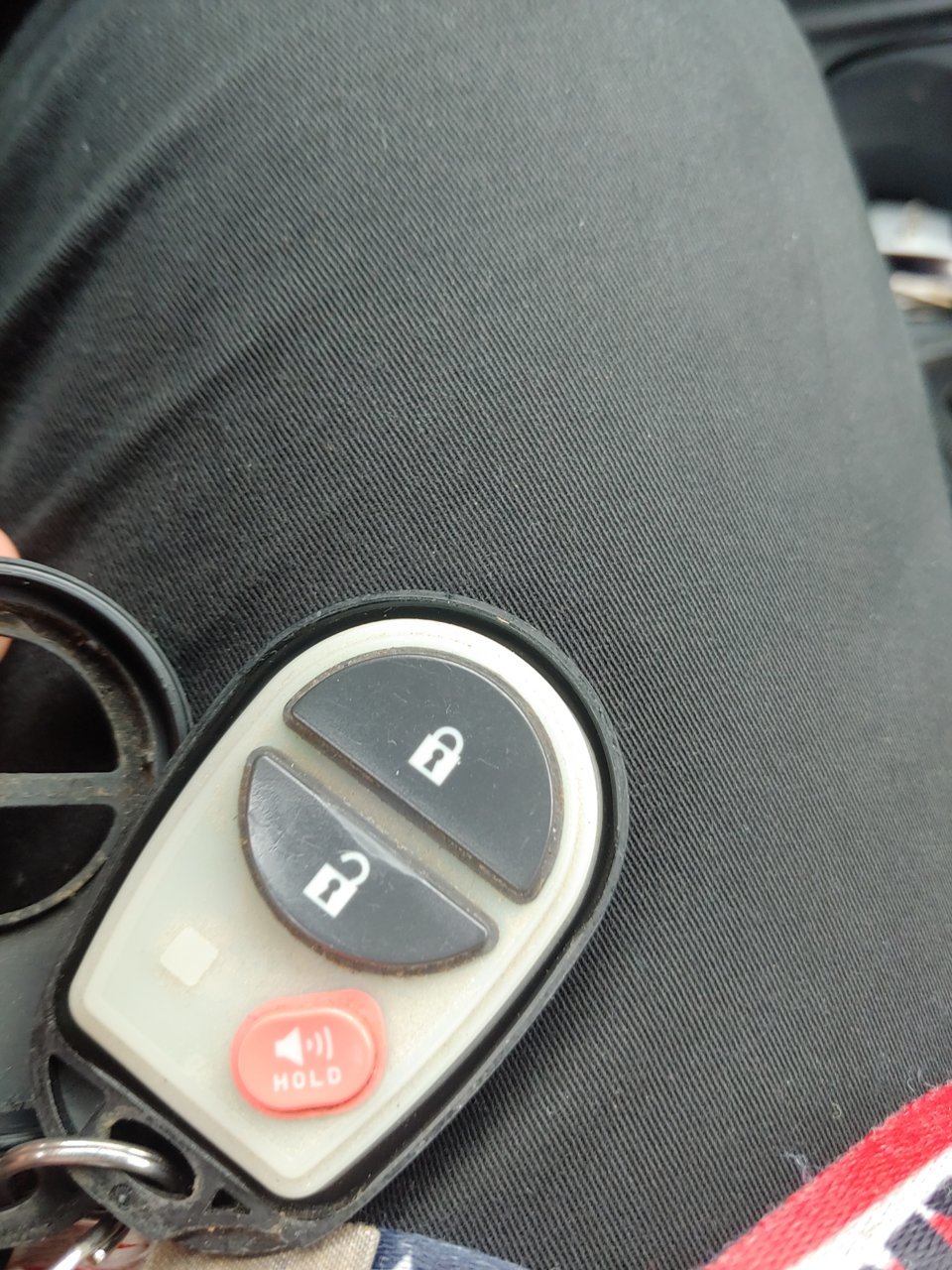

    So try this!!! My unlocking button always had problems locking only sometimes. I replaced the battery and it worked great... Next time didn't work at all. Worked outside the housing .Just the front housing it worked. With just the back on it didnt work. Took a gum wrapper folded it so it covered the inside back of the housing. Works like new now
    DrFunker likes this.

    Wonder if a little piece of alum foil would work too.
