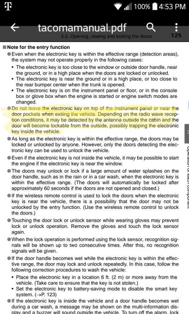

    Page 121 in your owners manual.
    Basically you walk up to the truck with the fob in your pocket, touch the driver door handle and it unlocks. You never have to remove the fob or key from your pocket/purse. Same with locking the door upon exit.
    Also, as said above, you do not have to worry about locking the fob in the truck, because the antenna will pick up the signal and think you are near the vehicle ready to open the door.
    I highly suggest you read through the manual.
    Have you been using the little metal key to unlock your door?
    This also brings me to another question. Have you been putting the fob in the hide a key, and if so where have located the hide a key box, because you may have been leaving your truck open to anyone willing to take it.

    Well..... there is a way to disable the power to your fob for long term storage or washing your truck. Or just removing the battery which takes 3 seconds.
    You could consider trying to get just a copy of the key made, and keep your backup fob hidden in the truck deactivated. Have the spare key hidden in your hide a key, and your last key in the safe.
    Then you would have multiple keys and a safe fob. If the event you do lose your fob then buy another.
    I've ridden hundreds of times leaving my fob deactivated and tucked away in my truck without issue.

  12. Jul 17, 2017 at 2:43 PM

    @Sedyn this truck does not have a key ignition so as I considered just putting the extra key in the hide a key but it cannot start the truck due to keyless ignition
    Here is a question: AC is running you run in the store and leave it going due to 103* heat............can the dig lock himself in there with the fob in there? I would think so because you can lock the doors while riding in there.

    Possibly

    I you run into the store with the fob in your pocket you can still leave the truck running. I'm not 100% sure without trying, but I think you could even lock the dig (dog?) in if you want to.
