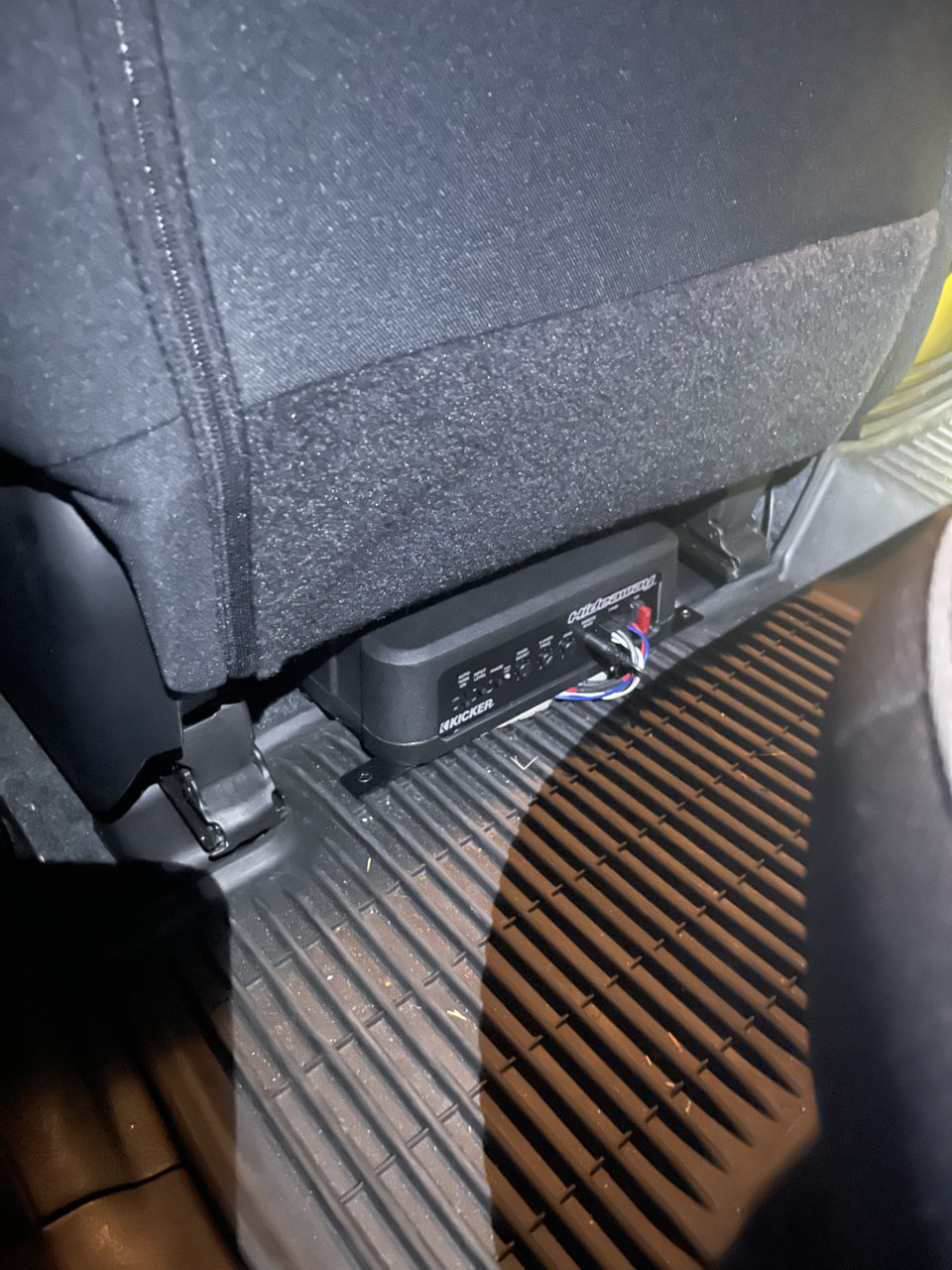

    Hey everyone,
    As many other threads, I am currently working on installing a kicker hs8 on a 2021 non jbl OR.
    I’m trying to discern if I have a bad unit, or if I’m just wonky.
    Any help would be appreciated. I’ve combed threads and threads to learn and find info out and have reached no positive results.
    Kicker mounted under driver side seat.
    -Power to battery. Re checked fuses with meter, etc all good.
    -not using remote line because I’m splicing directly in (though I got desperate and even tried this method with no success)
    -white/ WB to left driver kicker panel, followed @destin_meeks thread on which lines to splice into. (Just to make sure tested them and confirmed they were front left) did the same to front right. (I initially tried splicing into rears).
    -ground to multiple different ground points to ensure we were rocking with it.
    So the issue. I’m getting power, turns on, turns off. All the good stuff. But no output. I’ve traced wires, I’ve switched polarity, I’ve tried fading.... everything. But nothing. At one point I ran all to just my left side inputs and had a little bit of feedback. Tried all sorts of different settings and so forth and only get an occasional rebound of bass when I’m turning the gain up and down but nothing else.
    to me it is screaming bad product.... at least I hope that I haven’t gone the past three days just completely off my rocker and wired it wrong.
    if you guys have any tips or pointers please let me know.
    as of right now I’m looking at returning and relaxing the Unit. But maybe you guys have a better idea or some Hail Mary for me to try?
    Thanks
    K

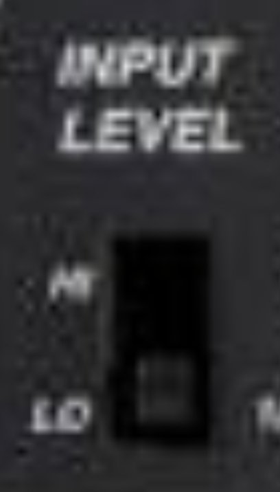

    My edit was referring to this switch. If you are using speaker level in, then the switch needs to be set 'HI'. If you are using RCA then it needs to be set to 'LO'. Screenshot_20211013-194847_Chrome.jpg

    Thank you,
    yes set it on hi. And tried lo even.

  17. Oct 15, 2021 at 11:46 AM
    #17
    JIgawatts
    JIgawatts Well-Known Member
    Mar 16, 2020
    #322262
    55
    I'm hoping your problem was solved and if you have any install tips please share. If I get some free time this weekend, I'm hoping to install my hideaway. I talked to customer service at crutchfield before I ordered my sub and was told the only thing I would need for install were wire connectors that tap into the lead wire.
    https://www.crutchfield.com/p_669PP605/Posi-Products-Wire-Connectors.html
    I see you mounted yours under the seat. Any specific reason why you chose under the seat as opposed to behind the back seat? Just curious because I don't have a plan yet. LOL

  19. Oct 15, 2021 at 6:47 PM
    #19
    Movementwarrior
    Movementwarrior [OP] TACOTIME
    Oct 12, 2021
    #379503
    37
    '21 Green OR
    Appreciate your comment!
    The problem was solved when I replaced the hideaway. I was scratching my head thinking everything (the limited knowledge of) I knew of electrical.
    once that was done I quickly tied into my old connections and immediately saw the difference.
    When I realized I was good to go I actually soldered my connections together, heat shrink etc etc. tied in left to left and right to right.
    I mounted it under the driver seat mainly for the massage feature hideaway forgets to mention , but in reality just because I wanted it to be easy access there with a shorter run. Not to mention I may be removing my back seats to build a platform. I already had conduit running pretty close to my drivers seat anyways because of my center console switch panel I installed so essentially... just an easier run. I definitely love the hideaway so far. It’s pretty great, ran the bass knob to that same switch panel and it’s pretty solid. I think it’s perfect for the amount of bass if you want just that little umph. But that’s it. Definitely switching our for some kicker door speakers.
    Reach out if you need any help or anything!
    JIgawatts[QUOTED] likes this.
