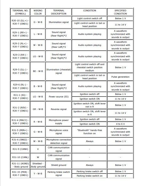

    The blue wire (pin 8 in the middle of the 10-pin harness) is absolutely remote turn on (or more specifically, power antenna from the male harness, and the female harness has a jumper to the remote turn on side. However, this is definitely a 12v output from the radio when its turned on.
    Orange or orange/white (pin 10 in the 10-pin harness) is illumination.
    dolbytone and Bach88[QUOTED] like this.

    You are correct. Forgot I moved the blue wire to other harness that was not metra brand and was missing the illumination wire. Post deleted.

    * On the Metra harness, you'll have two harnesses... You'll have an extra pin on the big one, easy to spot, it's a blue loop of wire. You will want to de-pin that and move it to the metra small (rear speaker) harness - This is the dimmer wire. If you don't do this the lights on the radio buttons will be off (instead of dim) when your headlights are on.
    It will make sense once you're looking at it, just something to be aware of going into it.

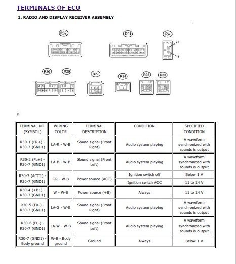

    This should help.

    You can definitely get your power and ground at the radio.
    I would recommend NOT getting it from any other source other than the radio OR straight to the battery. I’ve learned to never mess with the ECU or any other important wires in the truck. As others have stated, power from the radio works fine, or spend an extra 30 minutes running a 10awg wire to the battery with a 20 amp fuse. Nothing crazy.
