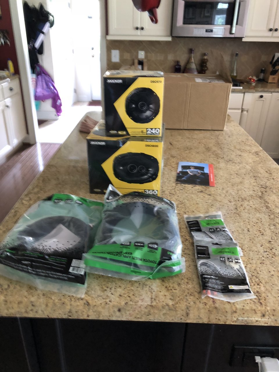

    Yeah those kickers do kick from Crutchfield and at $138 delivered to your door can’t beat it. The tweeters off Amazon are an extra c-note and well worth the price from both companies best part is all plug and play too.

    Yeah the magnets on the stock speakers are a joke, I did the meso puddle mod so might as well change out the speakers. World of difference when replacing all three.20190615_130945.jpg 20190615_133026.jpg 20190615_154631.jpg 20190123_153717.jpg

    Exactly. Set the trebble -4, leave mid centered, and set bass to +4 and you have a killer system when volume on the stock head unit is over 40. The HU does have enough juice to make these things jump, you just have to crank it
