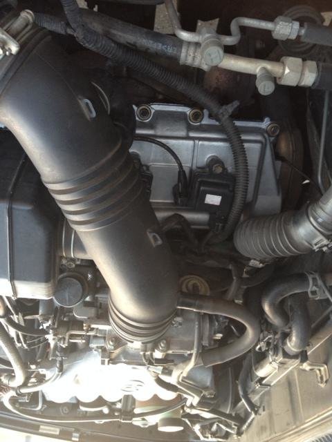

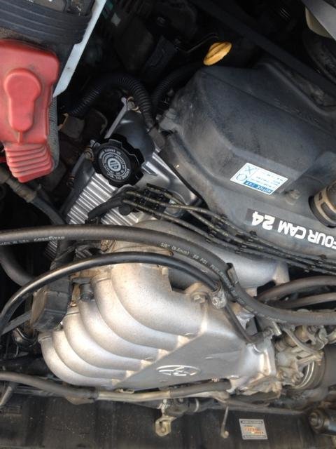

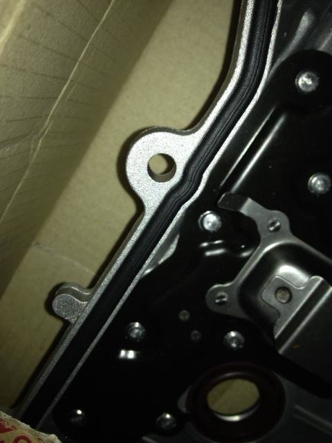

    I have done a lot with my truck the past few weeks. One major thing I accomplished was a valve cover gasket job. This included valve covers (cracked an old one by over tightening a bolt), valve cover gaskets, intake plenum gaskets, cam plugs, spark plugs, and spark plug wires. A few other things I did was re-pack the semi circle plugs with new FIPG, new valve cover bolt washers, new oil filler cap, and thoroughly cleaned the throttle body and intake manifold. I didn't take many pics of this but here's a few pics of the new gaskets in place and the motor with the new covers on.
    Gasket
    New clean valve covers. Motor looks new! :D

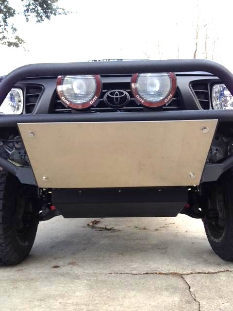

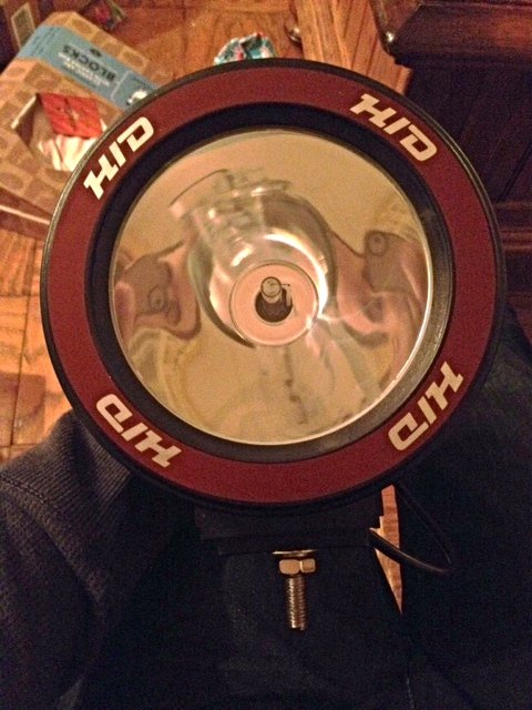

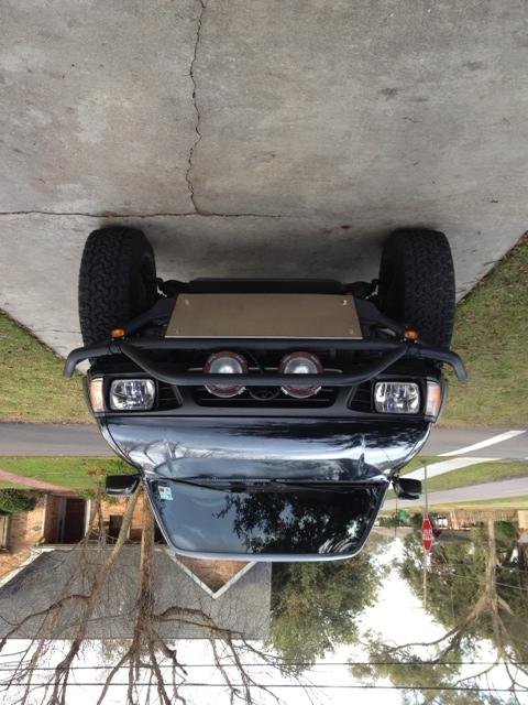

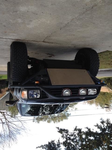

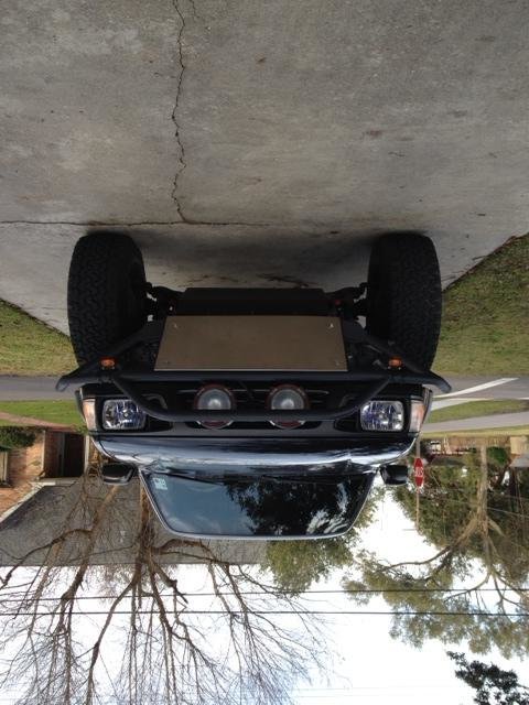

    For christmas I got a pair of 5" Rugged Ridge HID Offroad Lights. I also managed to finally prep and paint my RAT skid!
    Shot of skid from the front
    I kind of wish my light bar was a bit higher so it doesn't block the top of the lights. I may modify this in the future.
  6. Jan 3, 2014 at 5:08 AM
    #66
    OCAT T5I
    OCAT T5I Member
    Aug 2, 2013
    #109639
    14
    Robert
    Raleigh, NC
    97 4wd V6 LX 5-speed
    Your pics are always upside down. Haha still lookin good though!
  7. Jan 3, 2014 at 7:06 AM
    #67
    kigmob
    kigmob [OP] Well-Known Member
    Jul 18, 2012
    #82906
    1,134
    James
    New Orleans
    97 TRD S/C 4x4 V6 5spd
    ICON/TC TRD Supercharger URD 2.2 and 7th
    Haha man I don't get it! They always looks fine on my laptop :confused:

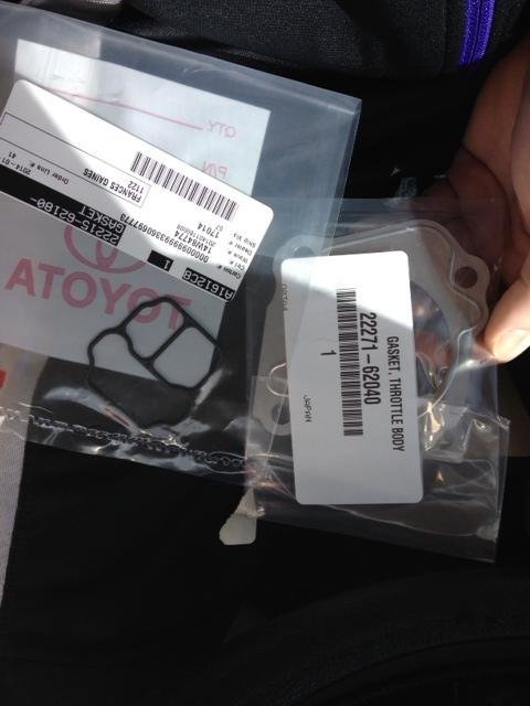

    So as some may know, I was having CEL issues after my valve cover job. It gave me 3 codes. P0130, P0133, and P0171. I fixed the P0130 and P0133 codes by replacing the upstream O2 sensor. The P0171 code was giving me trouble though. I finally discovered it was either my TB or IAC Valve gasket. When I cleaned my throttle body, I did not remove and clean the IAC Valve. I think some TB cleaner got in the valve and ate at the gasket. I also noticed my TB gasket was not oriented correctly. Anyways, I took the throttle body back off, cleaned the IAC Valve, and replaced both gaskets. NO MORE CEL! Here's a pic of the parts if anyone needs part numbers.

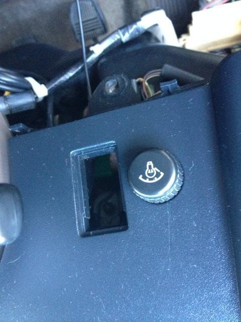

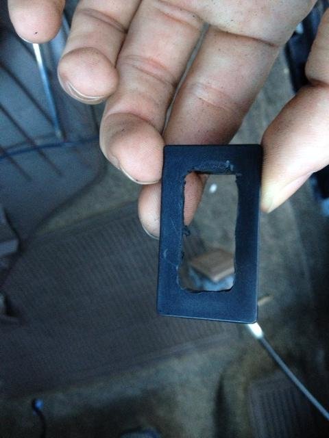

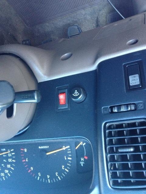

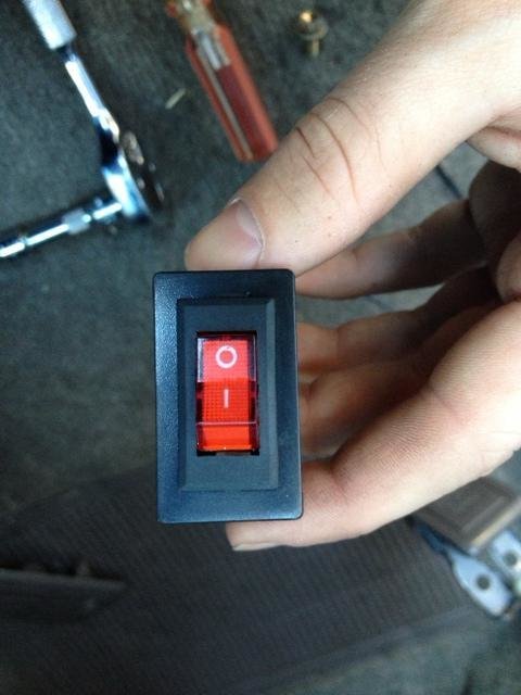

    I also permanently mounted the switch for my Rugged Ridge HID's. Just popped out one of the empty slot fillers and went to work with a Dremel. Pics of the process:

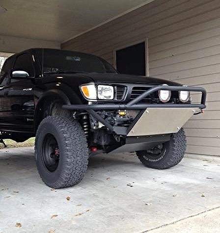

    And finally, a cool picture of my truck :cool:.
