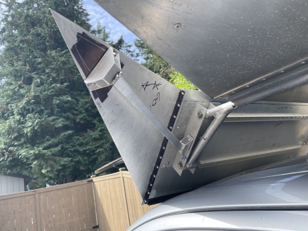

    Hey, not making a ton of progress on projects this summer but I finally finished up with the air dam. Surprisingly close to the concept. Had a short test drive to verify at freeway speeds, it’s solid. I’ll let you know what kind of mileage improvement (if any) as we put some miles on it.

    Looking good, @Profloundering
    What kind of clearance do you have between the wind dam and the windshield? Do you have some weatherstripping or something between the metal and glass? And yeah, keep us informed on MPG and if you notice any noise reduction. I spent a good chunk of time this summer with improving the incredibly lack luster noise dampening / sound proofing of the stock Tacoma. It's a made a sizable impact on my sanity, and I definitely identified some major culprits of cabin noise. Though, I can still imagine doing something like what you're doing here in the future — especially if you're getting good results.

    I will keep you updated - the lip of the dam sits almost on the windshield, I had some leftover j-channel from adding the gutters, so I just added a length of that and it just barely runs the windshield. Optimally I wanted to mount the dam to the roof rack of the truck but mine didn’t come with one installed and I’m not ready to open any holes in the roof. The Kimbo moves around a bit so I didn’t add any reinforcement to the lower part of the air dam lip and it flexes as the Kimbo moves around. Since the rubber is on the glass, it shouldn’t have to much wear and I’m not terribly concerned with it hitting/damaging the windshield, actually needs to be replaced anyway, so it’s a good time to test. I’ve been running the center section without the wings for a few thousand miles at this point and the wind noise dropped significantly. The mileage improvement was around a mile per gallon…so averaging 12-13mpg freeway. I’ve done a couple hundred miles with the ‘wings’ added and surprisingly it’s up to 15mpg on the freeway. I’m excited to see what it’ll do going over the passes and along the Columbia with some headwind.here are a couple pix of the supporting structure…you can see the long lip down to the window that allows for a significant amount of deflection. IMG_6709.jpg

    Very cool, @Profloundering
    It looks like the entire assembly slides into the existing structural channels on the Kimbo, yeah? That seems like a nice way to do and what I had in mind as well.

    Yep - right into the support structure, using solid aluminum rod that is a snug fit...I was going to put a set screw in it to keep it secure but it's plenty secure with the length of the rod and the snug fit.
