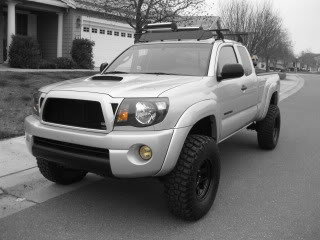

    Jan 6, 2010

    Here are my 285's and I'm going to do the mount chop because the tire is really aggressive and it does hit... But I think it's also because I have 1.5" AP wheel spacers. :D

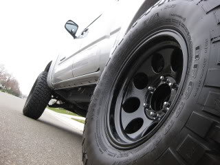

    These are my 305/70/16 Kumho's on 16x8 wheels with with 4" backspacing at full lock (drivers side) and 3" of lift. I have never rubbed the body mount, even offroad. Trimed lots of plastic but no rubbing on anything. Your castor setting as a lot to do with whether you'll rub the body mount or not. 3" of lift with the stock UCA's in my case = no body mount rub.

    appreciate the info and pics. reassuring my plans, thanks bud
