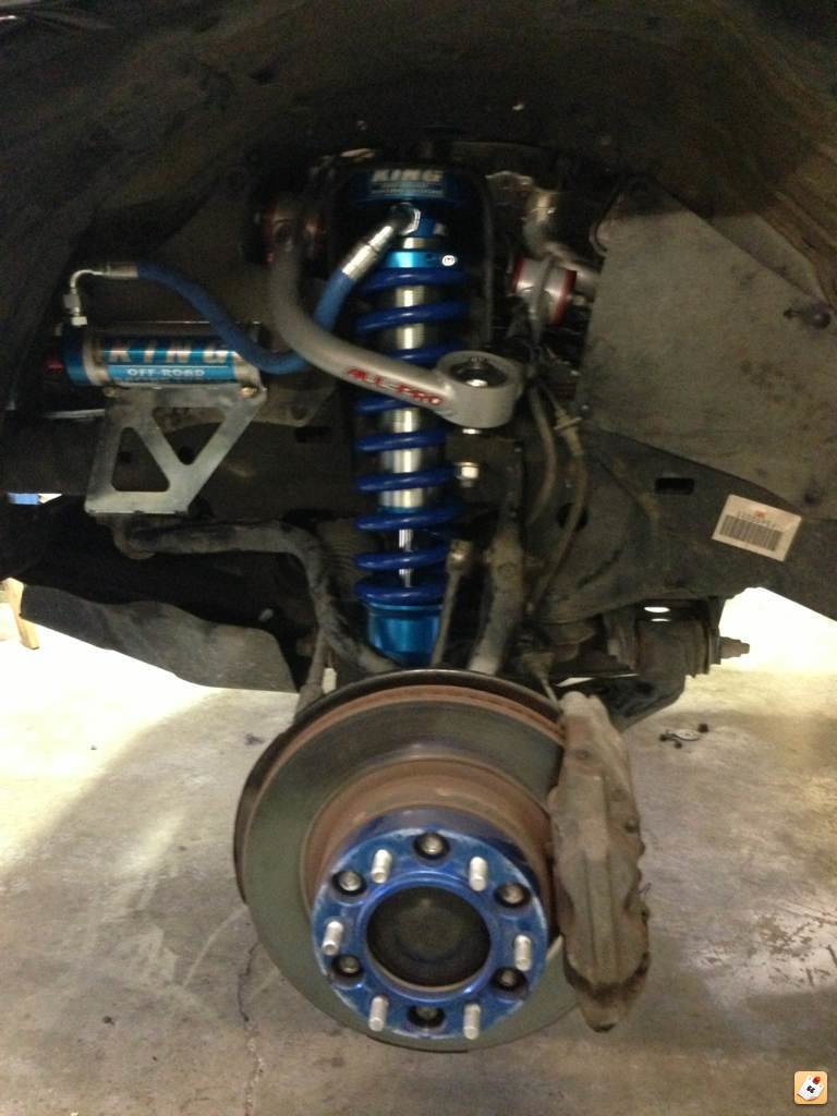

    Koi
    Reston Virginia
    10 TRD 4x4 OffRoad DC/SB
    2010 TRD OffRoad DC/SB, 285/70/17 KM2's, Mickey Thompson Classic Locks, Total Chaos UCA's King 2.5 RR Coilover 3" AllPro Leaf Pack, 2.0 Fox RR, Ubolt flip kit, MBRP dual cat back, URD TCAI and MAF Calibrator, TRD Sport Hood w/ scoop, E&G Classics Custom Stainless Grill, Color matched grill and door handles WeatherTech floor mats, FormulaOne Pinacle 15%+Air blue windshield Tint, RedLine hood struts, TRD 3rd Brake light Decal, Relentless Fab Hybrid 2 piece Sliders with Kick out Relentless Fab Aluminum Front bumper, Relentless steel rear bumper, Relentless Steel IFS B.A.M.F LCA Skids, w/ Rear Diff Skid ordered In my Spare room waiting to be installed sits, Wet Okoles, Illuminated 4x4 switch mod, SockMonkey Hawaii TRD OffRoad Decal, Big box of Rammat, Speakers and Custom Sub from Mr.Marv,
    The remote res tube points down and forward
