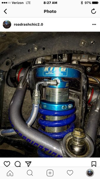

    Jk figured it out. Counter clockwise

    So I need to adjust my preload the t handle is the best way??? And it is possible to adjust with it on the truck?
  4. Sep 12, 2017 at 7:05 PM
    #44
    3pooches
    3pooches Well-Known Member
    Jul 6, 2017
    #223346
    5,487
    VA & WV
    15 tacoma dcsb Sc Linked, 2014 reg cab locked
    A spanner is the easiest way to reach around the shock to tighten the preload. I left mine on the vehicle but used spring compressors to make it easier to turn the preload adjuster.
