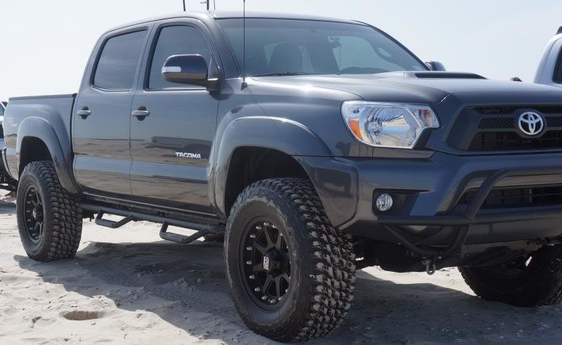

    Hey guys, Ive been around here for a while now, Just never really posted any questions, but I cant seem to find the answer to this one...
    I have a 2012 doublecab 4x4 Taco and am looking into getting Ext Travel King Coil overs and TC UCA's. I plan to max out the lift as much as I can. 3"? maybe 3.5" if It is capable (DSMS told me 2 3/4" max is all the coilovers can do on a 4x4)
    This will obviously put preload and make the ride stiffer. If I go with a 1" longer spring, will it help make a softer ride?
    Will it create any complications?
    I dont do wheel every weekend. Maybe a couple times a month on sand. I hope to jump with this set up maybe a foot or two in the air or so.
    Thanks
    Bryan
