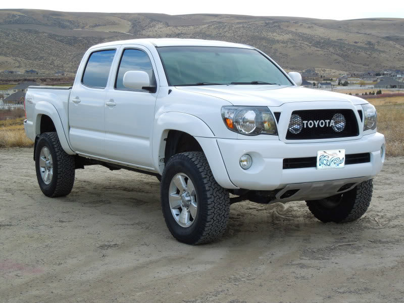

    I'm going to install kings on tuesday. I was just wondering if everything is straight bolt on? Do the brackets that hold the remote reservoirs bolt to existing holes or do I need to drill? Do I need to remove the splash shields that protect water from splashing the lower engine/pulleys?
    thanks.
    before lift
    After.....coming soon.
