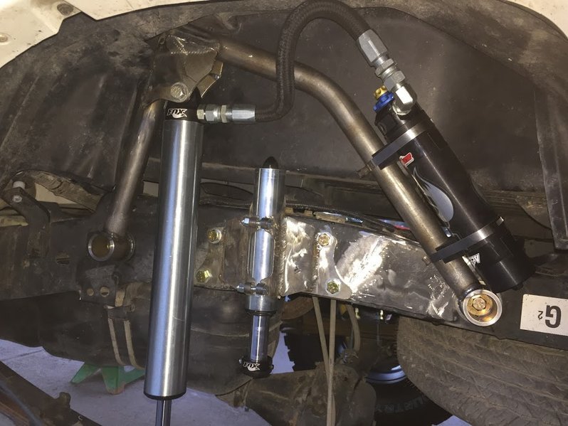

  12. Apr 21, 2017 at 8:07 AM
    paranoid56
    paranoid56 Well-Known Member
    Jul 25, 2012
    #83443
    3,441
    San Diego
    14 double cab taco
    you can also do a bolt on if you dont like welding. thats what i build.
    (work in progress, still need to paint)
  13. Apr 21, 2017 at 1:52 PM
    nudavinci64
    nudavinci64 [OP] Robert @ Holy Horsepower
    Nov 14, 2013
    #116533
    10,145
    Robert
    San Mateo/Cayucos, CA
    13 S/C TRD OffRoad 4x4
    Boosted Money Pit....
    Interesting.. That would make it a lot easier in deed.
