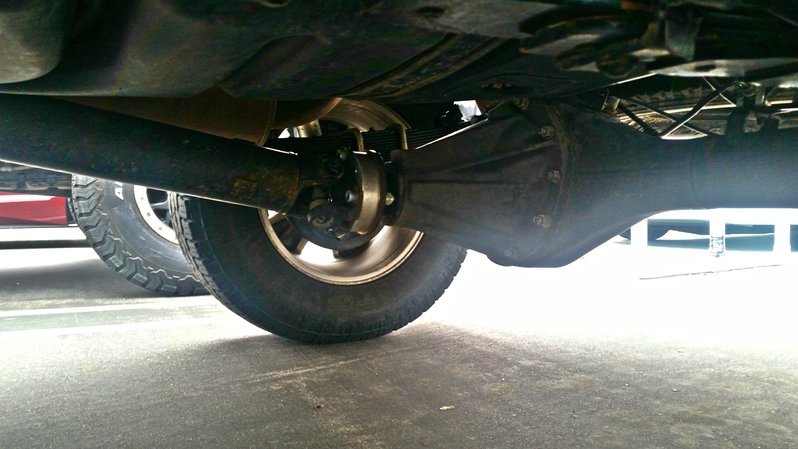

    I've got All Pro Standards with Icon remote resi 2.0's. Are you wanting a pic of the bottom shock mount or the axle showing the pinion angle? Or do you only want King installs on those leafs?

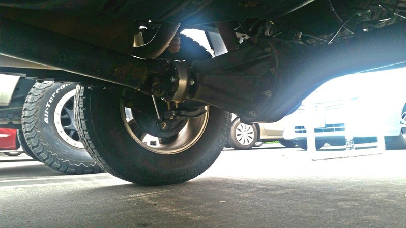

    Here's the best angle I'm able to get in dress slacks & shirt lol. That surface rust is making my OCD flare up.
    AbunaiTaco likes this.

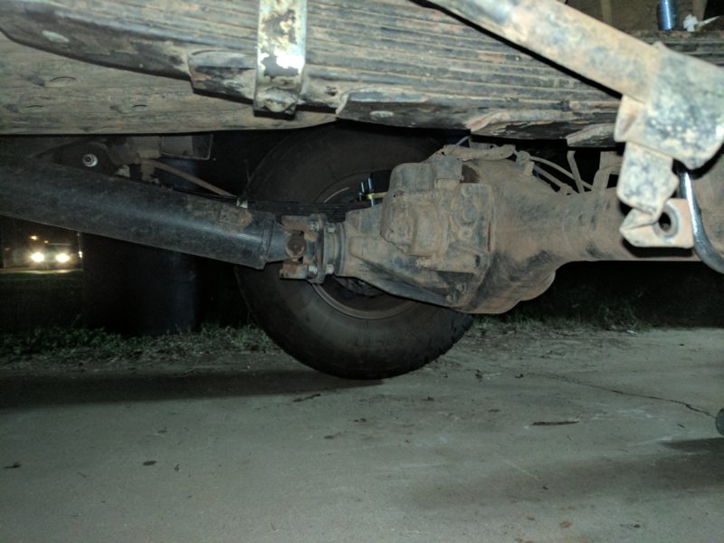

    Sorry should have been more specific. I meant a picture of the leafs and the rear housing/pinion angle to see if its any different from mine. something like this....

    Here was the best I could get without taking a tire off or waiting for the sun to not be so bright in the background lol.

    Well the angles look pretty much the same, seems like I might need to do some cutting after all. Going to contact a local fab shop to see if they can add any reinforcing to the mount.
