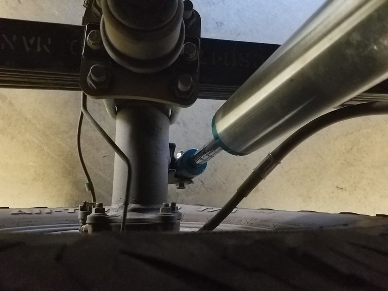

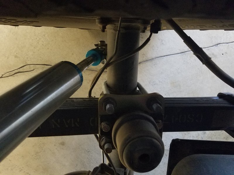

    Hey @stronghammer . Here's the pics you requested. As you can see there is plenty of clearance from shock to flip kit. Was hard to get a clear pix of clearance to leafs but it's about 1-1/2"20160716_133614.jpg 20160716_133604.jpg

    See pics above your post. It all works

    Lol I didn't even see it... Good pics though! Are those the Timbren Bumps?

    I have the timbren set up and have clearance. while close im not sure how the shock would ever move inward though as you would think being vertical is should only be going up and down and possibly outward during flex but inward would seem odd to me... any updates?

    I never posted updates about what I did! I'm sorry, I posted them on my build thread and forgot about this thread. I ended up cutting the Low Range Flip Plates to fit and haven't gotten bumps stops.
