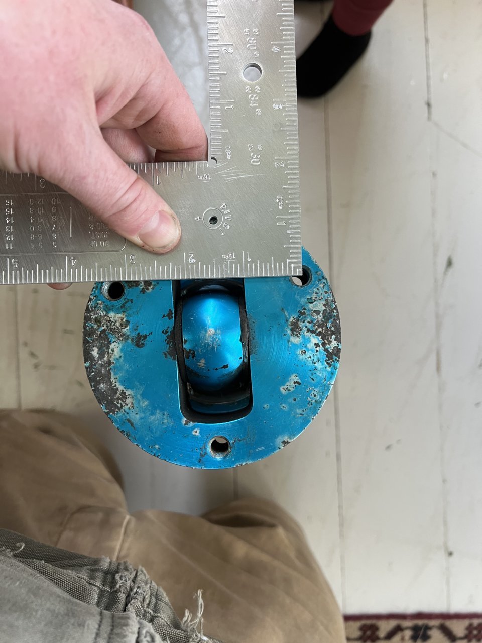

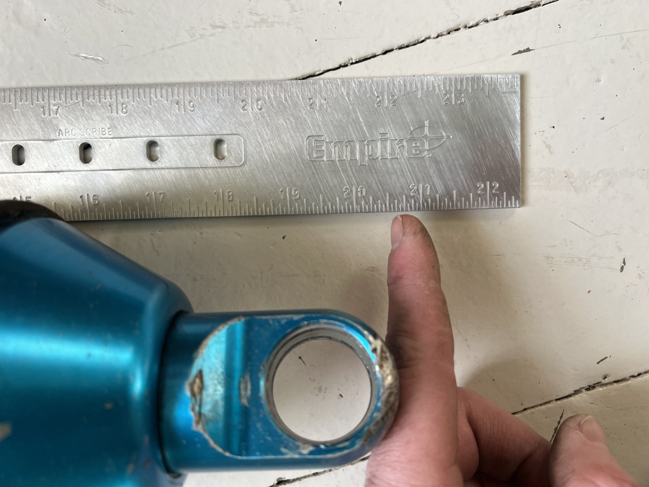

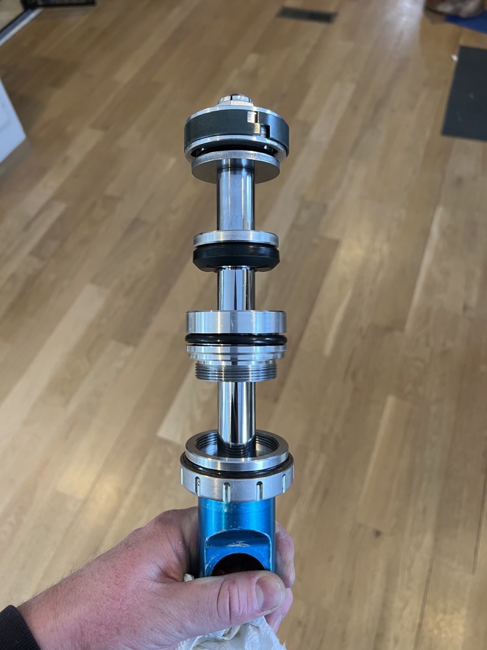

    I have one coilover torn down and this is what it looks like.
    I haven’t been able to find much info beside the thread I already linked. Is the spacer above the rubber bushing / bump stop the one to be removed? It measures 1/4”
    my other (still assembled) coilover measures just under 4 1/4” stroke if that helps identify anything.

    Yes, although I am not 100% sure what shock that is. You can always call King to confirm this info.

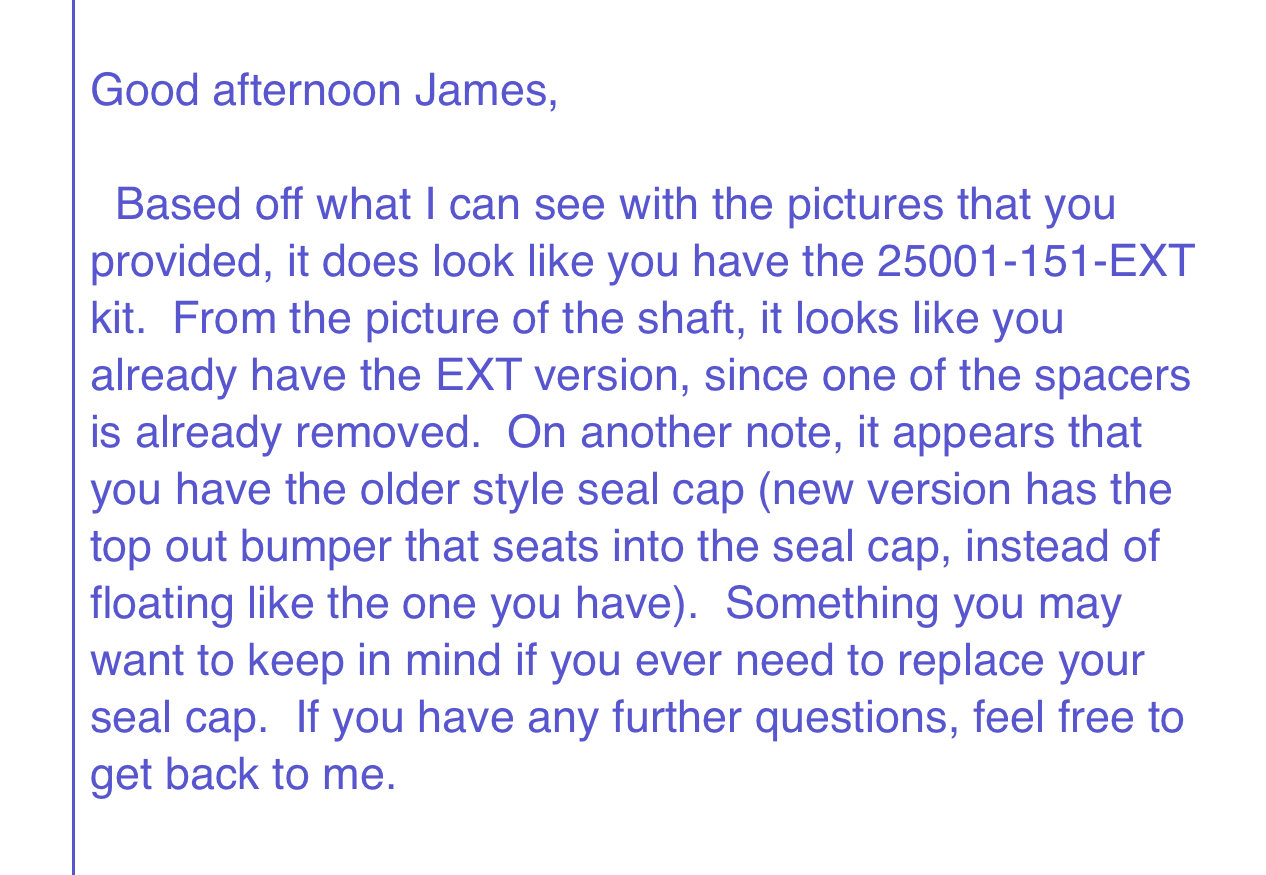

    King got back to me via email and confirmed (most likely) that these are 1st gen taco coilovers. I had sent them some pics with measurements.
    they also confirmed that these are already extended travel because there is only one internal floating spacer. I used this pic, so if you have two spaces here you have standard travel. If you have one spacer, then you have extended travel.
    He also mentioned that my seal heads are an old style and that the newer version has a built in bump stop.
