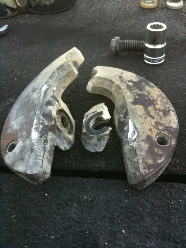

    Removing your desert bashing failed Icon's from my list of people I have seen online with issues I still have seen far more of these Icon's fail for numerous reasons. I think Lurry had cracks in both of his top hats :notsure:
    I personally (not web) know a guy who CRAWLS who broke a top hat and I personally (not web) know a guy who cracked a shaft. Yes, Icon took care of them with replacement products. That isn't the point and that wasn't the point when I researched what brand I wanted on my Tacoma almost 3 years ago. I looked for issues people had with them. My research came up with zero King issues and numerous Icon issues.
    Whens the last time someone on here saw a King 2.5 implode on a weekend warrior Tacoma????

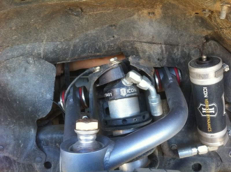

    Also, one of the pics above is from one of the employees at Icon's personal vehicle. He broke the factory mount before installing long travel and only tacked it back together.....he drives his truck hard and with not repairing it correctly it allowed the oem mount to flex and fail again and the next thing in line is the upper mount. It takes both pieces to work right with out failure.
