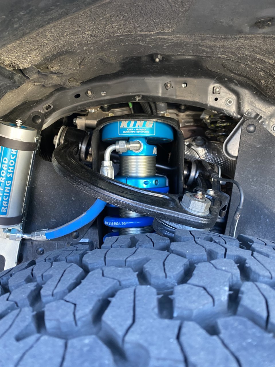

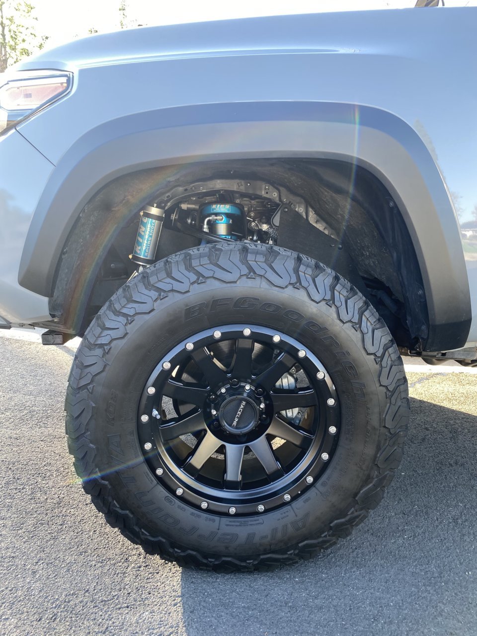

    Ok I measured from center of hub cap to bottom of fender and it’s 23 1/2”. Here are some pictures as well

    Measure from the top of the King shocks to the center of the lower shock bolt, while the truck's weight is fully on the ground. This distance should not exceed 21".

    It’s 22”

    You need to reduce preload until you're 21" or less.

    Ok I’ll try that and see. I know the ride quality will be better as well. Just did it for the leveled look. Thank you all for your help!
