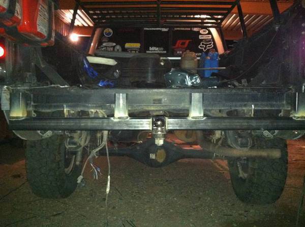

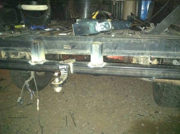

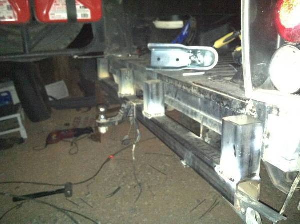

    Here you go, you impatient sumbitches :p

    ^^^ those pics should be on the next taco bell commercial followed by the words "beefy taco". Left out the cheesy part cuz we all know there's nothing cheesy about truck Norris.

    Gentlemen, this bumper inner frame is constructed of 2.5/2.5/0.250 square tubing, with 3/8 inch thick framerail brackets. The whole thing will be enclosed in 10ga steel plate, and tubed around the bedside towards the rear tire, with the bedside chopped. As of right now, it is strong as fuck.
