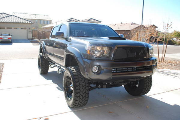

    With the negative offset, the tire will sit farther out from the truck. I have these in black on my truck and was told that they were around a -18.
    Tires probably sit out about 1.5-2" from the truck.
    Spacers would only push the wheel out even further!

    I ordered mine (Chrome) last Monday from Discount Tire. They came in yesterday, but I'll have them installed Saturday afternoon.
    They are going to swap 265/70/17's & 285/70/17's BFG AT KO's to see the best fit. I'll hop/turn on curbs in the parking lot to check for rubbing. Mine are the 17X9 w/ -12mm offset. Stock rims are 16X8 w/ -8 offset (I think).

    The difference between a -12mm & -18mm offset is just under 1/4"

    So it's more the backspacing? I wonder what my backspacing is?
