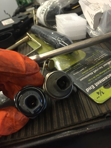

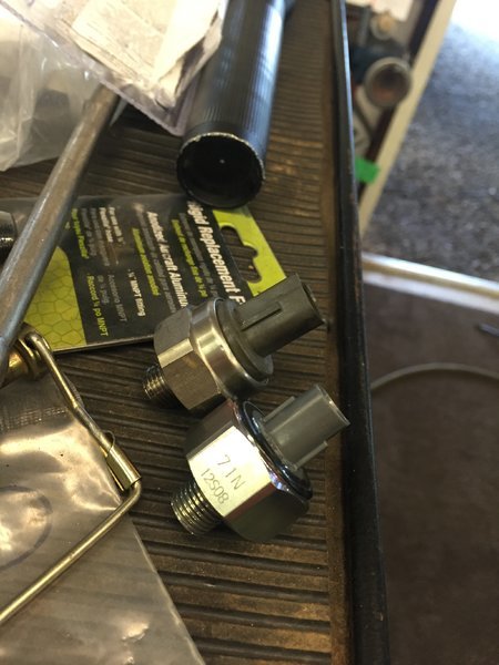

    Bought some O'Reilly brand knock sensors (Pictures below)
    OEM sensors on the left, O'Reilly's on the right
    Seeing the comparison between the 2 sensors you can see quite a difference

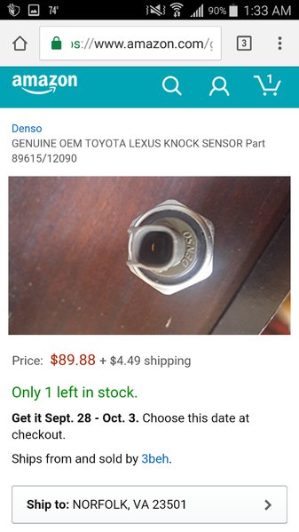

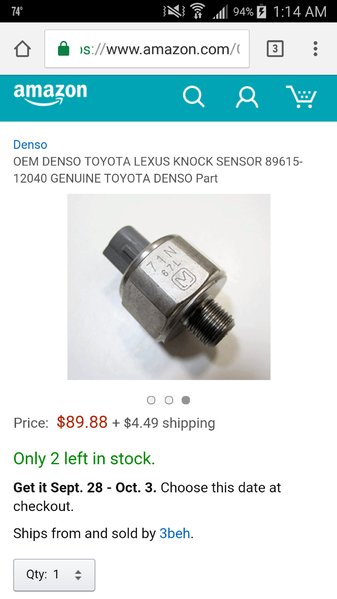

    I've read the reviews on Amazon for the Beck-Arnley knock sensors for the Tacomas and its just not good. Some people get 3 months out of them, some get 6 months, some get two years. But it's a crap shoot. I guess if you're okay with knowing in your mind you'll do the repair again within 2 years, but you will save 150 bucks, go for it. Just as long as you have realistic expectations, that's all.
    The Beck-Arnleys are 80 bucks.
