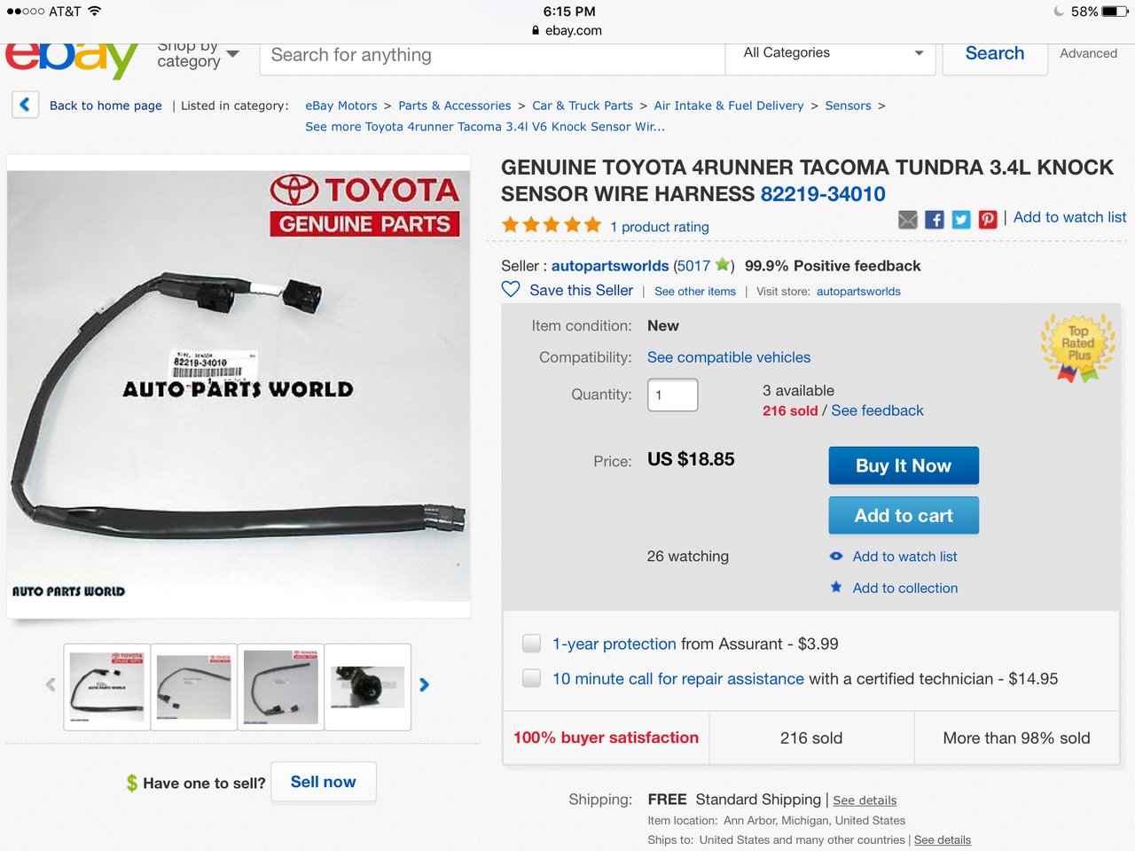

    I replaced my wire harness and still had the CEL on. When I removed the old harness, all the connections crumpled in my fingers. Dug in there the other day and checked all connections and it looked like I may have had a little to much dielectric grease on the connection. Went for a test drive and the motor seemed stronger than its felt in a long time. So I may have solved the problem. Time will tell. If it keeps coming on, Ill have to buckle down, buy factory sensors and be done with it. Even though it cuts into the budget. Ready to wheel this thing!!!

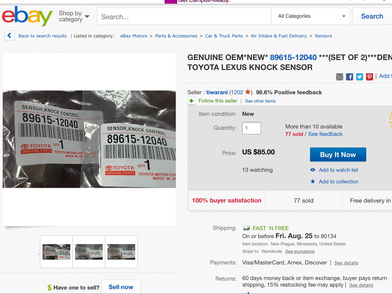

    Has anyone bought from this site? I'm wondering if they are actual Toyota parts. I called the dealership yesterday and they wanted an outrageous $245 a knock sensor.

    By the looks of the first sensor it says the company that makes it is matsushita. I wouldn't take a bet on that. Just buy from the website that's posted on the first site. Its almost the same price and that's the the usual price for the sensor.

    So I understand most issues people have with knock sensors is the connectors crumble after a while, but this the connectors that connect to the sensors themselves and not the ECU correct? So my issue is I have found that the opposite end of the connectors are not plugged in, have no connectors on them so three lead wires are just hanging and I can't find anywhere these would even plug in at. This weekend I am replacing the heads, so While I'm in the area, I figure hoping someone can help me and tell me where on the EECU harness these would plug in at.

    I bought my knock sensors off eBay for 80.00 for the pair and harness, 30,000 miles later no issues. They were marked DESNO on the sensor. So
    Just make sure they are made by DESNO and marked DESNO ON THEM,with the correct part number and sealed in the bag.
    The sealed bag had a dated stamp made less than 6 months ago from when I bought them.. As long as those are all part of the equations there's no issues.

    I got mine Set off eBay 85.00 set, over a year ago, make sure they are DESNO stamped and they have a date code on them and sealed in the bag

    yes it will get rid of the code. Do it all at once so you won't have the headache of the code showing up again.
    I'll check around ebay next time! Plus they do have that return policy.

    Quick question here everyone:
    When people say replace the wiring harness, or the wiring harness is often the issue, is that referring to the sensor harness?
    Part number 82219-34010 as referred to by OP?
    Or is that a different part entirely? Meaning I would need knock sensor, sensor harness, AND a wiring harness?

    In order to get to the knock sensors and wiring harness, they both are under the Intake so replace both
    sensors and wiring harness that in under the Intake

    Okay thanks. That's what I was thinking but wanted to confirm people were just talking about the sensor harness.
