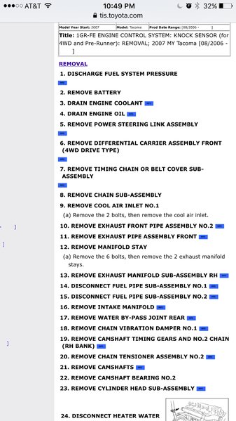

    I found this picture in another thread. Is this really the steps to get this job done?

    To replace the sensors yeah I believe so. You need to remove the heads. If its just the harness you can get by with removing the harness with some picks with just the intake off. I've never actually done the sensors. Only harnenesses due to rodents.

    Thank you. That's what I wanted to hear. Now I need to see if I can find the wires.
