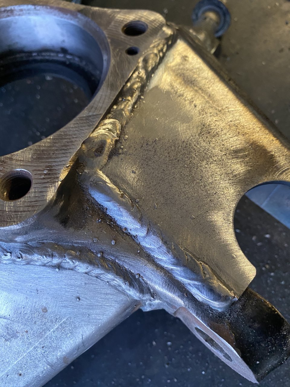

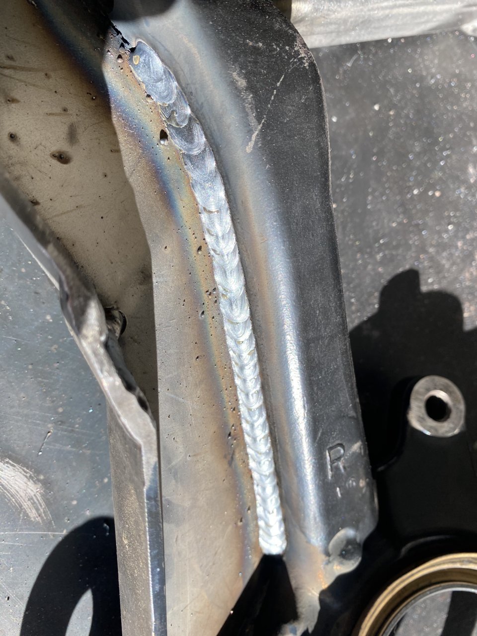

    edit: also just finished my spindle gussets and tie rod reinforcements this week. Double shear hiem joint mounting for the stock location. For $50 for the brackets or $300 ish for the kit is a pretty nice deal. I think they turned out good. Hopefully I can finish up my bump stop mounts and bypass hoops this weekend and get it back on it’s own weight.
