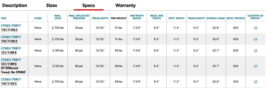

    That's a good question, I'm interested too
    Just looked it up on Tire Rack...
    The first 2 are C-load, black or white letters
    The 3rd is the E-load you'd want, not sure why the make the no-3PMS version
    the last one is the 113S version the OP is asking about...

    I definitely want C load, just don't know which version to get. The thing is, the "S" version, which only has a difference in 12mph, and max PSI of 60 (rather than 50) is 7 pounds more which is the same as E! I'm guessing most buy the 116/113Q on here? The lady from BFG said they discontinued the S version.

    From what I know the "DT" tread is a harder rubber compound that will last longer. Of course that means its not as good in bad weather

    yeah you're gonna want the 116/113Q version to get C-load ....only other decision is black or white letters

    One is an OEM tire. The other is a replacement tire. I'm guessing the S was the OEM. The manufacturer probably specified a 60psi inflation requirement and that is what they made. I would imagine they achieved that from an extra ply. Pretty much exactly what the do to get to the E load range. My plies = more weight and higher max air pressure. Looking at those tires you see they are the same weight. So you would be getting a E load range tire that they label as a C. Silly when you think about it.

    They make the no-3PMS version because the KO2 doesnt do well on gravel roads durability wise (cut and chip). They had to give up traction for durability.

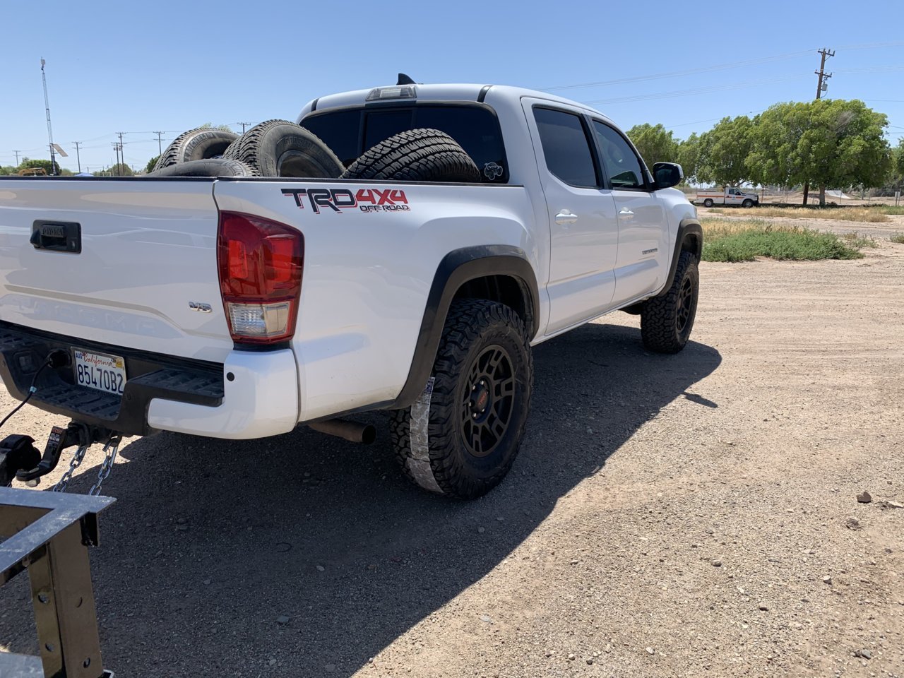

    Tires were delivered and Verified the S version is in fact 58 lbs for anyone in the future
