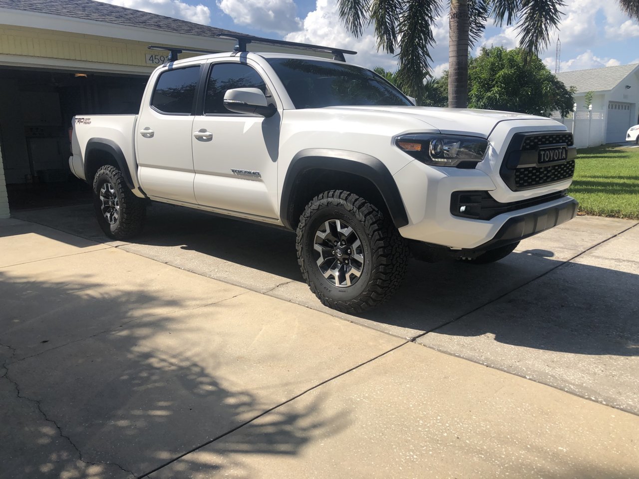

    I had 265/75/16 KO2s installed on my factory off road wheels today. Obviously E rated as that’s all that’s offered by BFG in that size. I’m getting bad vibrations in the truck above 70mph, but smooth as can be expected from an LT under that.
    On my 4Runner I ran multiple sets of D rated KOs (not KO2) for years. It wasn’t unusual for those to not balance correctly the first time, but vibrations were always around 55mph, not 75.
    My Tacoma with factory tires had some vibration around 80 but not bad. If vibration was around 55 I would have turned around and gone back to the shop for a rebalance, but since Im getting vibration at higher speeds than I was expecting for a balance issue I am wondering if this is balance or just the heavier stiffer tires causing this vibration and it’s what to be expected with E rated tires.
    Anyone have any insight? Anyone with E rated tires see this or get vibrations due to a balance issue? I don’t want to go back and ask for a rebalance if this is normal with Es on a Tacoma.
    FWIW pressure is currently set at 36psi.
