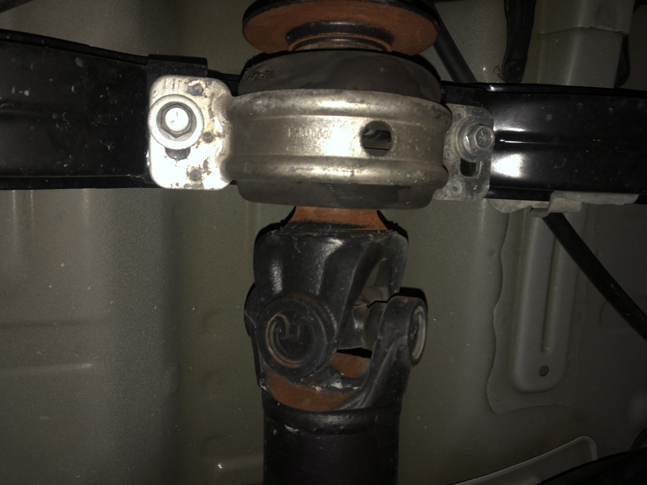

  14. Sep 11, 2019 at 9:56 AM
    #34

    Raise the wheel off the ground and try to shake the wheel by pressing on opposite sides (3 and 9 o'clock). It will be obvious if its the bearings. Mine moved about an inch both directions on each side.... But my bearing was pretty much destroyed so.....

    Since the vibes stayed in the rear after rotating the tires, I would suspect it could be a driveline issue. Check that carrier bearing and all U-joints.

    Looks like my carrier bearing may be out of alignment, everything else seems right.
    Out by 1cm or so cause a problem? Or does everyone’s look like this?

    Do you grease your u-joints?
    Looks kind of dry and there's no grease slung up on the underbody.

    I’m 2wd, no grease zerks.
    I’ve put a few more miles on the tires today and vibrations seem to be smoothing out possibly or I’m getting used to them. I straightened out the carrier bearing, I could see the marks from where the bolt slipped, but from doing some reading, it doesn’t look like that should make much difference. Bumped pressure back up to 35psi. I’m going to go in next week and have the balance check with a place that has a road force balancer, I’m also thinking I’ll get the alignment checked since my factory tires were basically done at just 21,500 miles.
